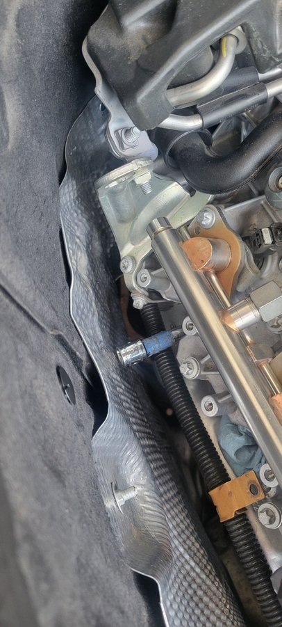

OMG, after inserting the spak plug, the socket got stuck inside. Tried to insert the extension but it wont snap back on because cannot see it. Tried to take picture, see it there but unable the snap the extension back on. whatever a disaster!

Any tips for #7 & 8? No room to work on.
Theres plenty of room is you use the proper extensions and swivel sockets….
Old Mar 19, 2026 | 09:41 AM

So i used this socket & entension. I managed to insert ỉn but it wouldnt snap on the plug. And now its stuck, i cant take it out. Can i spray by the connected join to lubricate? I am trying to seperate the 2 pieces and take out one by one.

BDC90's Avatar
Joined: May 2023
Posts: 459
Likes: 164
From: Endless Mtns. PA
2014 E63 AMG wagon 1965 Austin-Healey 3000 1970 AMC AMX
Yep, gotta use a swivel top socket. Might need to mangle that heat shield to get that loose.

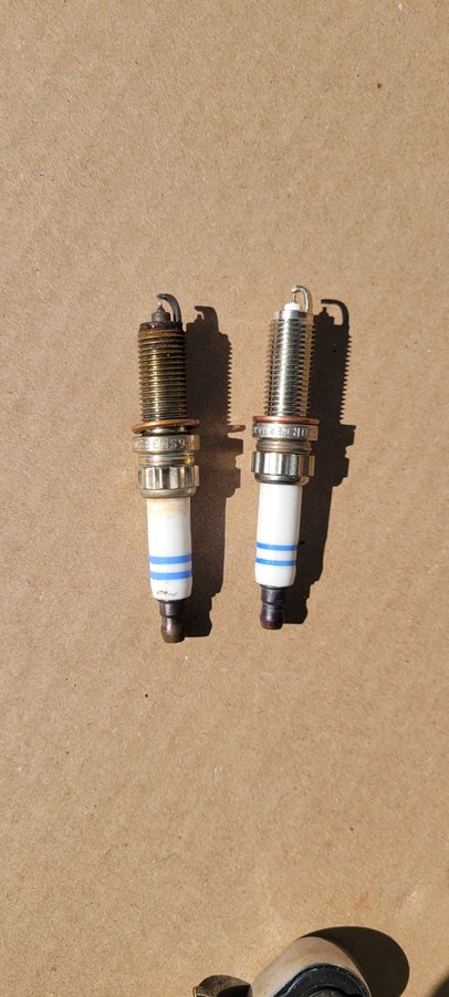

Got it done, finally. Its the tough job. I warmed the engineb up a lttle bit so there was no problem to pull out the coils. I see oil on the old plugs, do i need to worry about this?
boroscope the cylinder, figure out if oil is from intake, or stuck rings….imo, a proline engine flush at each oil change will help start to clean it up. Do you have any smoke on start up or under light or heavy acceleration?
Add a pic of the plugs for us to see.
I just checked the plugs again, only one is a litlle wet. I just don't remember what cylinder. Too much work to remove every single one to boroscope. I don't see any leak from valve cover. Will do the liquid moly pro-line engine flush now. Thank you for your help.
little smoke when startup but its been like that since the đây i bought the car.
just use it according to the directions. I’ve used it for my past couple oil changes/flushes and still get some debris. I had two wet cylinders. There should be zero smoke on start up and zero smoke under your first heavy acceleration of the day. Smoke on first start up often points to a valve seal. Smoke with first wide open throttle often points to blow by. .
generally, the cylinders to worry about are the ones closest to the turbos. However, that was not where my stuck rings were.
this is after 5k miles since I inspected and saw my two wet cylinders. I did an engine flush at that point, had my valves cleaned, changed my oil twice and then flushed again a week and a half ago. Looking in my oil cap has always been spotless. The assumption is that this debris is coming from perhaps the valve train, or more realistically the rings being slowly cleaned. If you read my story, I always do 3000 mile oil changes, but I was using lots of Ceratec and I think that contributed to my problem. I’ve not used ceratec since. This is the most debris I’ve ever seen in my filter.
