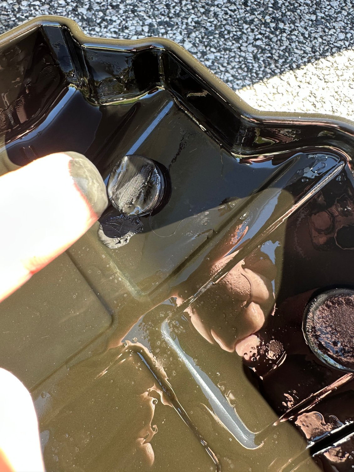

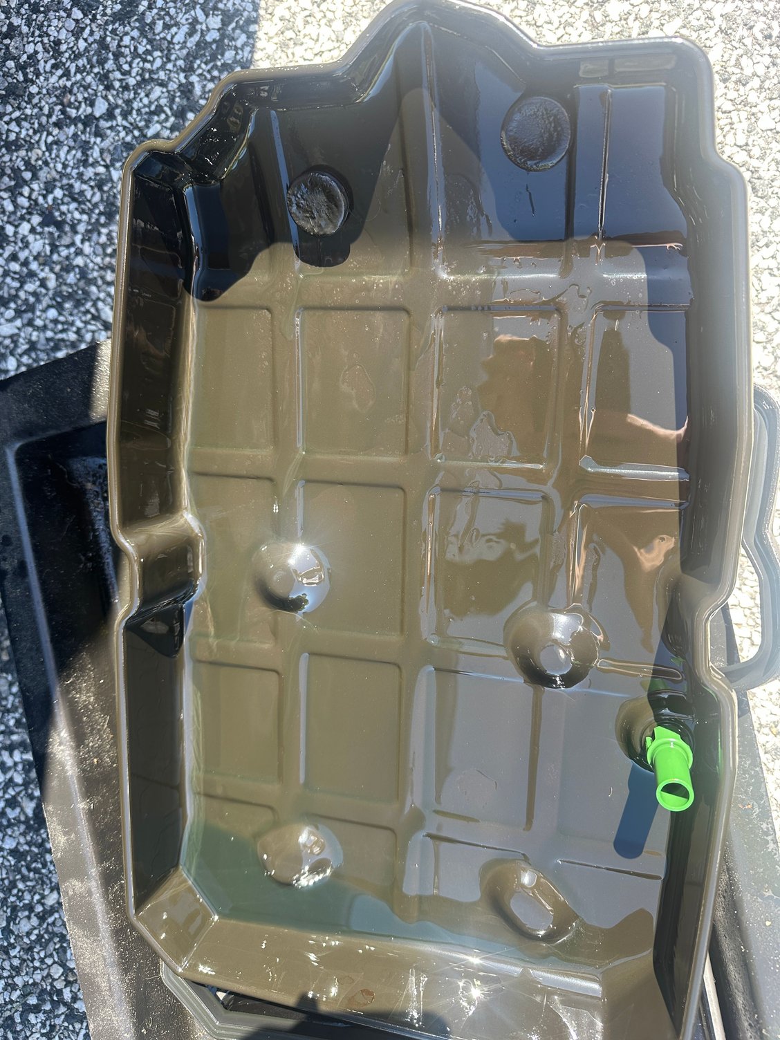

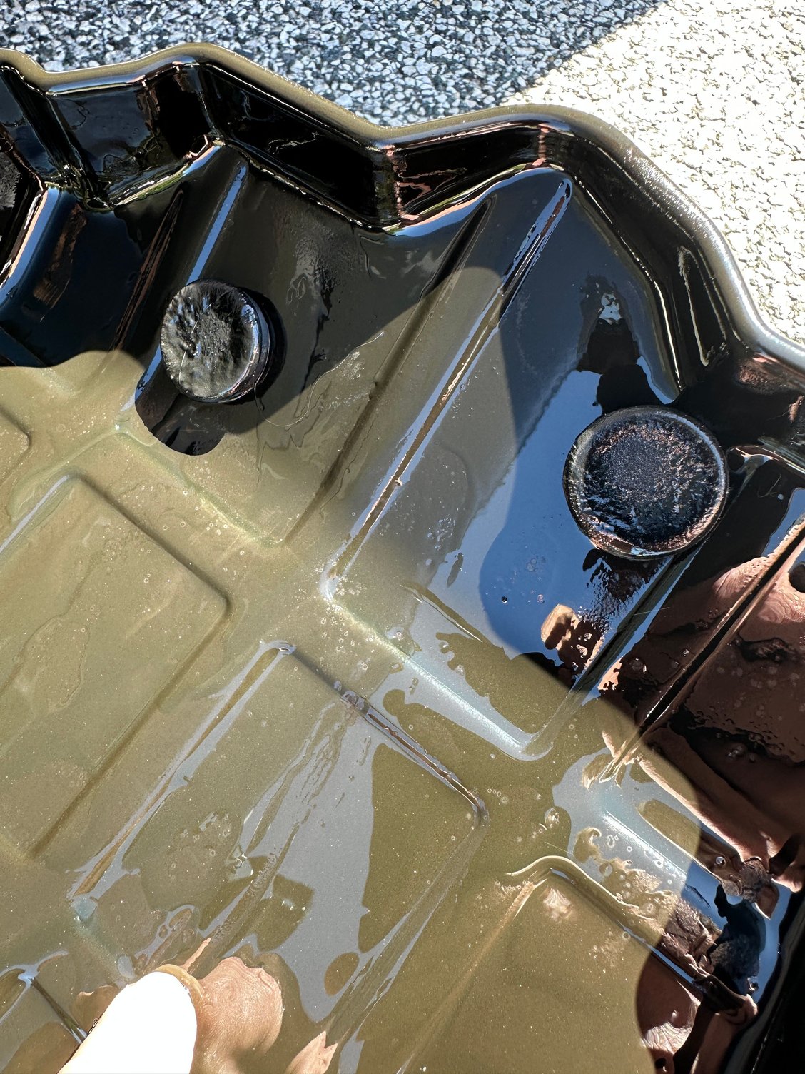

I also did a transmission remove and replace of the fluid two times this weekend. It had been about five years and 20 to 25,000 miles since it had been done, last at the dealer. I’ve been having a little bit of hesitation at low speeds so figured it would be a good time to check up on the transmission. The hardest part of the whole process is getting the car level on jackstands and removing the under body panel. There’s plenty of videos out there on how to do this so I won’t go through that but here are some pics. I’ll report back after driving through the week, but the initial drive felt immediately smoother.

Overall the guide was dirty but still had a blue hue
Overall the fluid was dirty but still had a blue hue
Not much debris on the pan, no sparkles

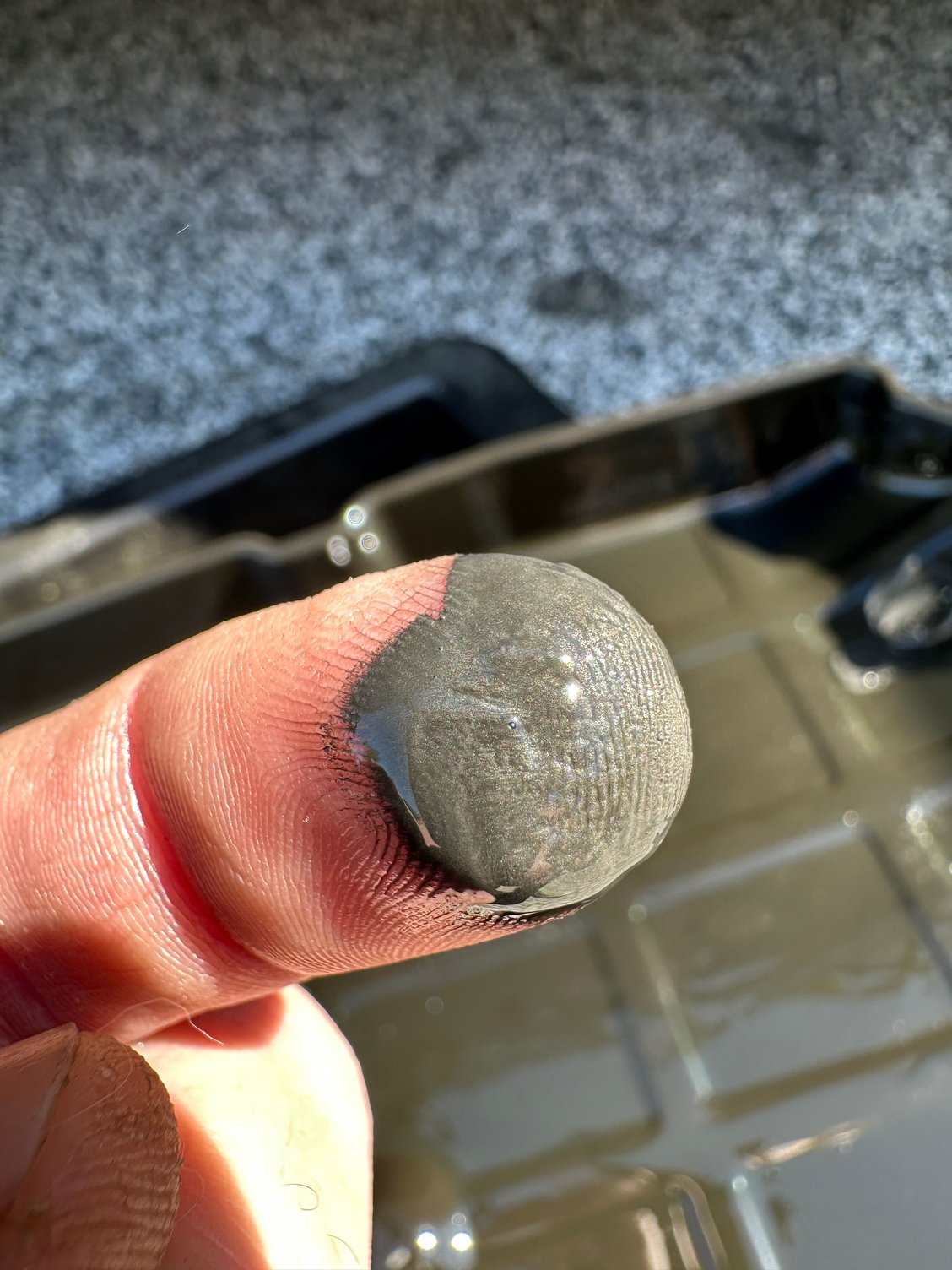

Magnet captured the fines. Very silt like and no size to any of the captured material.
