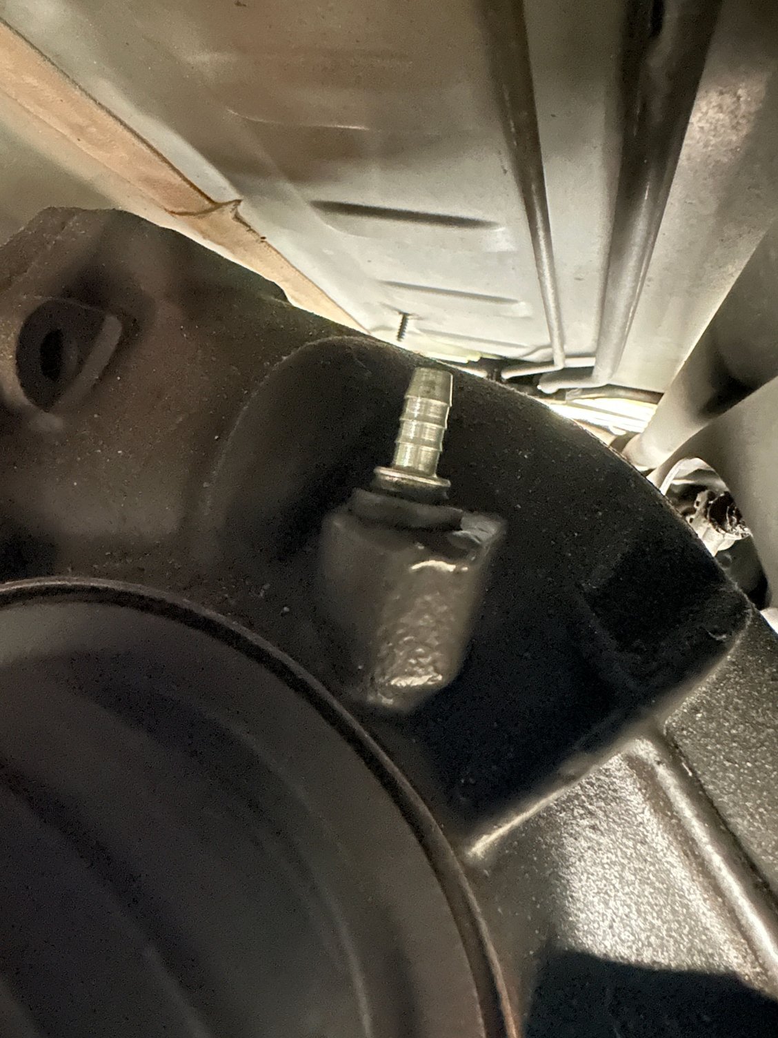

For this vehicle, the valve just pops off the barbed fitting.
rwd wagon location on passenger side top.
Stick something in here to make sure this bar fitting is clean, especially if oil has been cooking in there. It means water has also likely gotten in. So change the fluid jig you’re unsure of quality.
