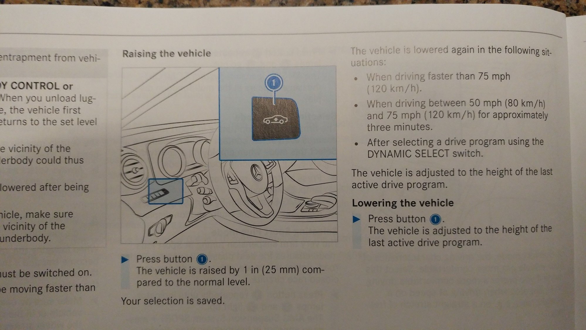

The raise function of the E63s works a bit different that I am used to. Normally on MB's, there is an indicator light on the button wether the car is raised or not. Press once, raise, press again, lower to prior height ( there used to be an 2 step raise in the old days but the functionality was the same).
On this car the button only raises but doesn't lower. It appears that you can lower the car by selecting a different drive mode only.

If I'm understanding you correctly, you may want to check that again....pretty sure if you hit the raise button, raise the car, then hit it again, it will go lower back to prior ride height.

I just tested mine in the garage:
in park, I push the raise button and a green car icon appears with an up arrow (Left screen at the bottom right). The car lifts up and it takes a long **** time vs the lifters in my GT3 and Huracan but we all knew this. But while the car is on, I then depress the button again and the green car icon goes away BUT the car doesnt go down unless I drive it or turn off the engine.

Ah, well that's a good thorough test man! My only ref point was driving right after, as I do use the raise function a lot while entering/exiting places and it would lower for me....guess you gotta drive it to lower again, as you mentioned..

The only way to see the ride height (besides stepping outside the car) is on the vehicle data screen in comand. It'll show on 1 when raised. When you raise the car while on or driving, the ride height will not go down no matter if the button is pressed again as stated. It'll lower itself at speed I guess but to get it down to 0 or -1 you have to flip to sport, sport plus etc.
Just different what I expected.

Odd. When i hit the button, on the left part of the left screen, it says 'vehicle raising'. if i hit it again, it says 'vehicle lowering'. Excerpt from AMG supp to owner's manual.

This turns out to be one of those Launch Edition differences.
So I tested this again yesterday and in fact the car does lower itself over time. There is no message like "vehicle lowering" at all. This car only has the "Vehicle raising" message and the indicator icon on the instrument cluster.
Since the only way to see the actual ride height is on the vehicle data screen in Comand. I looked there again and the car does lower itself but at such a glacial pace that I didn't even see it move for a while. Our SL with ABC drops in less than a second.

I don’t get the vehicle lowering message either and use this a lot going in and out of driveways and at garage.
it does take forever to lower the car however mine seems to raise fairly quickly. About the same as the GT3.
mine isn’t a launch edition

Where is this button? Can’t find it

To the left of the steering wheel on the dashboard is a row of buttons. It's to the right if memory serves...
