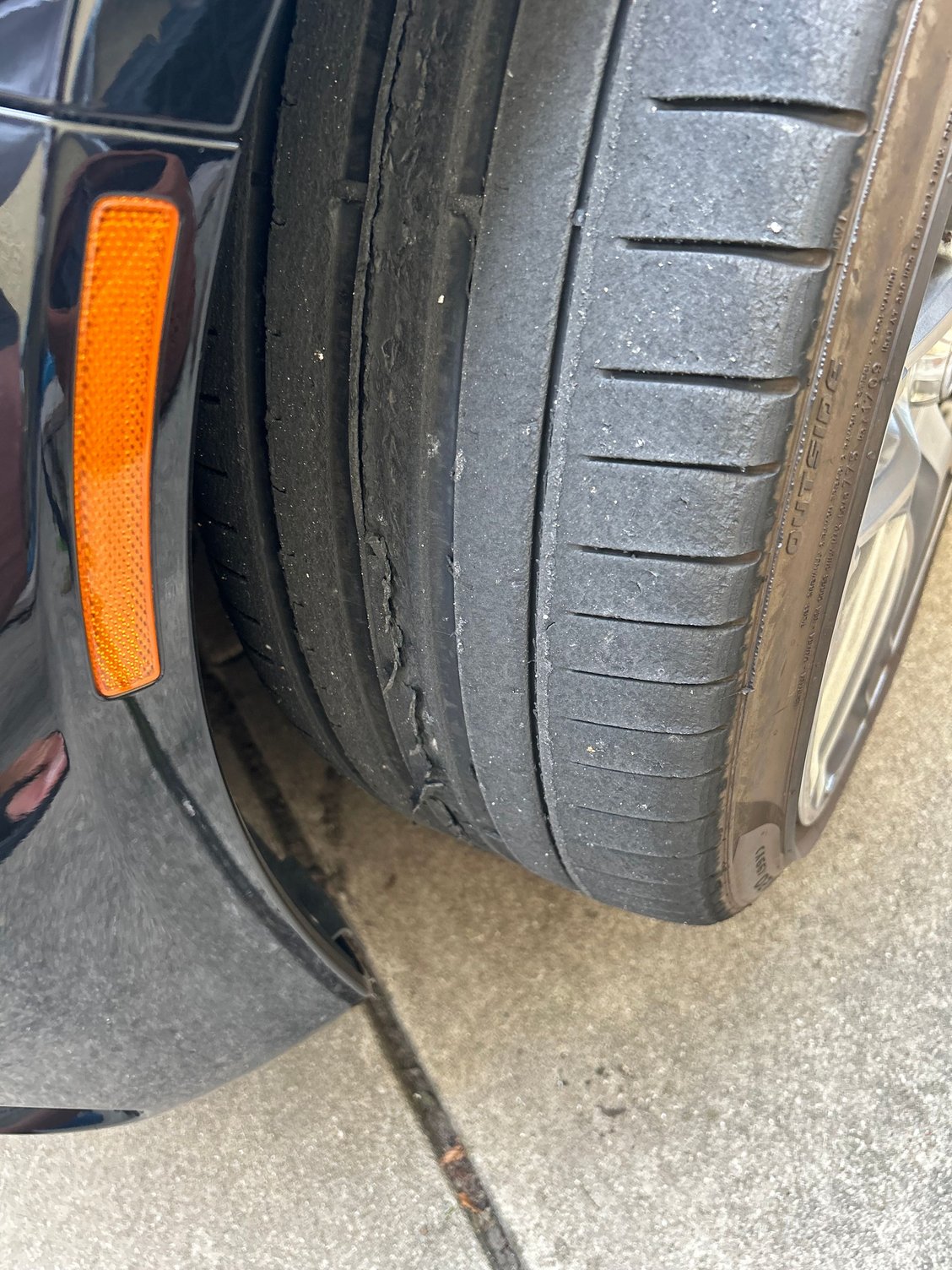

I spend my days contemplating whether its Continental or Michelin. A/S or summers. My last experience with Michelin looked like this when I pulled them out for spring, they were done but I'd hoped to get a bit out of them. All four did this and the subsequent winters and summers have worn properly on a Jaguar XFR. I recognize any rational person would say there's a camber or suspension problem but there was a long list of people on Jag Forums suffering from this failure. To be clear, there were no threads when I put them away, they just sort of came apart in storage.

Those look to have been over inflated slightly when in use, but I don't see anything I would consider caused by suspension problems.

Agreed, it looks like an over inflation wear pattern. I also see what looks like excessive toe which wore the inboard shoulder down (where you can see the cords).

IDK. If it had excessive toe wouldn't the tread near the shoulder be worn more?. From my dumb high school days damage like that would come from the tire hitting the fender.

It does look like that on the pic, but relative to the wear bars it was wearing square.

Factory ride height, no spacers, stock size on the car. Never a fender touched.
It just seems impossible to me that the shoulder should look like that when the wear is reasonably even otherwise. In researching tires at the time I found that a lot of companies were introducing a shoulder reinforcement to stop the separation.

Most likely, yes. And possibly some sawtooth-like tread wear on that shoulder. I'm just guessing with little data to go off of. From looking at the tire, the camber looks good, so it only leaves toe or caster. Normal wear should probably not be as thin as it looks in that shoulder area in the pic so much that the cords emerged, but the tread itself did not. Who knows.
You make a good point, I've lost a couple of tires in the past that had a groove cut in them on the inboard shoulder from rubbing on a suspension part, but only when the suspension was compressed. Took me a while to figure that one out. But that was on a custom/wider wheel and tire setup.

Limited reading on XFR says toe only in rear. I would add that it's not impossi le that rear bushing wear didn't contribute...but the wear doesn't add up.
