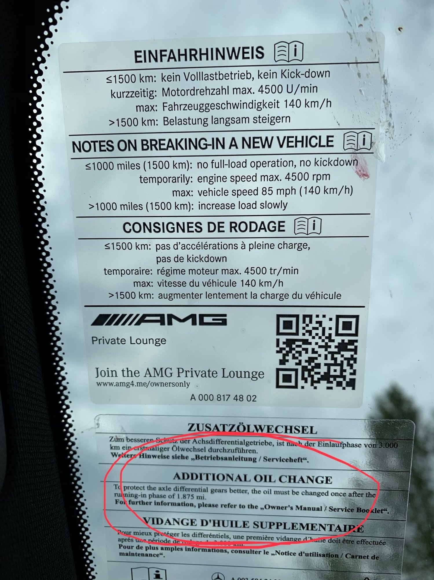

Very simple: take a look at your windshield sticker and answer is right there. Below is the windshield sticker example from E63s that needs oil change.

Originally Posted by 6G Schnell
This has been covered already, please see at
https://mbworld.org/forums/w213-amg/...er-needed.html
There is no need to go up the chain to the CEO level to find the answer.
Thanks very much for the pic and the link. I remember taking such a sticker off the windshield of my 2019 E53 but I tossed it, having seen breaking in instructions in the owners manual. It could have had the "additional oil change" wording but I don't remember seeing it. I've asked my salesman what the E53's on their lot show. It's very possible that the oil change is only supposed to apply to E63's but it would have been easy to say that in the owners manual, as it distinguishes between E53's and E63's all the way through. Very confusing.

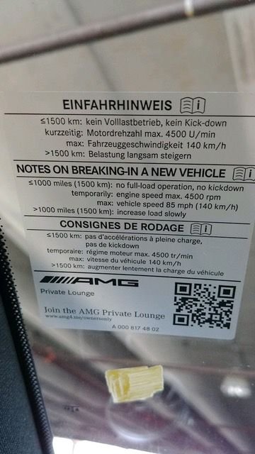

My salesman sent me the attached pic of the windshield sticker for a CLS53. No mention of a differential oil change. I think this finally ends the controversy.

No kickdown? Sh**!! I have been religiously following all directions for break-in (it is soooooo hard). I have mildly kicked it down a few times on the freeway to pass someone, nothing radical - not flooring it or anything.
Surely that shouldn't be a problem.
Should it?
Should it?
Nope.
Just drive it like its stolen - others have done this and posted....
