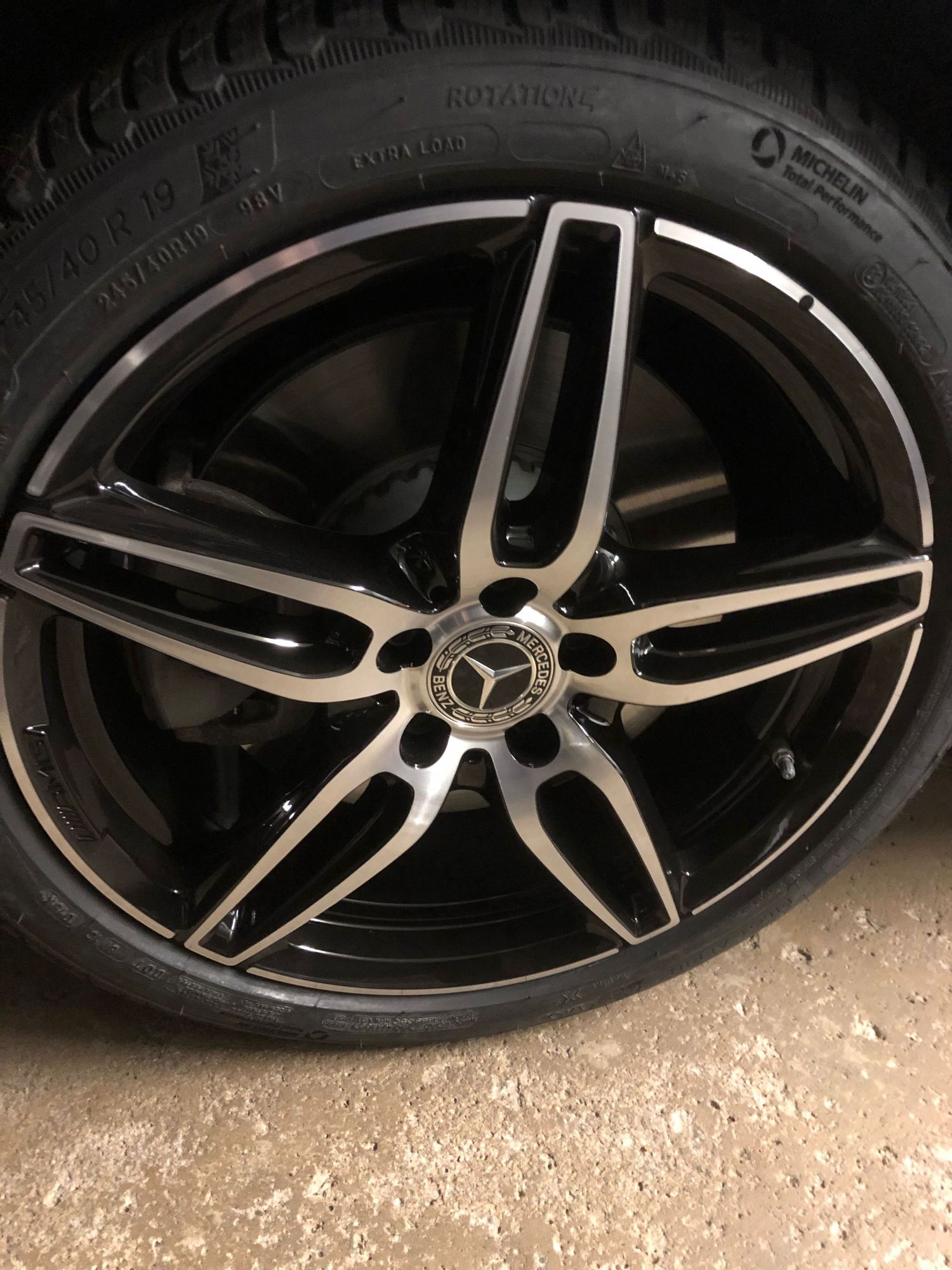

Yes. I've been waiting until it's all settled but here's an update. I contacted the Chicago area's distributor for RTX wheels (various Discount Tire stores) and gave them the number of the wheels I wanted (Envy 19 x 8.5 with 21 offset front and 40 rear, for 245/40/19 tires all around). He contacted his distributor for RTX, or maybe RTX directly, and was told they would not fit my car. He was told by his wheel source that the only solution to fit my car was a 20" solution, something about Mandrus, I didn't listen too carefully because I didn't want 20" wheels. I'm pretty sure they're wrong about Envy not fitting, but he wasn't inclined to argue with his sources.
So then I went back to the MBUSA packages - package BQ8402564 for the front (AMG wheels with 20 offset) and BQ8409054 (same AMG wheel with 43 offset), for a square 245/40/19 setup. Tnis is the Canadian package, except the Canadian package has Pirelli Sottozero 3 winter tires and the MBUSA packages have Michelin PA5. I found a cooperative Mercedes dealer parts guy in the area who seemed pretty diligent about finding out about what's in the packages. After a day he called and said that Mercedes has no front packages left (the BQ8402564 mentioned above, which is recommended for the E43) and they're not making any more this season. But winter hasn't even started, I said. He said that they only make so many because they took a bath on having a lot of packages left over after a recent mild winter and they don't want to be stuck again. They did have the other package. Tired of all the screwing around, I said buy the one package and make me the other package from parts. It looks like putting together the front package will cost about 760 extra (380 each) over the package price. He quoted me a hard price of 2,550 to duplicate the front wheel packages from parts, and that includes sales tax and the TPMS sensors. At least I will have AMG wheels and a fit with absolutely no issues. I just hope it all works out, since it's still a work in progress.
Expensive? Oh God, yeah! So I'm hoping for a record-breaking snowy winter for Chicago to justify the cost. And at my age, this will probably be my last nice car - I kept my 2001 E55 for 18 years, and I'm 71 now, You can't take it with you!

Today I got my winter wheels and tires installed. It's what I've been calling the Canadian solution: AMG 5 twin spoke high sheen with black accents wheels all around, fronts are 8J x 19 ET20 and the rears are 8J x 19 ET43. The tires are Michelin Pilot Alpin 5's 245/40 x 19 all around. The rear wheels and tires were offered by Mercedes as a "winter package" and you get a break on price that way - they cost 775 USD each. Unfortunately, Mercedes had sold out of the front winter packages so my dealer duplicated the packages from parts - more expensive, each cost 1,180 USD. Mounting and balancing the two fronts and installing all four added another 118.80 USD. The grand total was 4,028.80 USD, excluding sales tax. With that much invested, I'm hoping for LOTS of snow this season.
I had spoken to three Mercedes dealers about this issue. The only dealer who went out of their way to help was Mercedes Benz of St. Charles (Illinois). I recommend their parts department very highly.
Thanks to all who responded to this thread, especially bobblehead!

Yay ... The search is really over !! Hope you did not end up with more grey hairs from this fiasco.
Sometimes I wonder why mb Amg wheels come in such weird offsets to begin with. There are obviously aftermarket wheels that will work but if one is to go for the closest match offset to oem, it’s like climbing Mt Everest 😄
