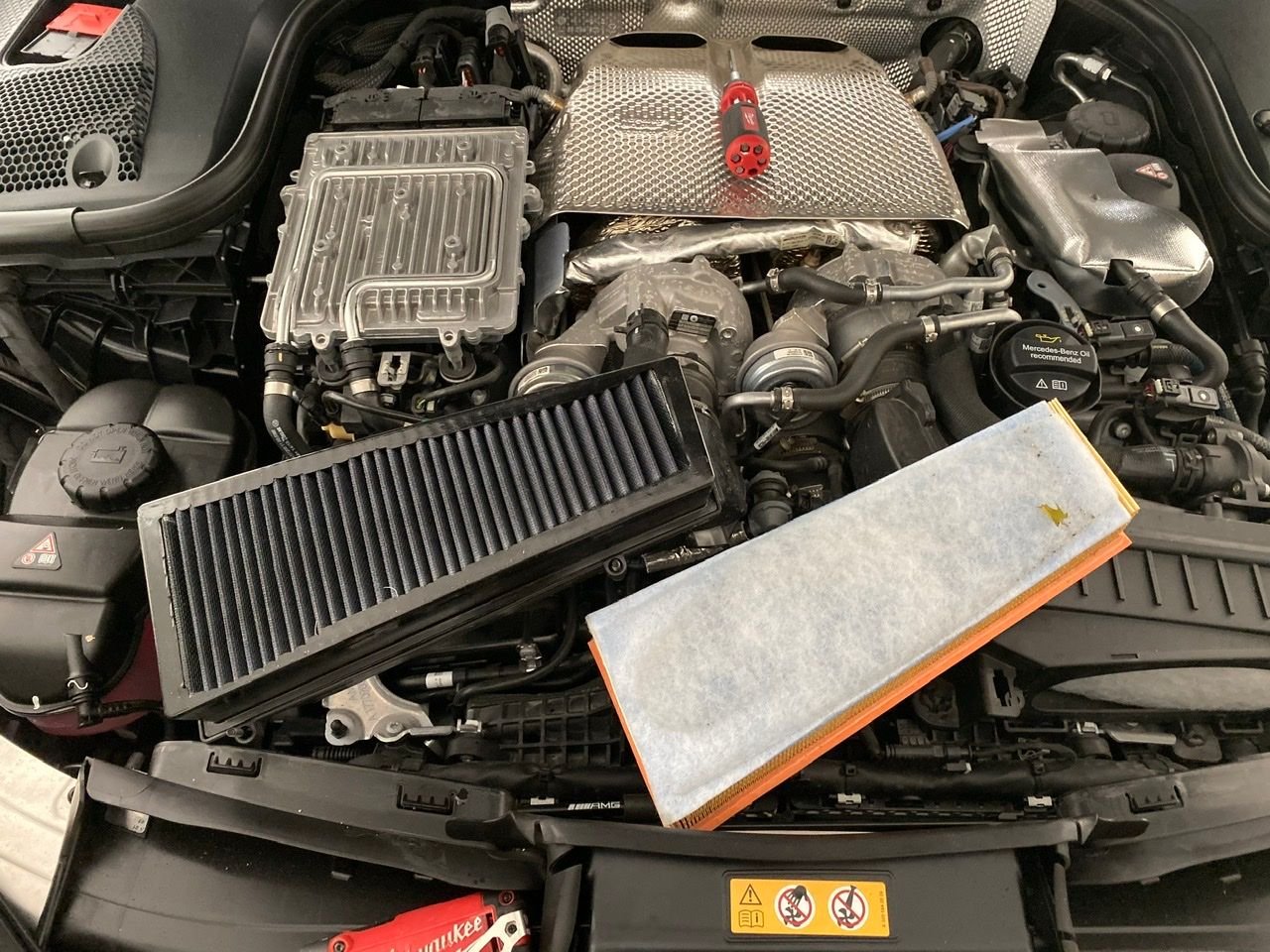

Mercedes OEM! have had BMC for over a year cleaned them once re oiled been back in without any dramas! But my car isn't stock hence the BMC! cant see very well in picture the sound muffling part of the OEM filter has been blown apart
