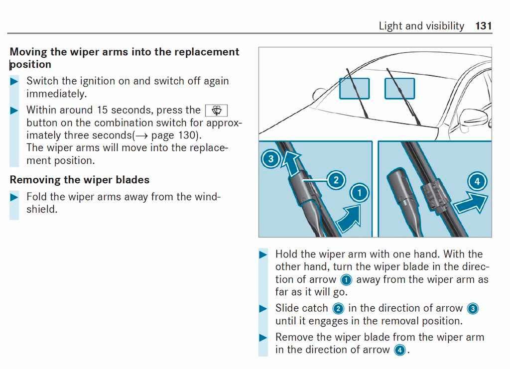

They can’t be lifted off the glass in their resting position. That’s it, not much of a thread here, but I just found this out for myself and needed to warn prospective owners.

True, would scratch the hood if trying, but there is a simple (yet not intuitive) way to get them in position where they can be lifted off the glass.
Please se attached.

I was joking about the warning prospective buyers, but good point someone out there will try to force the issue and end up with a mess of some kind.
thanks for the rtfm upload, helpful info

Glad to help!
Just realized pdf upload got rotated.
Below is more readable version.

These instructions are useful, but what they don't say is that the car needs to be "off" (i.e. instrument dark, etc.) before pressing the washer button. If you don't wait for the car to be off, the washer goes on and the blades do not go to the service position. I found the easiest and quickest way to get the car to go off is to simply open the driver's door.
