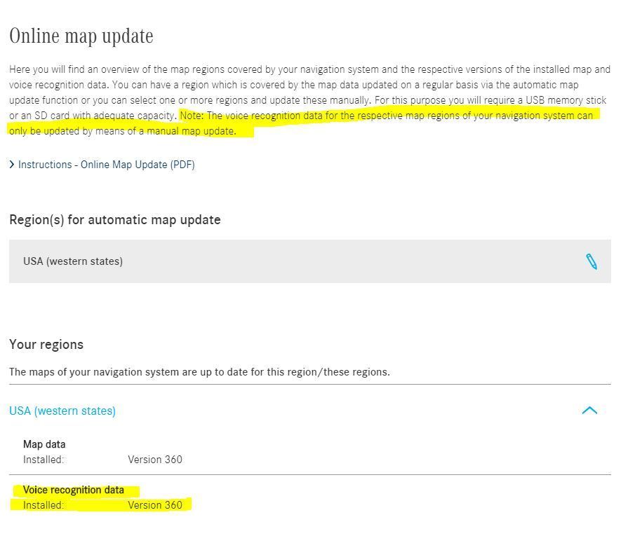

Best advise I can give is to speak naturally and not emphasize the words and as mentioned above, don't turn your head and speak away from the mic. You don't have to directly speak towards the ceiling, but it works best from the driver's seat and if you speak looking forward. Many times I observe people change the way they speak if they are talking to a machine. That's actually more counterproductive than anything. You do need to pronounce the words clearly and don't slur them into each other, but keep speaking naturally. These systems are trained to understand normal speaking. Don't talk to it like it's a child, or start to emphasize certain parts if it doesn't understand you the first time. That just makes it worse. Also, while it does reduce fan speed while talking, do not aim your center vents upwards. That potentially creates wind noise blowing by the mic. I made this mistake many years ago in one of my earlier voice enabled cars. It wouldn't understand a single word, until I realized it basically couldn't hear me because of the center vents blowing air at the mic.
And as I mentioned above, make sure you have the latest voice recognition data updates installed.

Appreciate everyone's input. The 2019 E63 does not have individualization that I can see either. Will try the maps update, good idea.
I've tried speaking slowly and regular. It's so bad that if I say, navigate to 800 N. Jones Street, Dallas it will ask me which Jazz song I want to listen to. Seriously it's so far off that it's comical. Dealer says nothing to do.
I picked car up in Germany with the european delivery program and I swear the Kraut who demo'd my car it recognized everything he said. Doesn't work for my wife either. Bizarre.
