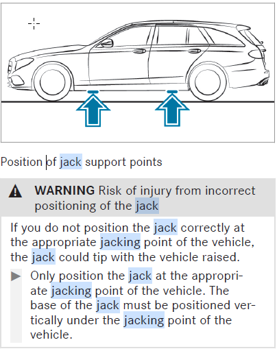

Thank you, I found those jacking points! but is there a 3rd jacking point in the rear? Ex: So you could lift up the rear with a floor jack and place 2 jack stands on the jack mounting pads in front of the rear wheels
These are the only jacking points shown in the manual, AFAIK there is no 3rd point in the rear (and I've never seen any car with such a jacking point...).

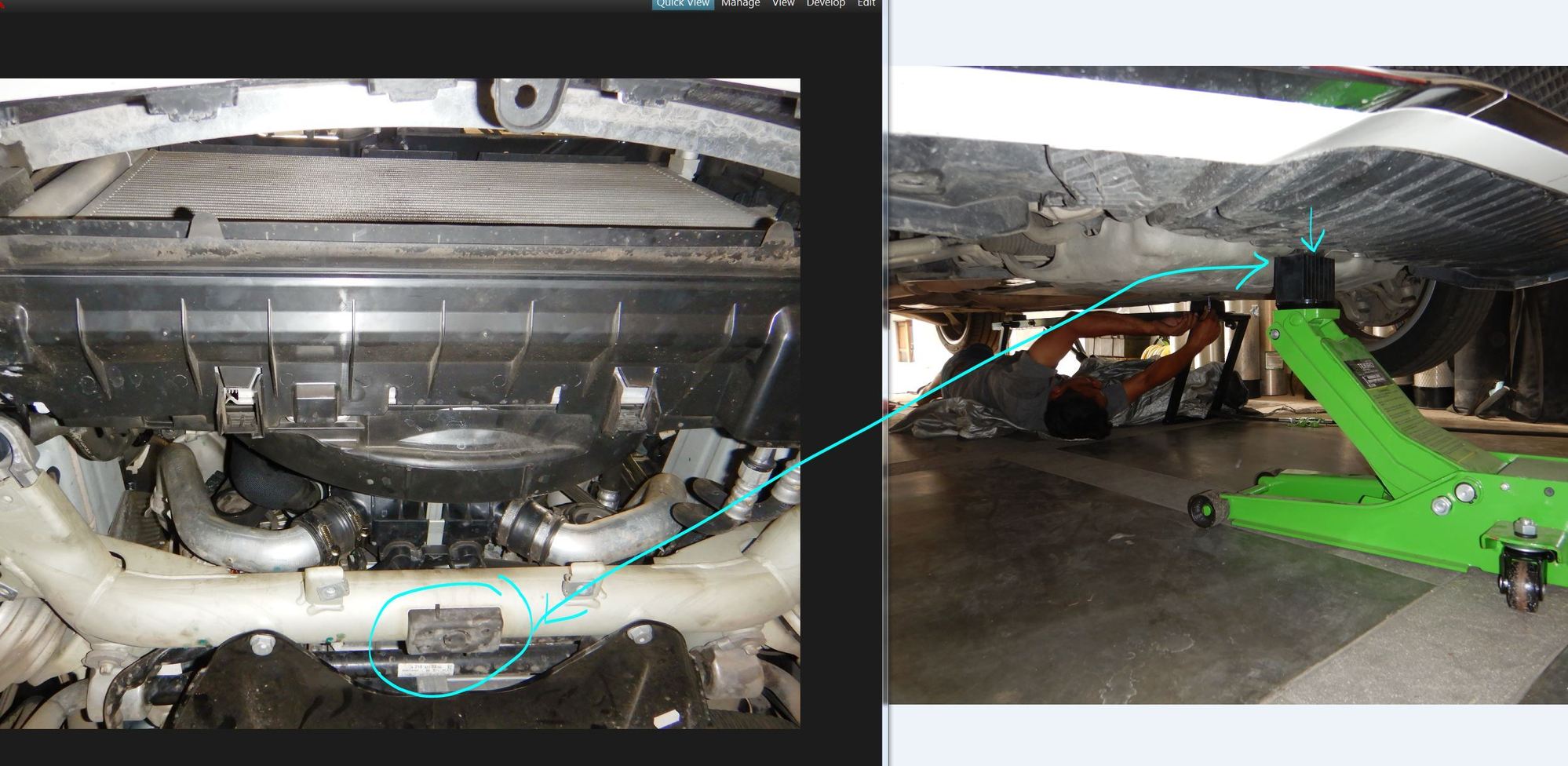

Hi T,
On W212 there is 1 more lifting point at middle of front sub-frame ( under engine ), W213 should be the same I think.
For rear single point lifting, DO NOT be tempted to use the differential casing.
I do not reccomend the rear to be lifted using a single point.
Whenever I lift up all 4 wheels for my W212 using the QuickJack, the common green hydraulic jacks ( I use 2 ) are just a safety back up for front and back or sometime I use 2 jack stands for rear and 1 hydraulic jack for front.
Get wheel chokes please, if you lift only 1 to 3 wheels. Place choke behind and in front of wheel/s touching the ground. I use 4 chokes, me scared of earthquake.
