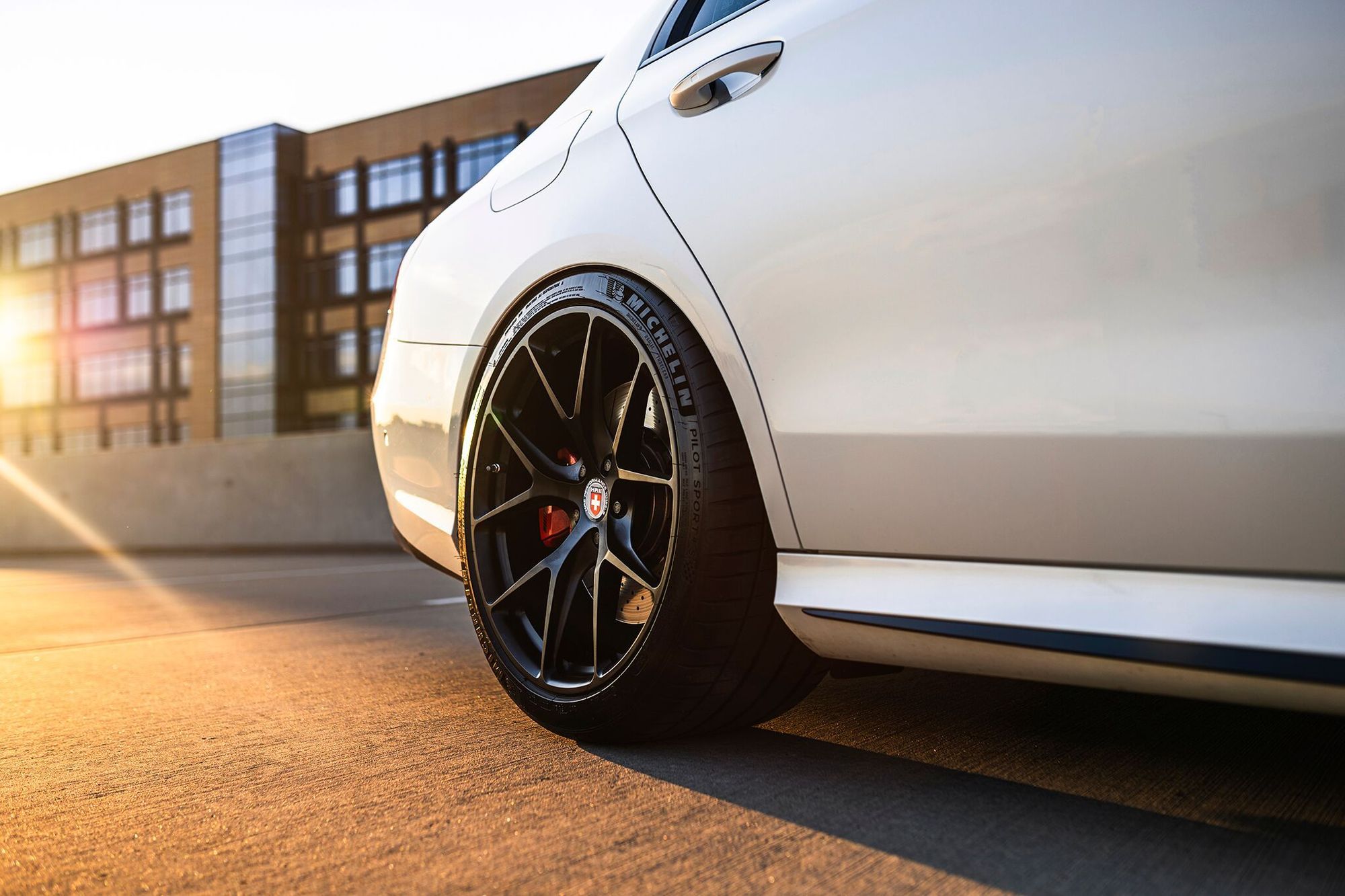

I have 20x10 et 12 and 20x11 et 52
Ideal would be 20x10 et 9 and 20x11 et 51
my front have a little more room and I have 275 front and 305 rear tires

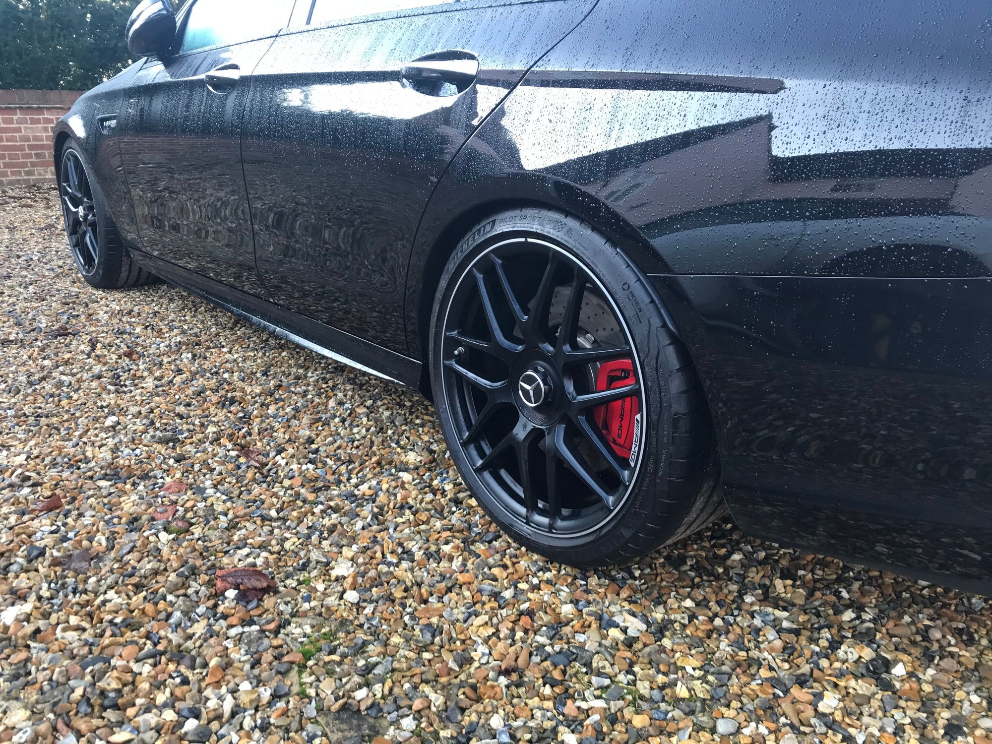

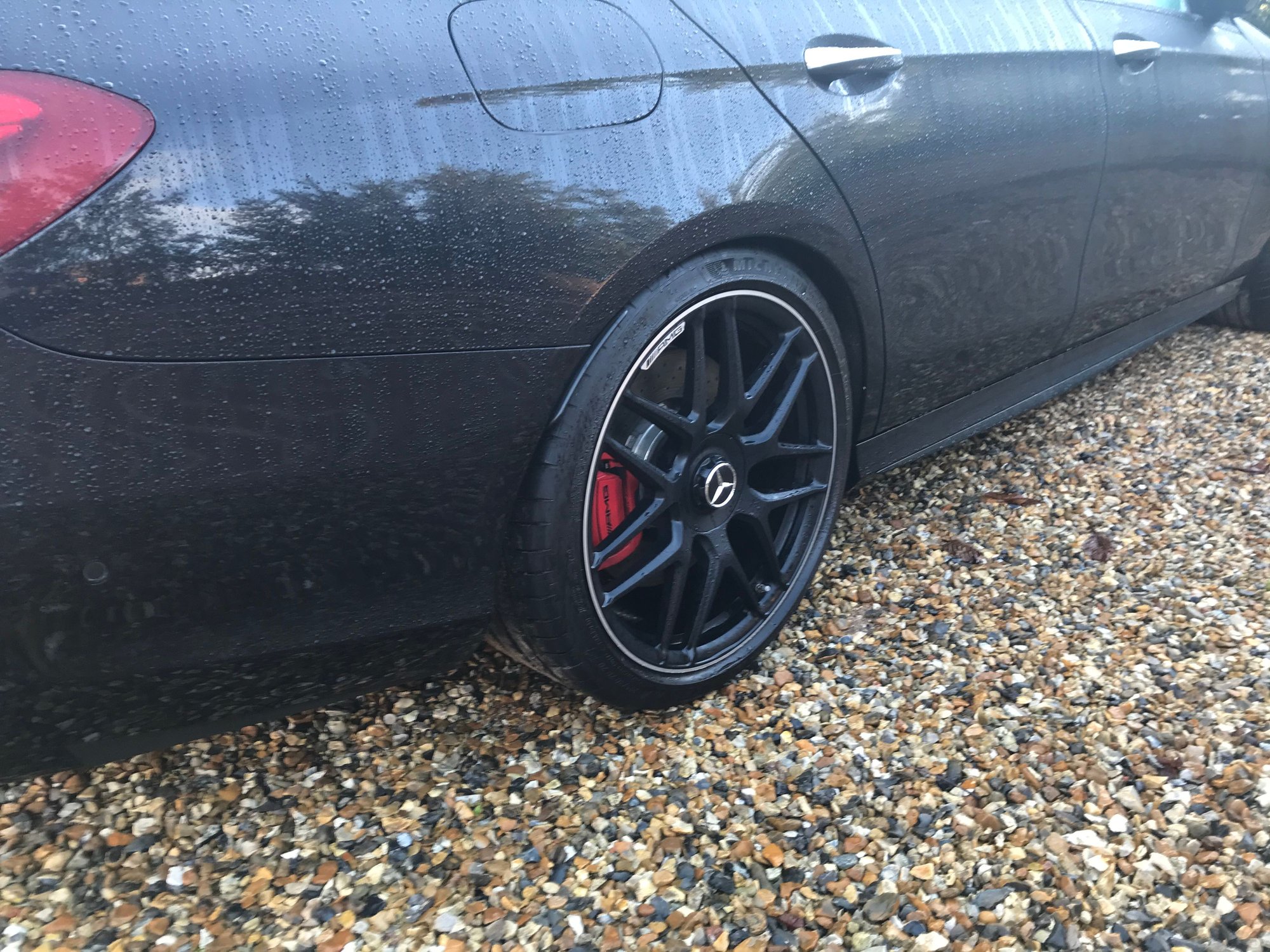

@nw66 could you post some pics of your car to get a visual of how that looks?
Without any spacers remember

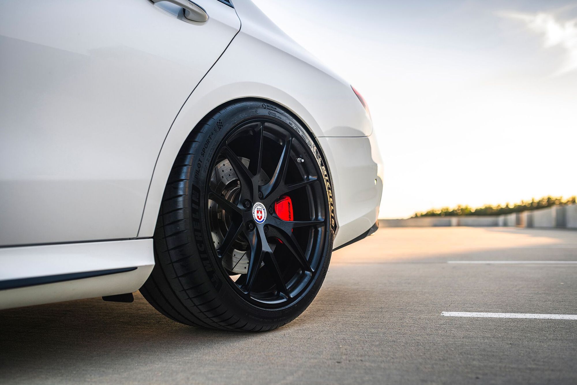

20x11 et 52 with 305/30 MPS4S tires. No rubbing and fit is perfect when lowered.
20x10 et 6 with 265/35 tires or 20x10 et 10 with 275/35 tires is perfect for front.
Wow, that looks great. Is the offset on those wheels the same as in the OEM 20" cross-spoke wheels?

Hey thanks for posting these, @nw66 . Are those really 305's in the rear?? I doesn't look any different from the stock 295... Nevermind, I confused the posts, lol
standard 295’s no spacers just lowered!! 15mm front and 12mm rear spacers will fill out the arches the same as the wider tires
