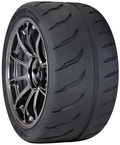

Oct 14, 2021 | 11:20 AM
here is my favorite
never mind, i live in california
Reply 2
