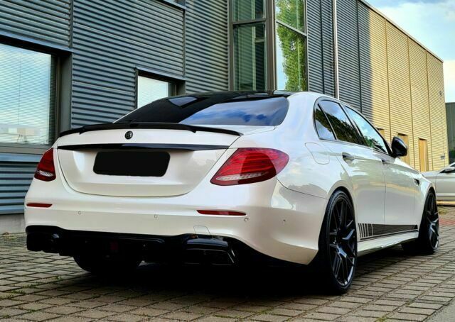

ive searched a lot but cant find anything. I was wondering if the 21 inch GT63s wheels fit on my E63s? I really like the look of my current 20 inch wheels but i really think they are too small for my taste. If the 21 inch from the GT63s will fit that would be perfect.

Your rear tire would need to be 305/25/21 for that to be near the factory speedometer calibration. The rear tire will stick out and a very high probability it will rub the wheel fender

You'd also come out cheaper with a custom wheel and tire size that would avoid the calibration matter unless you know someone that can code the car appropriately.

and what about the gle63 wheels?
10,0J x 21 ET54 and 11J x 21 ET49
would that work?
i really the look of the oem wheels, thats why i dont want a aftermarket set with custom specs.

Your front is the problem now. It will not clear the suspension components at all
the rear will rub the wheel fender ever slightly

Is it because of the high et up front or is the 10j wide just too big? Probably a combo of both right?
the offset is the problem and then the wider width is compounding the fitment issue even more.

Originally Posted by RobS.
Okay i understand.
would that work?
This will work if you run a spacer up front.

I don't think so. In the current specs, 35mm closer to suspension and yet the wheel is already extended out by 23mm. If you put a spacer of say 30mm, then you are extending the wheel outward to 53mm (2 inches), you believe this will not rub the wheel fender ? That's a significant extension. Besides, having a pretty heavy wheel extended out off from factory setting, the suspension components would likely be stressed by this extension. Just my 2 cents.

actually, looking at spec, GLE will fit just fine. Maybe a 10mm spacer at most. It might even fit without one.
@bobblehead people are fitting 21x10 +35 with 265/30/21 all day. It’s been done many times with zero issues. A wider wheel doesn’t add any stress.

It's not the width that may add stress to the suspension components, it is how far the wheel being extended out that may pose the issue (to me the projected 2 inches are a lot, given the weight of both tires and wheels together)
Lastly, OP can always consult the proposed 21 inch GLE 63 or AMG GT4 wheels setup with a few wheel/tire shops and then go from there. If they come to an agreement of no issue at all, then OP has the clearance to go ahead with the move. I am just looking at the variance #.
