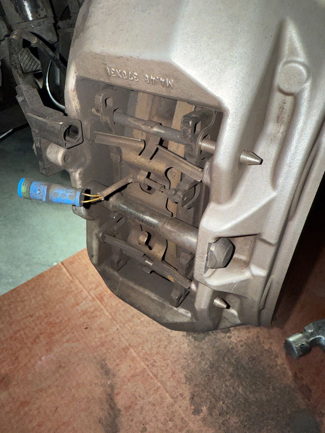

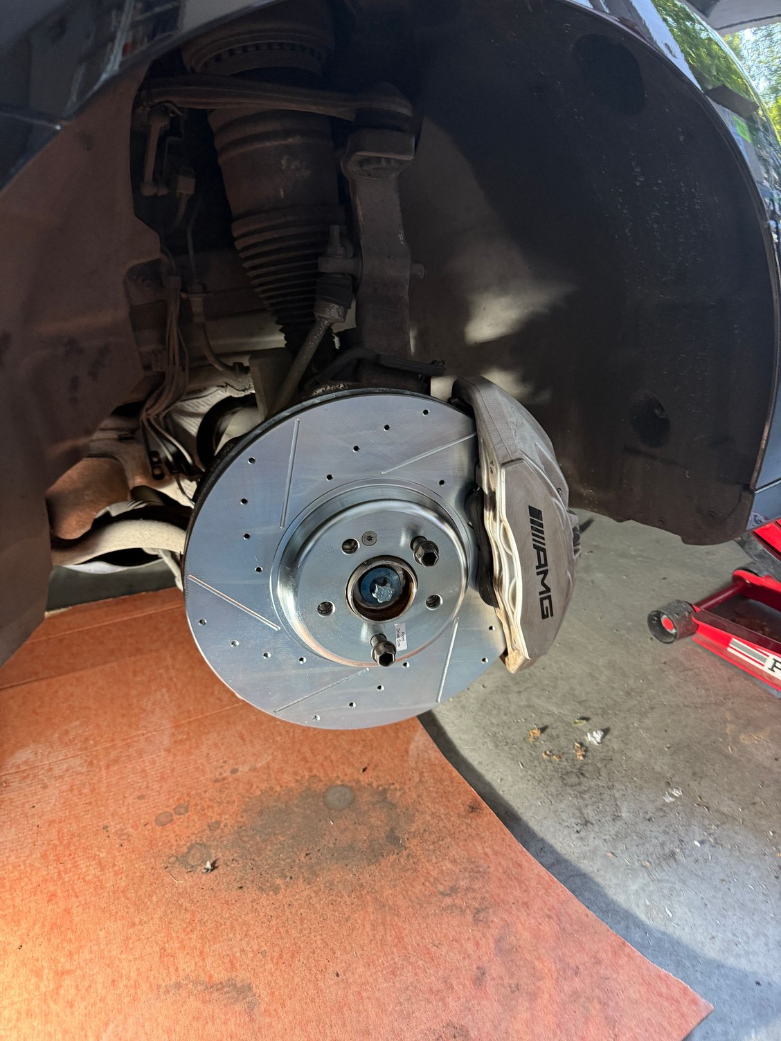

Sort of update: Having the same issue as OP and I think one or two others in this post - I figured I would start by trying to replace my front rotors and pads. My front rotors had a very pronounced lip and I was thinking that the pads, even when not in contact with the rotor flat part, would still rub a little bit on the lip (since it sits "in" the lip) and cause it. Sound is still there, though it's definitely better. I lubed the metal/metal parts, and the new pads came with new pins and the shield. I see others who replaced the calipers and it went away, but I don't really see what on the caliper would cause it (by replacing it)
It's absolutely related to the brakes as even 1% brake pressure when it's squeaking silences the noise instantly even when not really "braking." These brakes produce an insane amount of dust and I tried cleaning the main stud which goes through the middle of the caliper but may try yanking it back out and really cleaning it. If there is some dust buildup I could definitely see that causing this noise. And new calipers would replace that stud...so would make sense. Will keep trying...
New rotors and pads look great
Caliper and pins
Caliper and pins (old parts which were replaced, just don't have a photo of it)
My strong suspicion is that its metal rubbing at these points. I lubed them a bit but maybe not enough
My strong suspicion is that it's metal rubbing at these points. I lubed them a bit but maybe not enough

Thanks for the pictures and thanks for the update.
