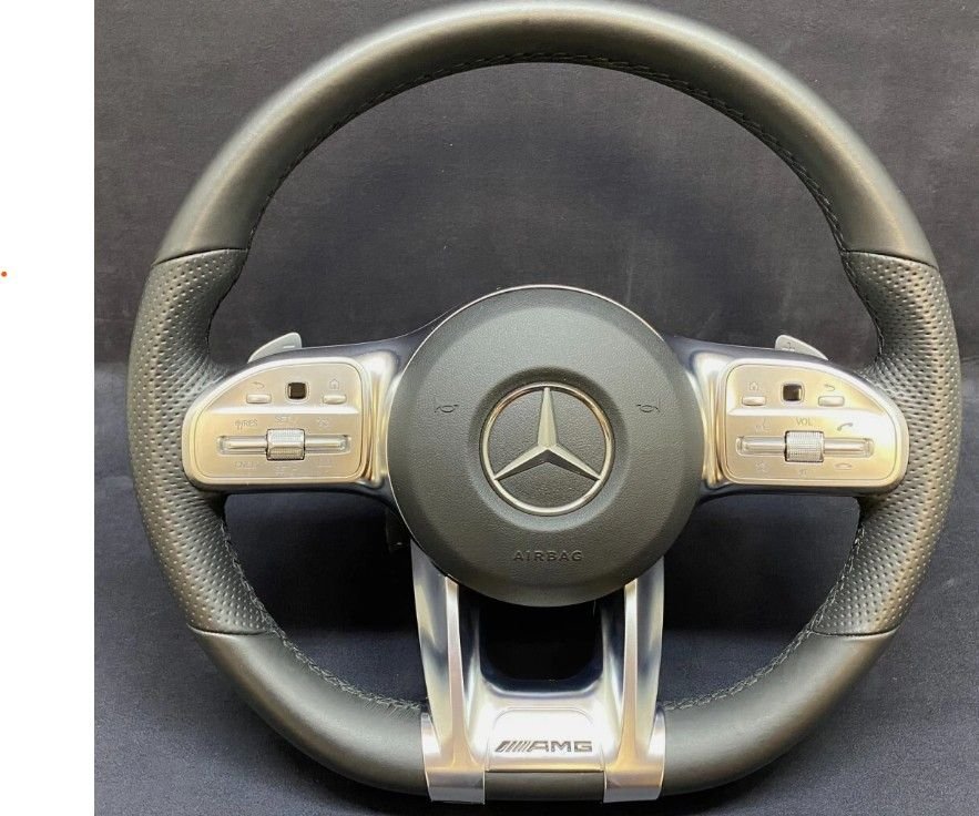

so the steering wheel is intresting
the steering wheel connects via the steering column module.
The steering wheel itself has numerous little modules in it.
So the question is, I am going to assume that the 21 steering wheel is
and not the newer dragon fly OR older one
Reply 0
May 15, 2025 | 01:38 PM
This is the wheel in my car.
Reply 0
May 15, 2025 | 01:43 PM
Same wheel in my '22 (suede amg wheel).
Reply 0
May 16, 2025 | 01:38 PM
So it is the dragon fly and judging by the displays..NTG6 based.
Yeah there are a total of i think 6 "Small" modules inside of that steering wheel (ie heard it called the dragonfly steering wheel). Also MB changed the wiring on it from the pre-facelift so there was a a lot of tech shoe horned in that that steering wheel.
Reply 1
