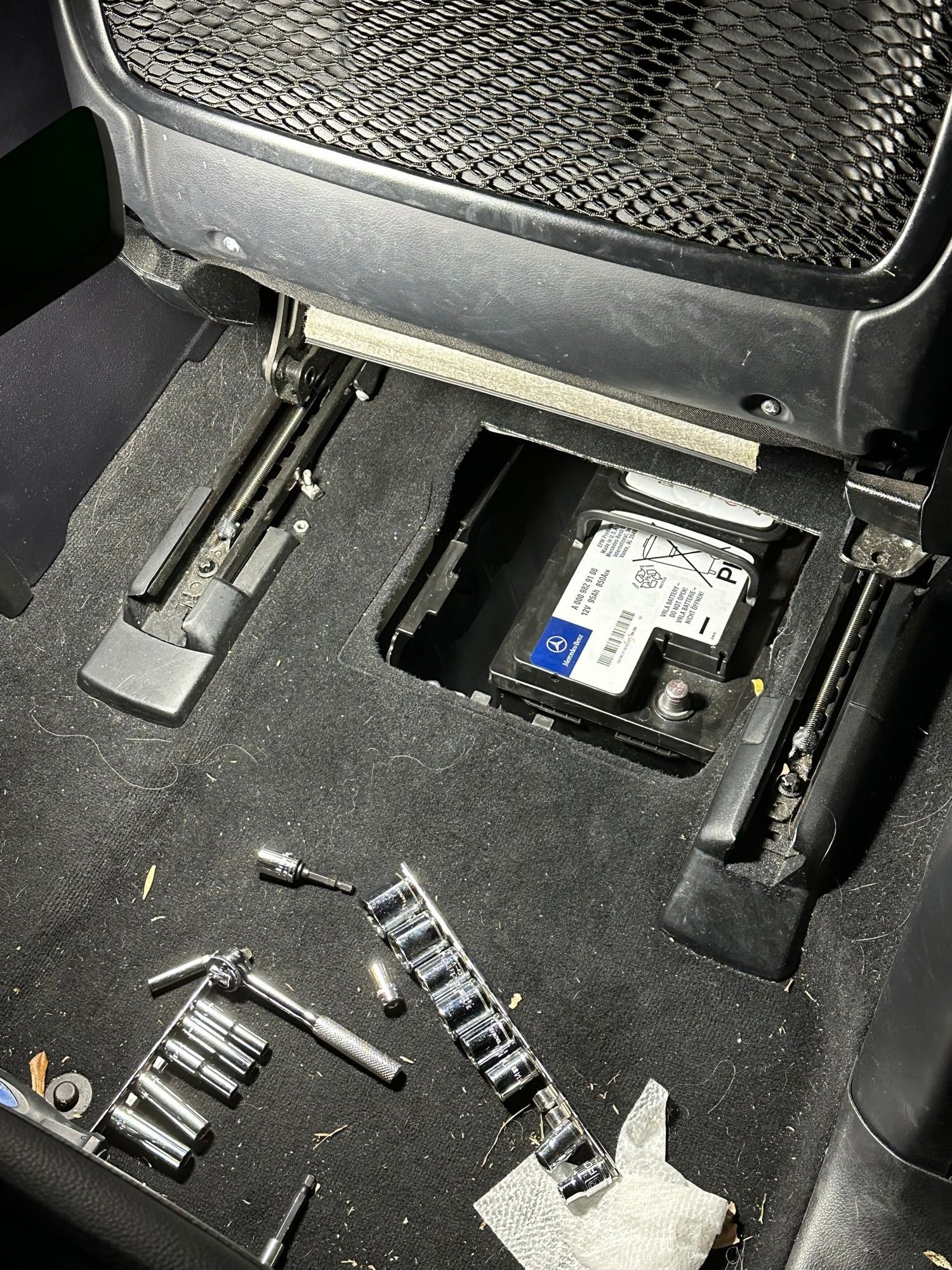

Do you have a link to the best compatible battery? Thinking I’ll just buy a new one and call it a day. Unless it’s located under the front seat like my wife’s GLE. I’ll sell the car before I do another one of those.
