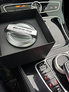

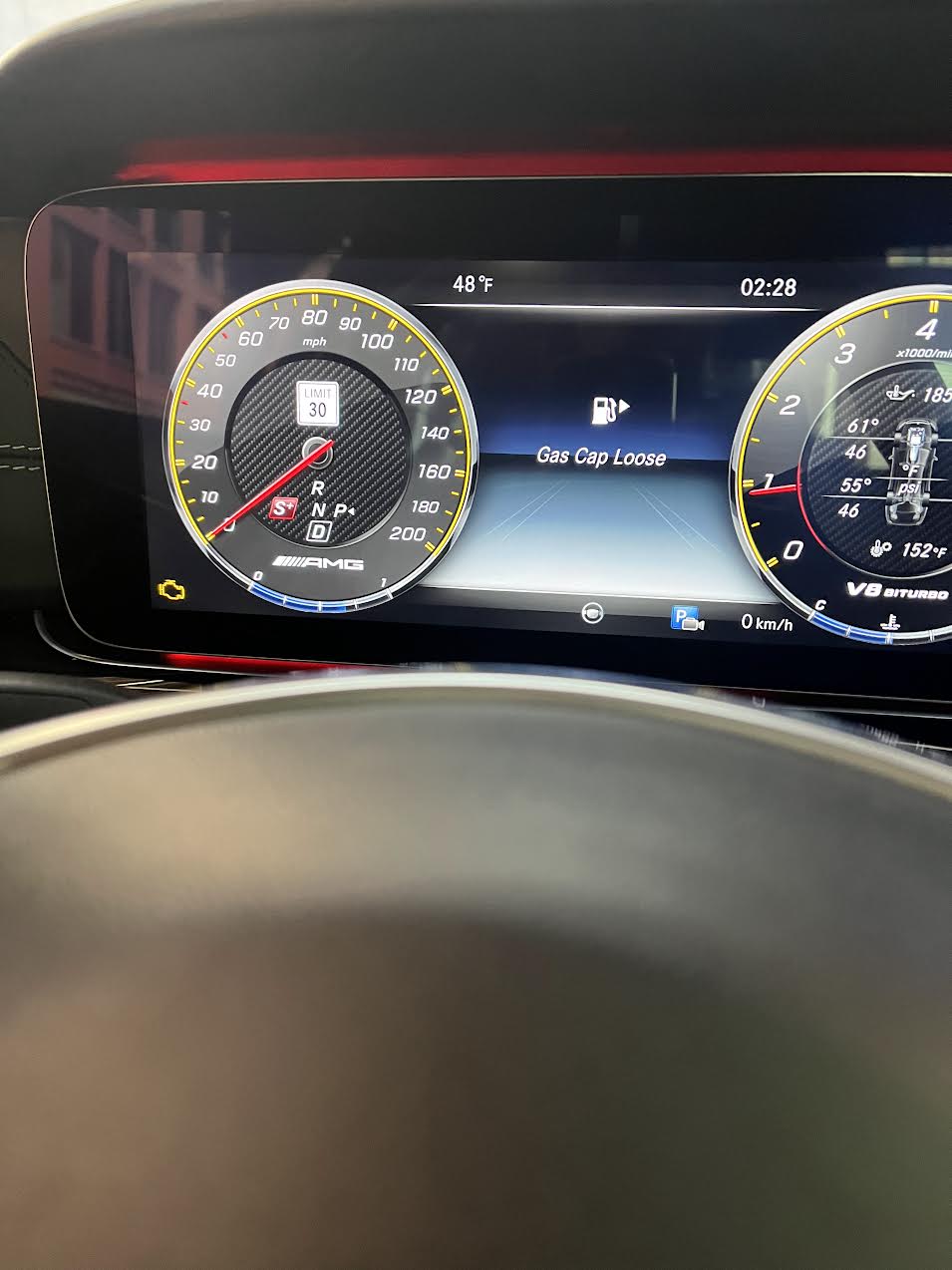

Has anyone else received this gas cap notification? It continues to come on which triggers the check engine light. My MB service advisor said he has been getting a lot of calls about the same issue. I have an appointment tomorrow for him to look at it.

Have one on my GLE 63 and no problems. As a habit even before I got it, I always turn the gas cap until it stops (click) and then go a skosh more until it bottoms out which you can feel. If you tried that and still have the message then most likely it's a defective cap. Did you put the old one back on to see if the message goes away? To me it seems odd the service advisor says he's been getting a "lot of calls" about this issue. Not too many know this cap exists and I'm sure there are even fewer who are ordering one.

Yeah, maybe mine is defective. I stopped by the dealership today and he has received 5 calls about the cap. I put the original cap on and no issues. Going to call MB where I purchased it from to see if I can get a replacement.

same problem with me, started with gas cap loose messages on and off, then a week later after filling up gas I get flashing engine check light and the whole car shakes/idle very rough. Put on the old filler cap back on and we'll see what's going on as I never have this kind of problem before

I put the original back on and went to the dealership to clear the code since it wouldn't do it on its own after several start cycles and driving.
