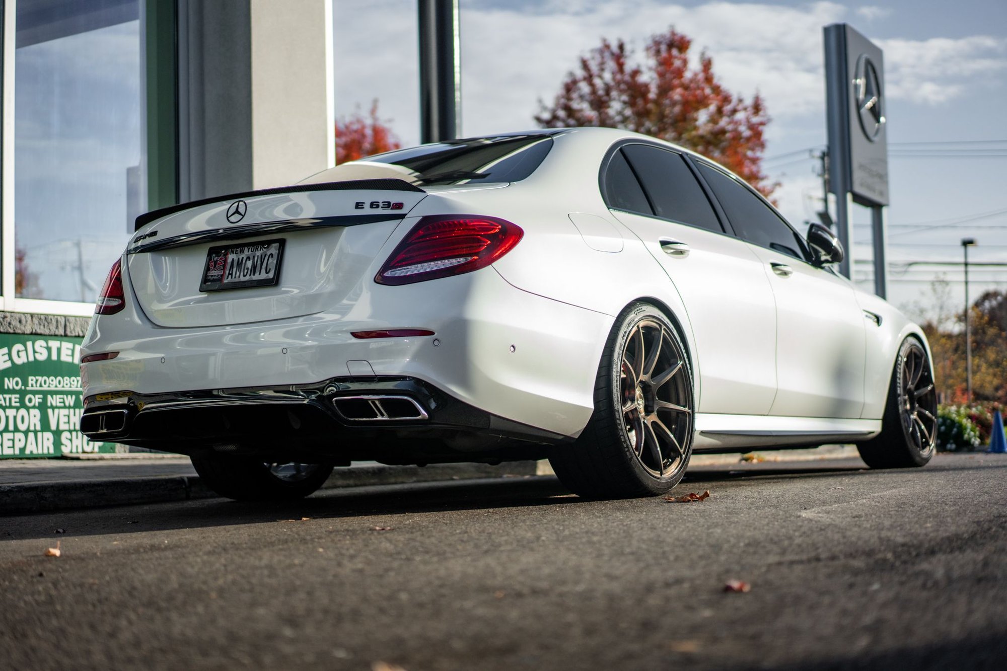

Guys I am curious with the Mods I have what is the expected performance in the 1/4 mile.
I get a lot of flack for the numbers I do with the mods I have and want your opinions. To be fair we are still working on dialing in my car with my tuner, this post is in no way a shot at my tuner. I have been with Eurocharged for over 5 years, 4 on my W212 E63S and 1 on my current W213 E63S.
The best time we have got so far is 10.3 in the 1/4 mile @ 132.11 mph 1.64 60 ft. My instagram is @_amg_nyc if you guys want to see more of the car.
My next mod will be LP and HP fuel pumps which I am told is the missing element but I still feel like the car should be doing better than 10.3.

You should break into the 9's with pumps and a mild E tune no doubt. My friend is running mid 9's with similar mods.

I agree, my question was what times should it be doing with current mods, 10.3 sounds right to you guys?

You answered your own question in the OP, and the answer is fuel. Need those pumps to break into 9's. I'm willing to bet you have serious rail pressure issues with your current setup which is keeping you in the 10's.
