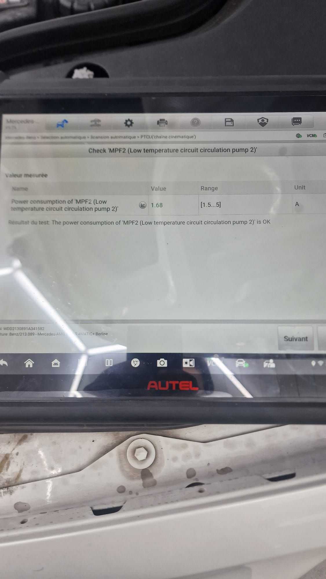

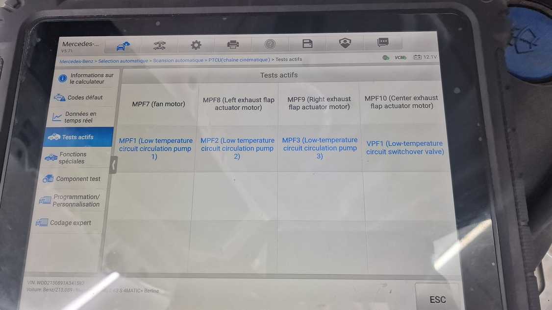

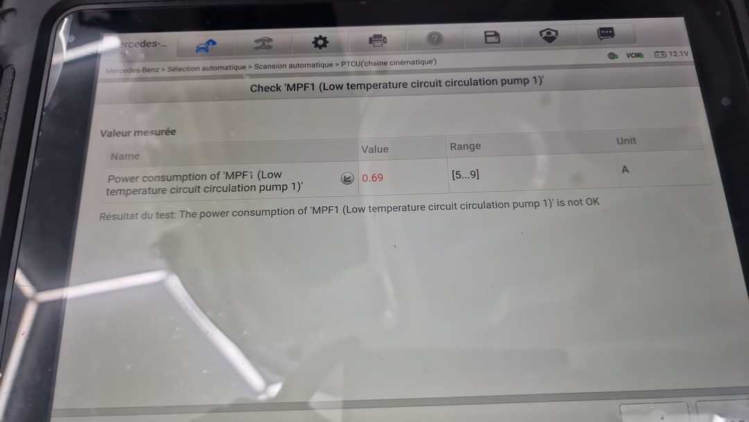

I check with diagnostic tool, there aren't any fault. But I managed to test the 3 auxiliary pump with it
All worked when actuated, but one seems to have power issue, according to test
Can this auxiliary pump cause transmission oil overheating ?

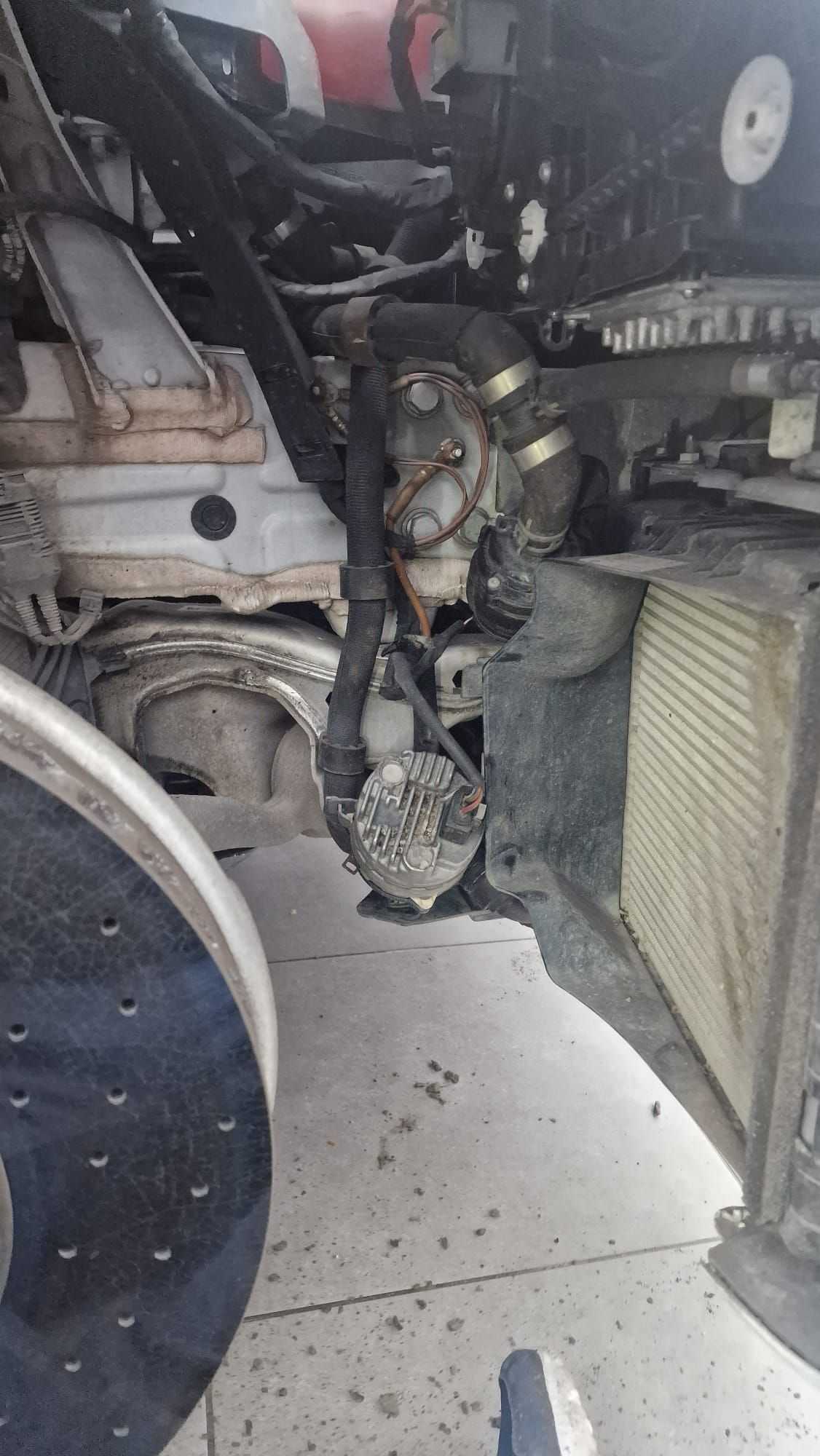

Some news concerning my problem, first , problem solved
I changed this auxiliary pump, but still same problem
I gave back the car to dealer to check what they have done during RMS replacement
They keep the car 2 days, they says all ok, bleeding is ok, vacum test done no leak, they quote me replacement of front radiator
I refused, because it's non sense, to replace it if vacum test is ok
I tried again to bleed (auxiliary cooling) , I launched procedure 4-5 times
After 5 times, AMP of auxiliary pump became normal 6.0 A
THen I tested, pushed the car, run in trafic etc,, now transmission oil temperature is not exceed 80C , it's all ok
Was just a bleeding issue
Thanks to all for advice and help
