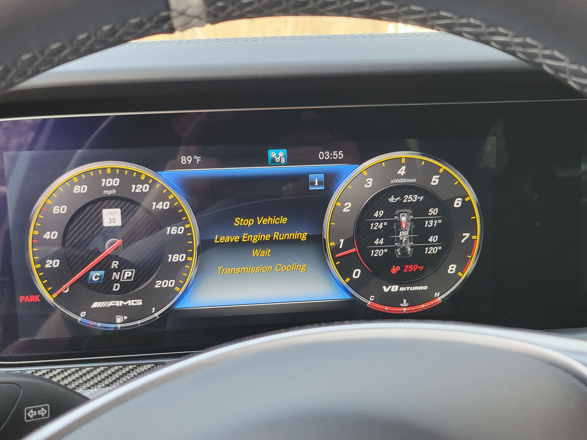

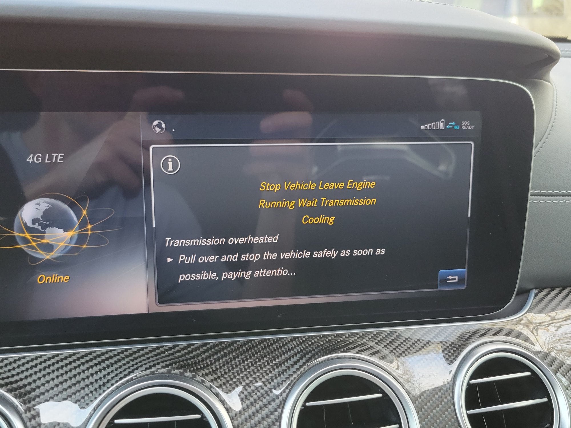

After having the RMS and upper main seal replaced by dealer and having the car back for less than a week, the transmission is overheating. Temp was 90 degrees Fahrenheit today and yesterday. Trans temp was up to 241 fahrenheit yesterday after a short drive (30 min) and today went for a little longer drive 45 minute mixed city and highway and Temp got to 261 fahrenehit, at 250 fahrenheit it turned Red and told me to stop vehicle leave running tranamission cooling. When i saw the temps start to rise I jumped on highway to try and cool down but it just continued to rise slowly. From my knowledge trans hasnt been serviced before, I was going to get it serviced when I first bought it because I believe its supposed to be changed every 30k but service advisor told me about 2 pre pay service packages that would save me $2k and when I bring it back in for its 60k service next February the trans fluid and filter will be changed.. i gotta call dealer and tell them wtf

Coolant level was at the minimum mark when cold, I noted this when I picked up the car from the dealer after the repairs and asked that they top it off before I leave. I watched the technician that did the repairs top it off. I checked it today before driving after seeing the higher transmission temp yesterday and it was a couple centimeters below the minimum mark. In the stop and go traffic today my air conditioning and ventilated seat werent performing the best, but once the highway was functioning good. Not happy about this at all.
Also important thing to note this occurred under normal driving in COMFORT mode, no spirited driving at all, no race starts none of that just easy driving
