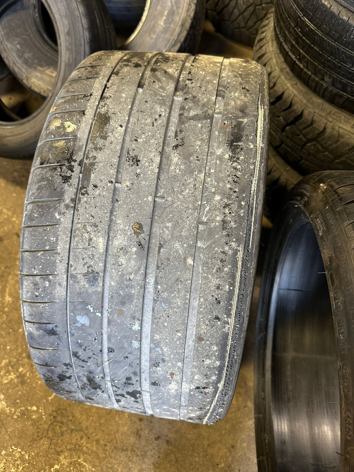

I'd like to know if camber bolts can help take out some of the negative camber that seems to be eating up my tires? The FEBEST 1629-204 page lists compatibility with "MERCEDES BENZ E 63 AMG S-MODELL 4MATIC 213.#", and other pages list the MOOG K90474 and the ACDelco 45K18036 as compatible with W213. I've read all the threads about KMAC bushings and various F1-Fab/TheCamberKing aftermarket parts, but I'd just like to know if these camber bolts can provide a little help? Has anyone here tried them?
My 2018 E 63 S 4Matic+ wagon destroys tires - both front and rear. The inside of the tires wears very heavily while the outside of the tire basically shows little or no wear whatsoever. I've had the dealer do alignments to confirm that the car is "in spec", but it keeps on killing tires at an amazing rate. I have stock suspension and normally drive in Comfort mode at typical street/highway speeds of 30-80 MPH. The tires are consistently inflated to 41/front and 39/rear, as per the diagram in the gas cap cover. Nothing fancy going on here.
Most recently the driver side rear Michelin PS4S failed, and on examination the inside of the tire had worn completely down to the metal while the outside looked new. I didn't record the mileage when I put this tire on, but I think it lasted only about 6000-7000 miles. The previous tire had failed the same way, as had the rear tire on the passenger side.
Down to metal on the right, but apparently not even making contact on the left?

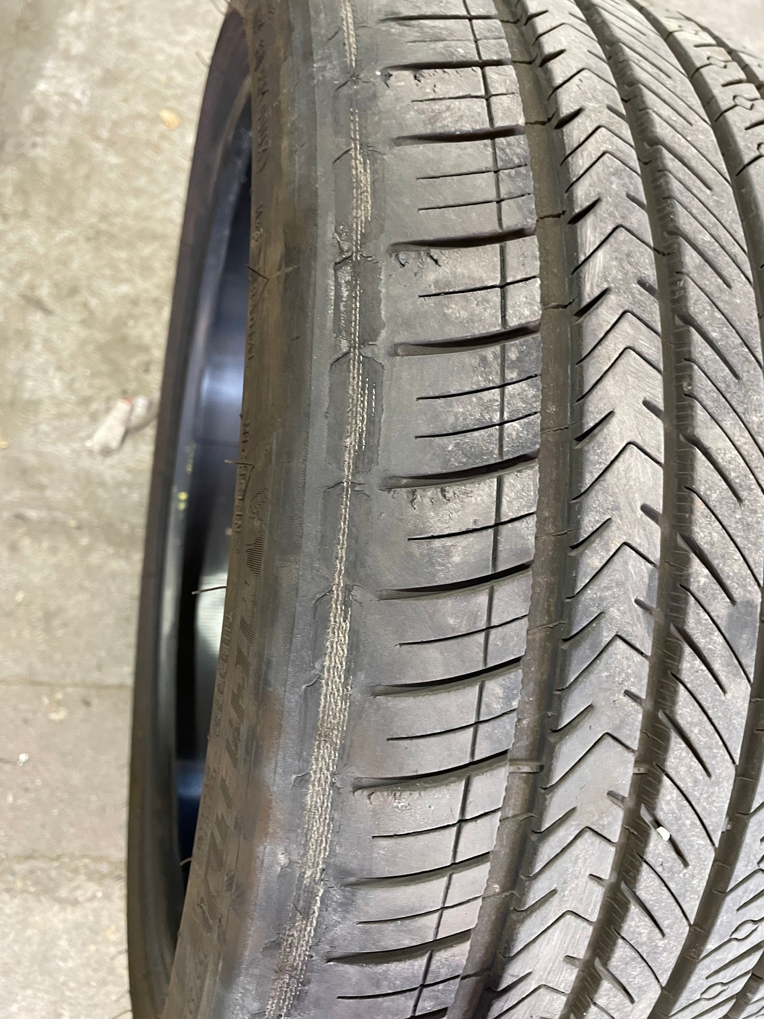

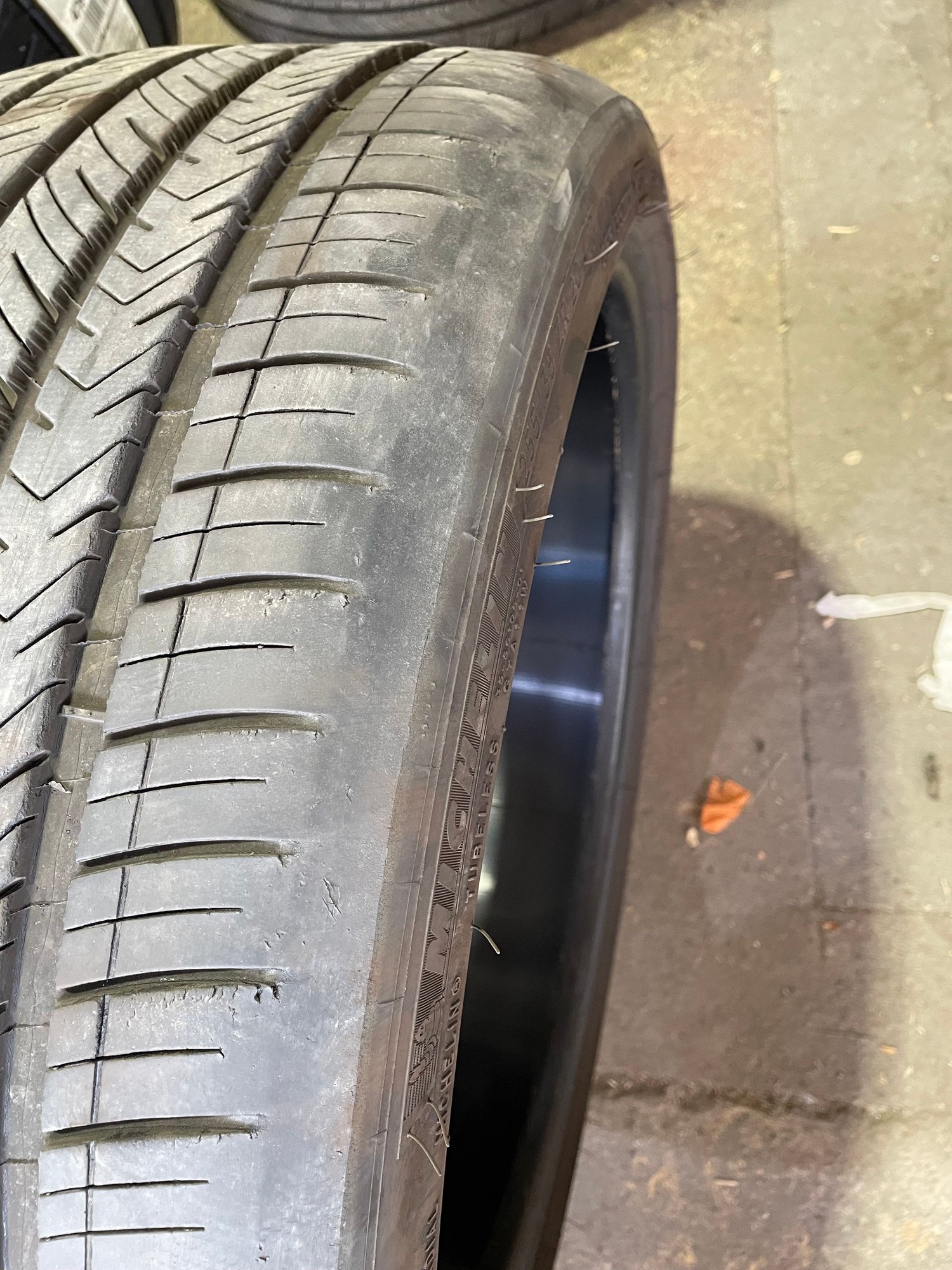

Front passenger tire removed last week
Front driver tire removed last week
These are the replacement after the orig Michelin 4s went ka-boom ... so it happened again and again

The orig ps 4s happened at near 30,000km (18,000 miles) … mind you, this mileage was withthe blowout. Then i replaced that with the Michelin as4 (with 4 wheels alignment done at dealer) and that probably lasted no more than 25,000km (15,000 miles) or less (as seen with the pics), no blowout but with cords showing.
Dealer told me to maintain the front psi at 41(cold reading) and i did exactly that and yet the exact same front passenger exhibited the identical excessive wear on the inner wheel as the orig 4s.
the rear also have the same excessive wear but at more mileage.
