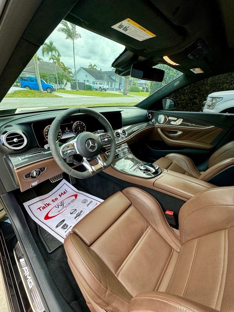

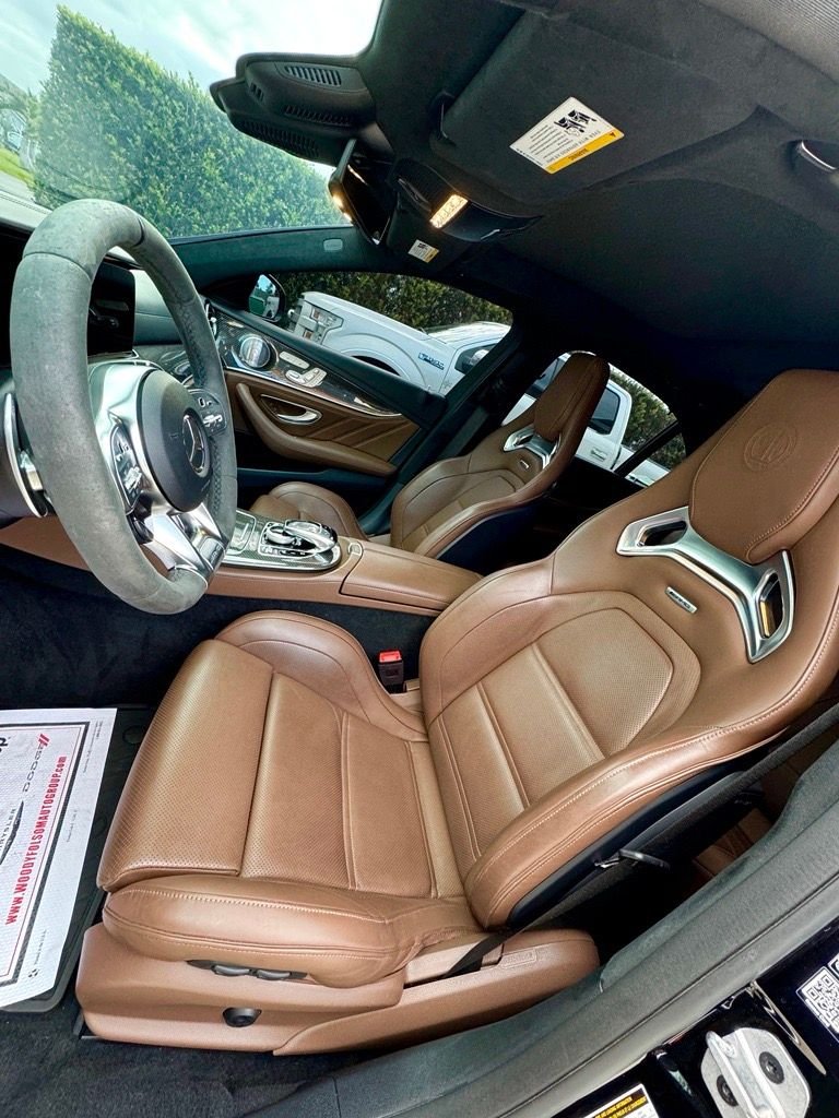

Is there any way for you to confirm that the drive units were factory installed, ie original window sticker, etc.?
I assume they are factory, but my initial reaction to the photos of your car's interior was that there could be some aftermarket stuff going on...that may have been my reaction only because I have never seen nut brown sport seats out in the wild like this. Nice seats!

Shouldn't it still be under warranty? Do a vin search and see if they were factory installed. I can't remember the site though, do a search. The site will list all factory options. The headliner gives me bad mojo vibes.
