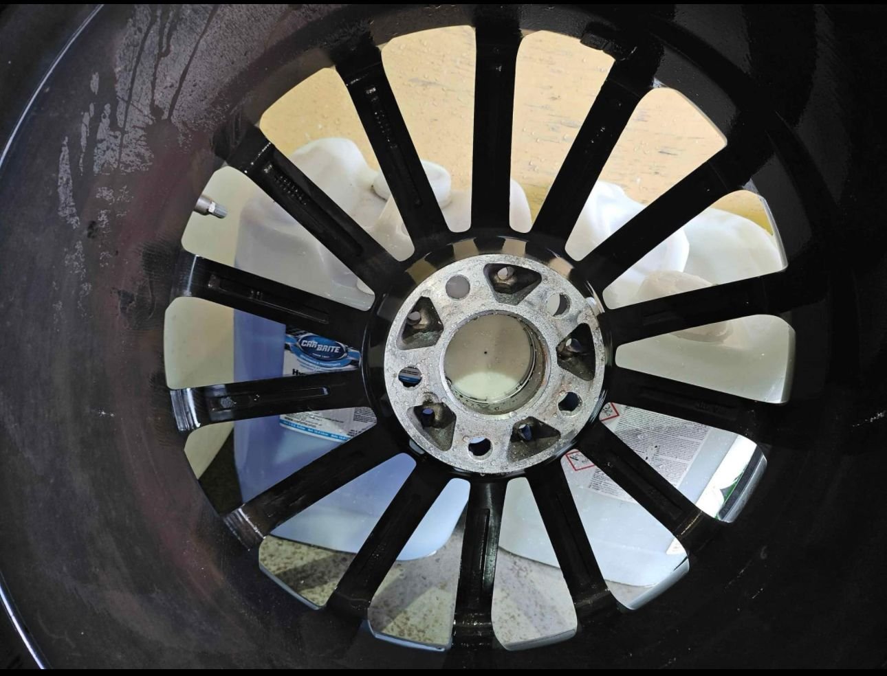

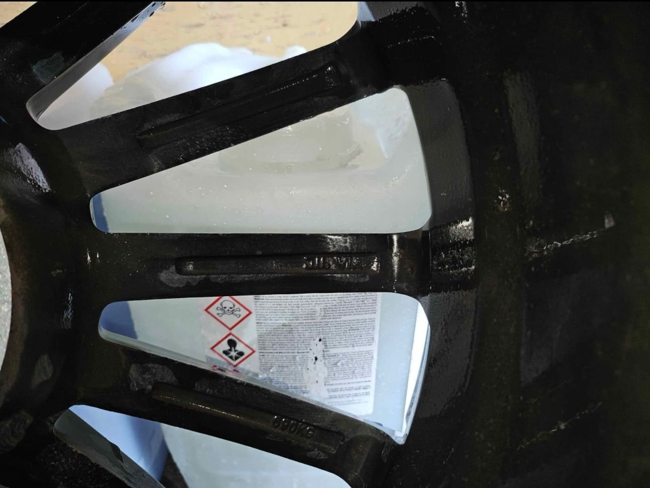

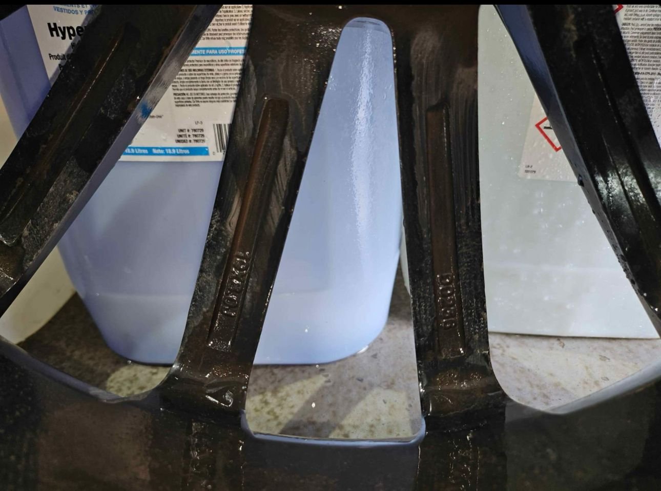

Just purchased a 21 e63s, looking into getting a winter set sooner rather than later. I have attached pictures of a set that is for sale near me.
It is a square setup 245/45/19, seller states it was on his 21 e63s from before as well.
Can someone verify if these are intact OEM Mercedes wheels and if this setup will fit the car?
​​​​​​​TIA!

We had an interesting discussion recently about fake Mercedes wheels:
https://mbworld.org/forums/w213-amg/...it-wheels.html
Also worth checking out the sticky, there's a couple links about winter wheels that may benefit you despite the answers you'll get in this thread. Good luck to you and congrats on the car.
https://mbworld.org/forums/w213-amg/...ml#post9005634

That can’t be from a w213 e63 wheels at all. Given the e63 has some odd offsets, you will need to see the offset for these wheels.
Be very careful, especially seller is not providing you the pics and details
i say they are fake/replica.

OP: Here is the OEM recommended set up for winter for the 2021 E63. Rim size front axle: 9.5Jx19 ET25 | Part number: A2134012600 Rim size rear axle: 10Jx19 ET54 | Part number: A2134012700 I have had a good experience with an international seller for my set, (fair price) and I know someone who had a bad experience with a US based seller for a very similar set. If you want the details for the international seller, PM me - they actually have one set available now though tread depth is not great.
