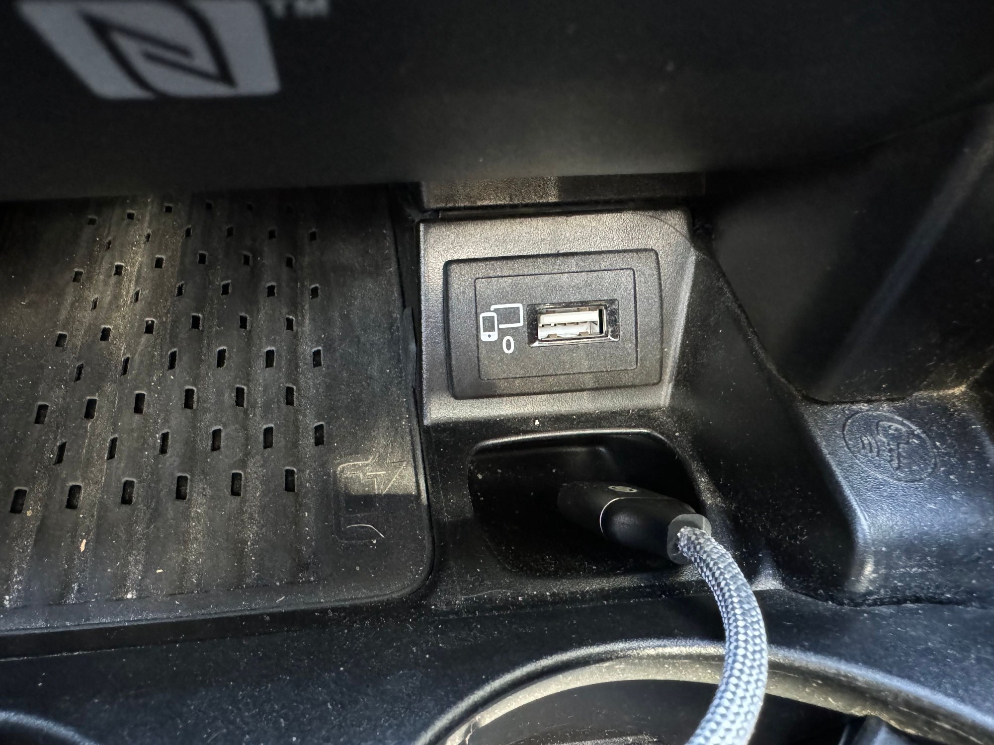

I seem to keep having issues with my iPhone disconnecting from the USB charger and I have reason to believe the outlet is wearing out. Is there an easy way to replace it or not an option?

Maybe this recent post helps. You'll have to find the correct part. Looks like they are different between the W213 and W205, but it's probably similar procedure to replace it.

Thanks for that! Based on that post I was able to track down a replacement unit and it happens to come from the dealer I actually bought the car a few years ago … small world. As soon as I get it I’ll report on hopefully a smooth install …
For my ‘19 E63S: Item: Connection Unit - Part #213-820-32-00

replacement arrived & installed. Fairly simple but its a REALLY tight fit, access & hardware wise . . . Seems like there's a slight improvement in connection tightness . . . time will tell. Yesterday I was driving over a railroad track and I always slow quite a ways down as its a rough crossing and Carplay stopped working until I reestablished connection . . . hope that's over . . .
