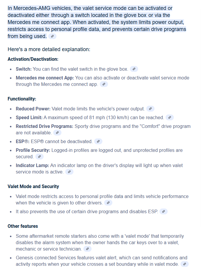

So maybe I was actually wrong about what the valet mode does. I just put it in Google and the AI said this. Following to the sources the list of what it restricts is found in some of the owner's manuals of newer models. It's not clear if any of this applies to older models, too. Only way to find out I guess is to try it and see if things like not being able to disable ESP or not being able to activate the Sport drive programs are indeed true. I don't valet my cars, so I never really had any incentive to dig into it.
