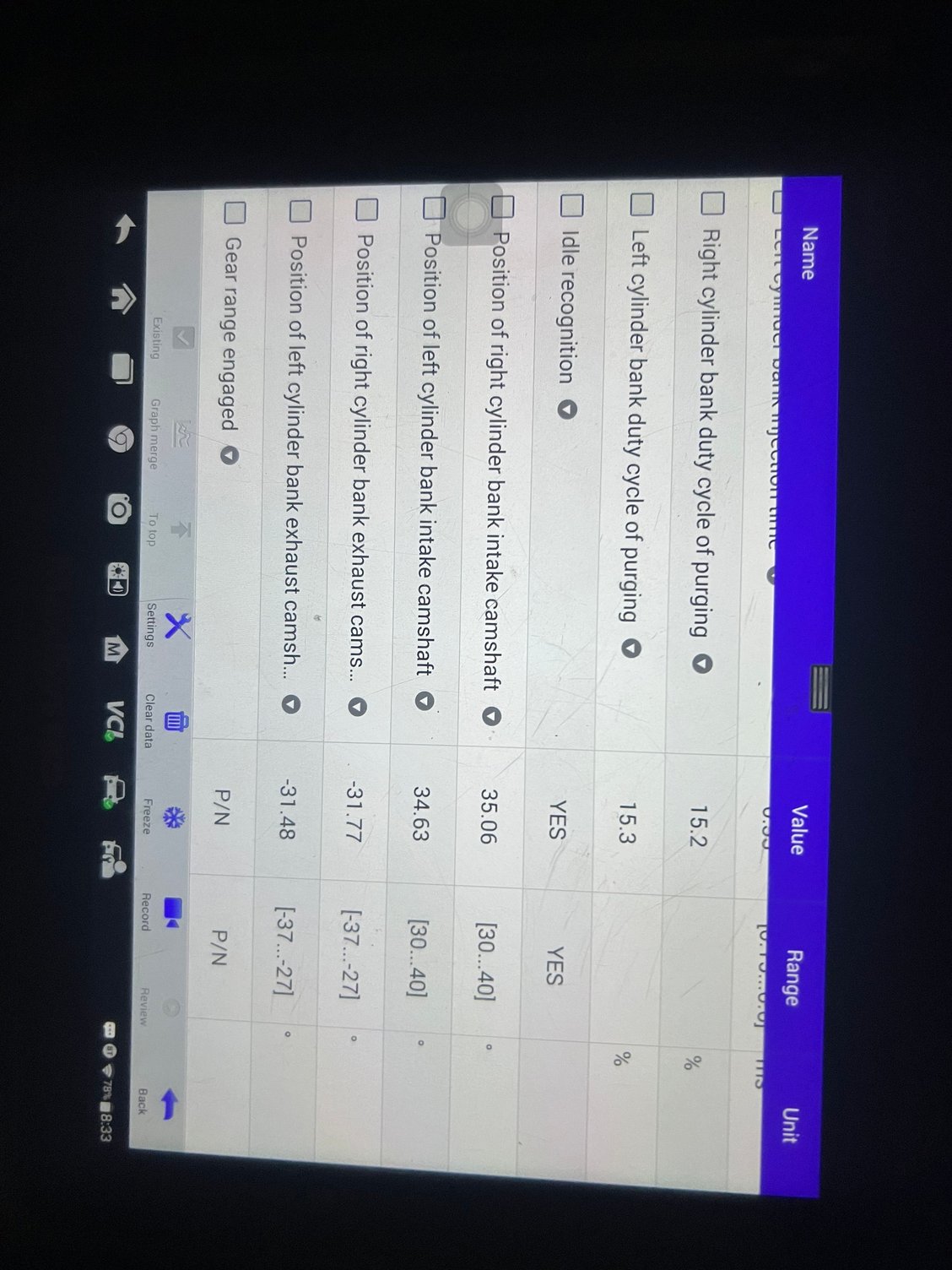

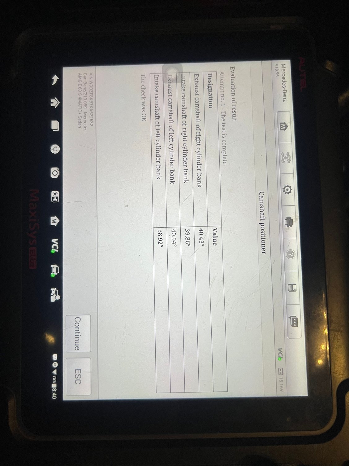

Old Apr 1, 2025 | 10:24 PM
amg.ardi's Avatar
Joined: Mar 2025
Posts: 10
2019 E63S
This is the values during idle
did the camshaft position test with the autel scanner 3000-3500rpm and this was the results as well
Changed the oil this weekend looked normal and looked for leaks found nothing haven't put on the exhaust camshaft sensor on bank 2 in yet but id assume its good since the values read out fine but will change that here in a couple days.
good data; you have a deviation code for the cps therefore you're not capturing a potential issue still with the sensor or there is another condition causing the deviation code.
