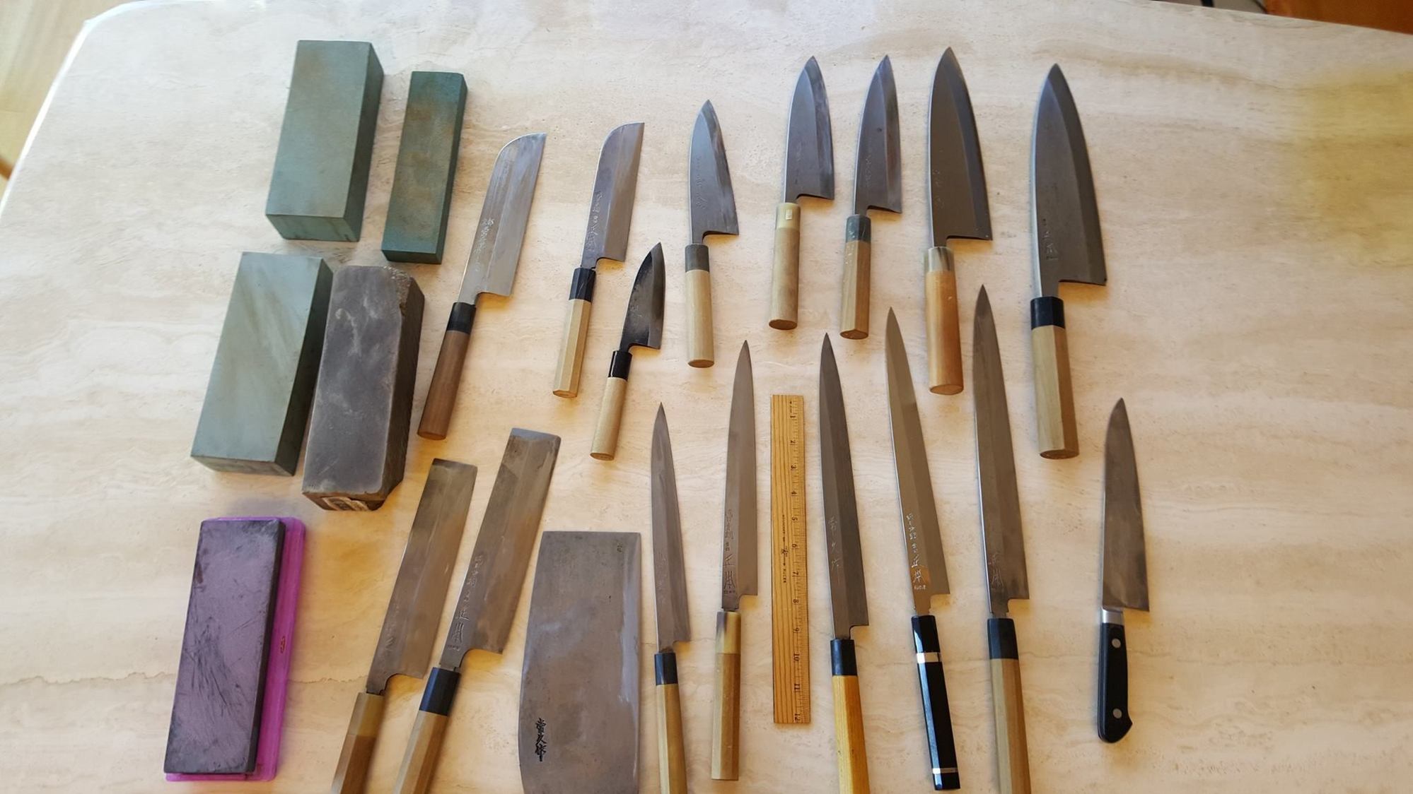

A few of my Japanese knives. I take it pretty seriously.

https://cimg9.ibsrv.net/gimg/www.mbworld.org-vbulletin/2000x1124/knives_c18bcbe6d9bc63016ddac4d656540cca84dad1ee.jp g
I love your collection, thanks so much for sharing!

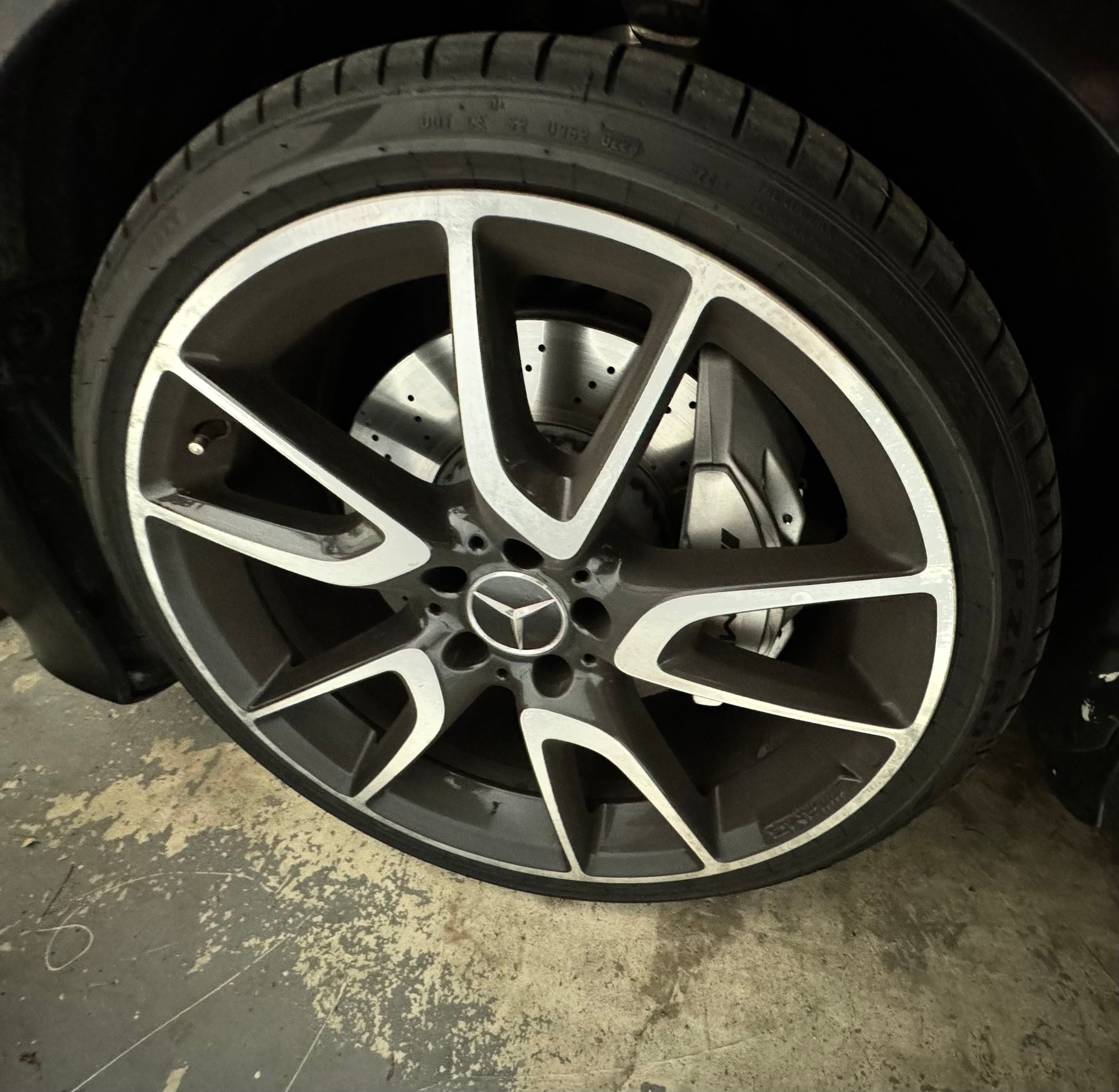

I am currently running the on a brand new sets of pirelli p zero RF. I have to take a better look on the type of valve tomorrow but this is my current setup.
That's a rubber valve stem -- no TPMS sensor.
https://cimg7.ibsrv.net/gimg/www.mbw...a756686ac.jpeg
That valve does not look like the TPMS sensor ones.
Honestly just get one of those aftermarket TPMS systems on amazon or something instead at this point.

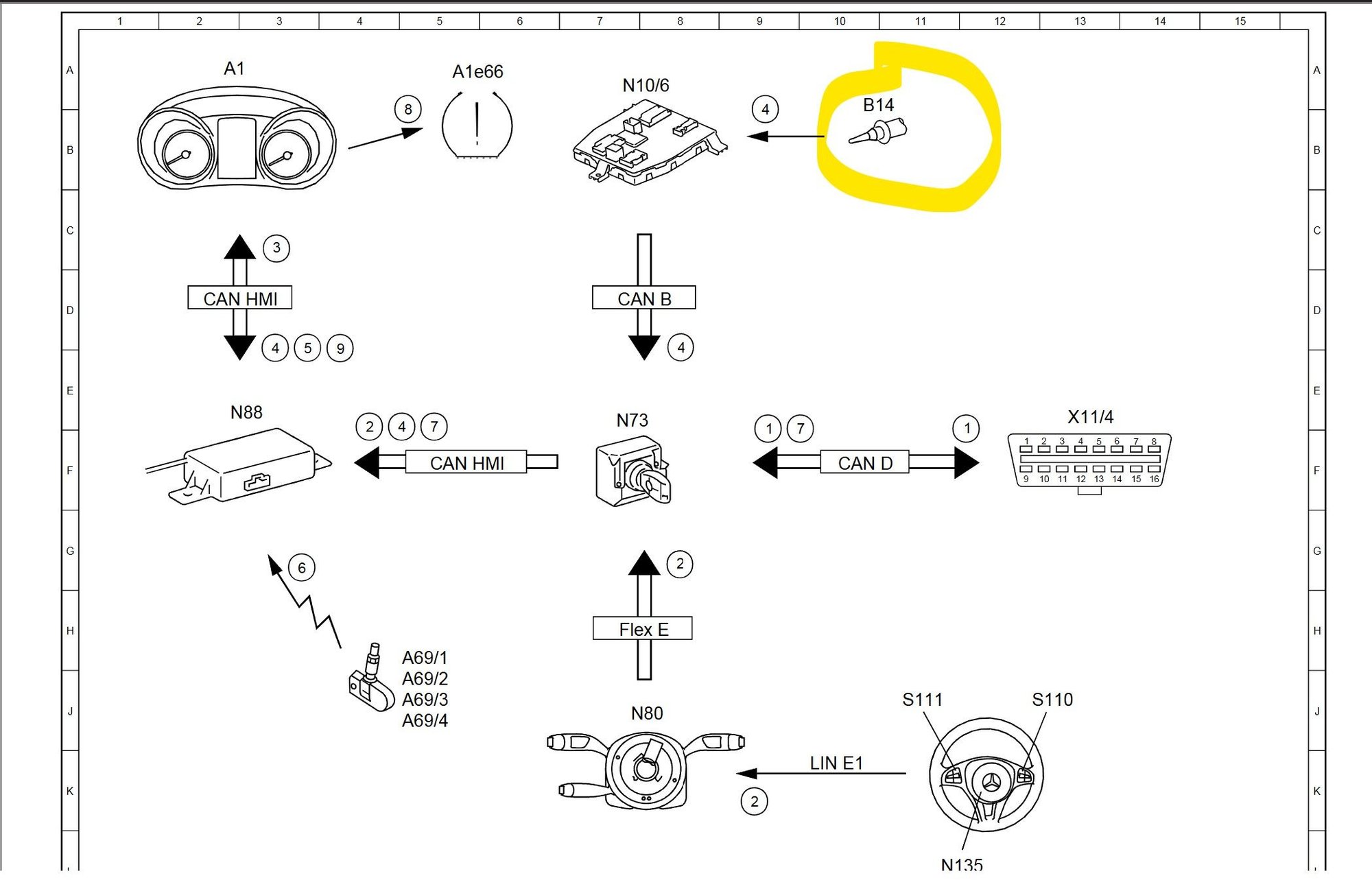

So here is some information for everyone as I looked it up in the workbook.
TPMS code option is Code 475
Also the TPMS speaks a module and then the module speaks the CAM BUS
Here is the diagram of the W205 TPMS Code 475
B14 is the TPMS in the wheel, it sends information to the SAM module N10/6. The module then sends this information to the CAMBUS B of the second line of the CAMBUS. As you can see CAMBUS D tells us that we can test the TPMS and see it with the proper scan tool using the OBDII port.
So if you have TPMS you will see the metal value stem and not a rubber value step. For me, I'm wonder how a C-Class did not come with the option because for me purchasing new cars and never clicking the option for TPMS - they seem to be there. I am wondering if all my cars got TPMS because I spec all my cars with Summer Option wheels and never the base 18 all season wheels however I thought all C-Class W205 and all W213 came with RF????

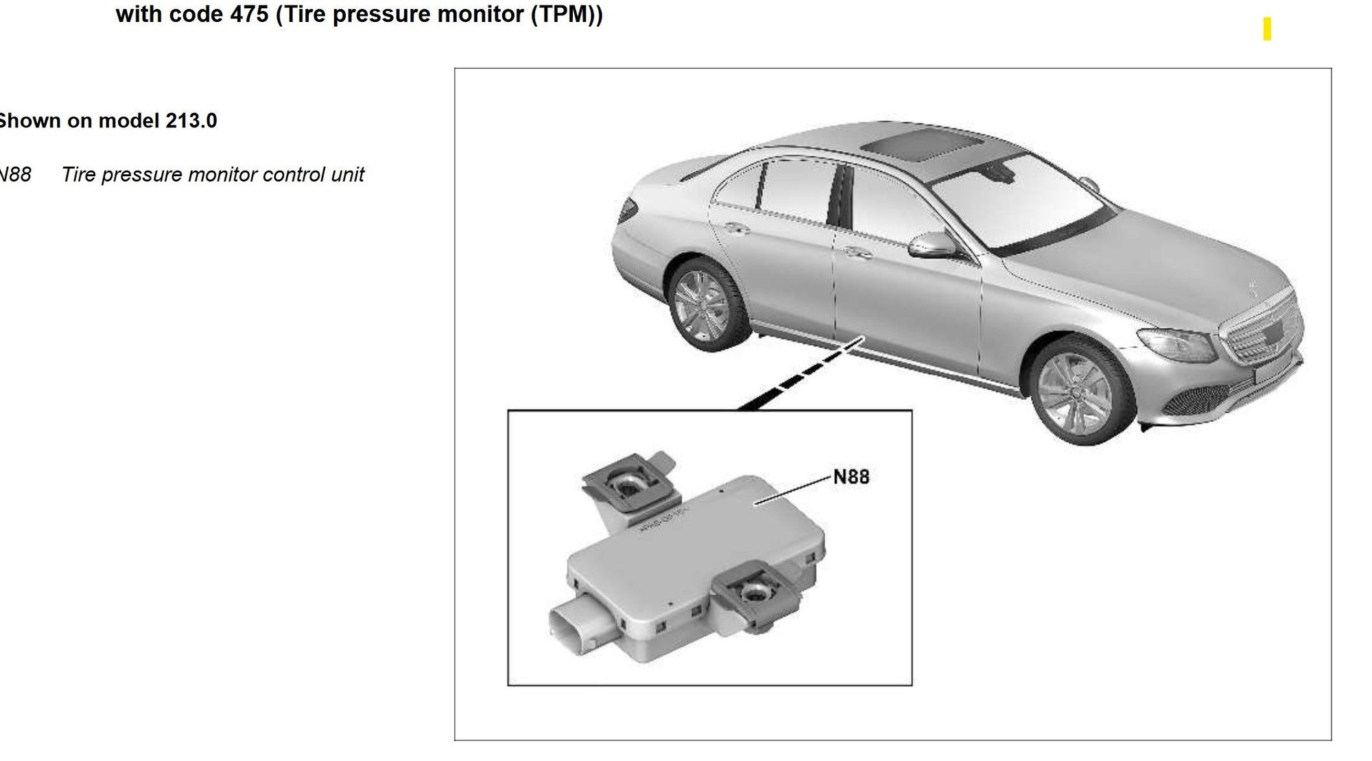

Hey all... here is the E53 TPMS location of the modules or I think any E-Class 2019 and newer, based on my car.
Module location:
Based off of 2021 and Newer
