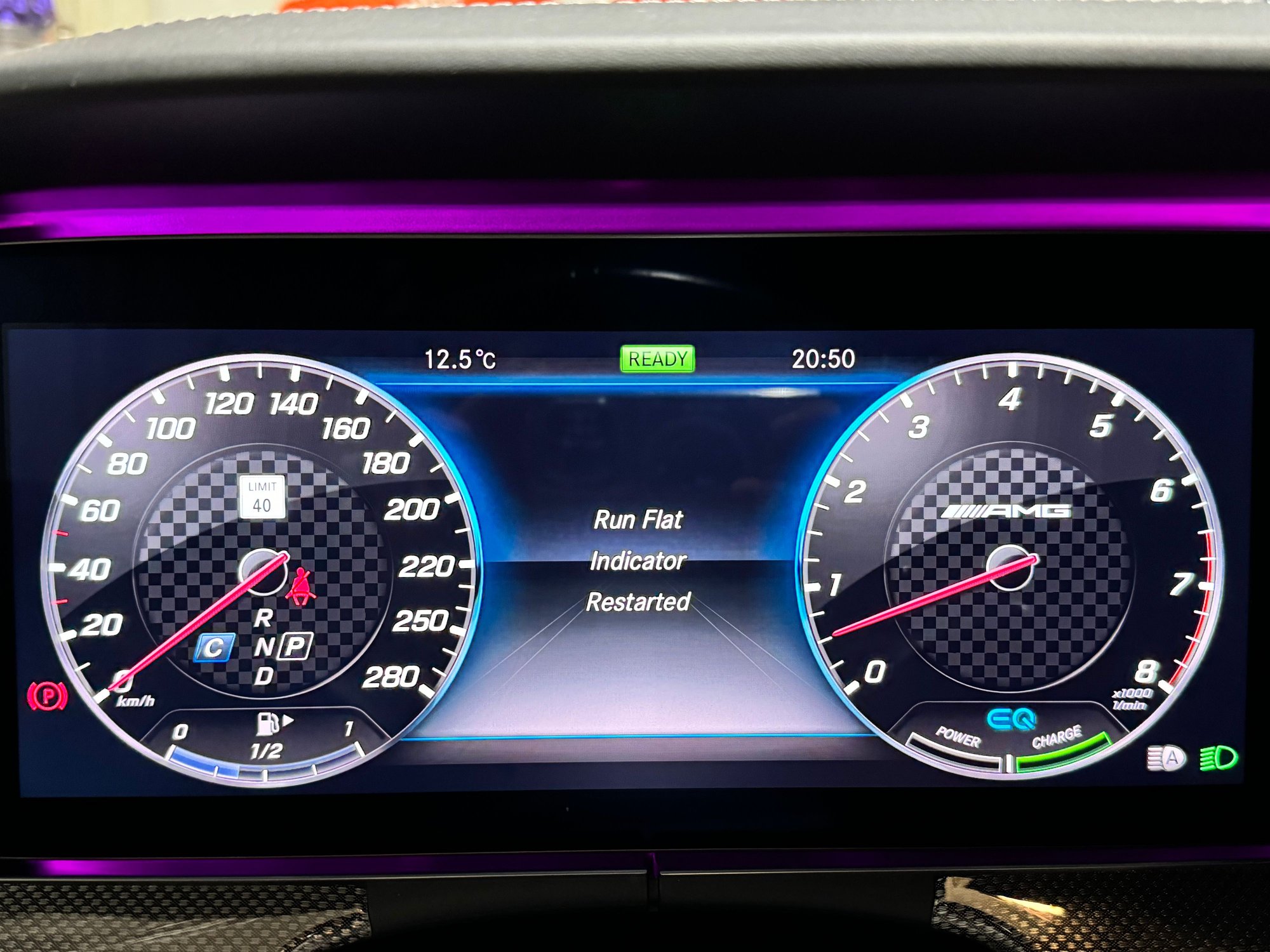

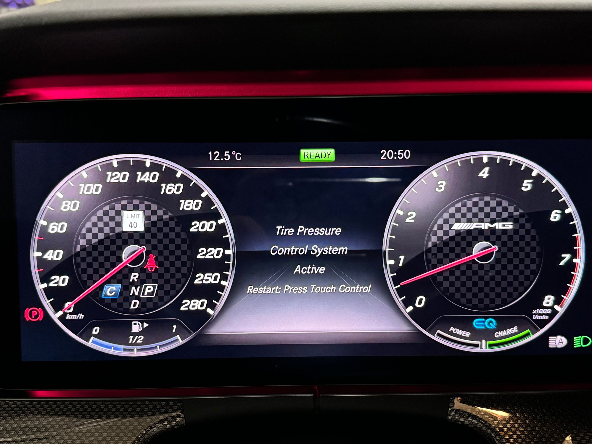

OP, can you post the exact message you are seeing, if it doesn't say Run flat indicator active and just say TPMS active, you do have active TPMS and not passive as you expect at this calibre.
Thank you for the great explanation this is what I have and I even restarted the whole thing but no PSI comes up. I am not sure if there’s a way to install TPMS

Canadian car uses "ABS" TPMS. It counts wheel revs and diagnoses when one is speeding up because its rolling radius has decreased. It uses no wheel sensors and is not as accurate as "direct" TPMS, which is what the US cars use. You can't see individual pressures.

https://cimg4.ibsrv.net/gimg/www.mbw...d454cd24d.jpeg
https://cimg5.ibsrv.net/gimg/www.mbw...23335ad85.jpeg
Yup, your image confirms you have the passive system.
The vehicle is not equipped with active TPMS only passive as mentioned using ABS to determine differences in wheel spin.
That is strange being an E 53 not have TPMS, @Cosworth2000 does yours have passive or active. Even my C 43 has the active system, was this a specific option? Do you mind chiming in please? Thank you.
