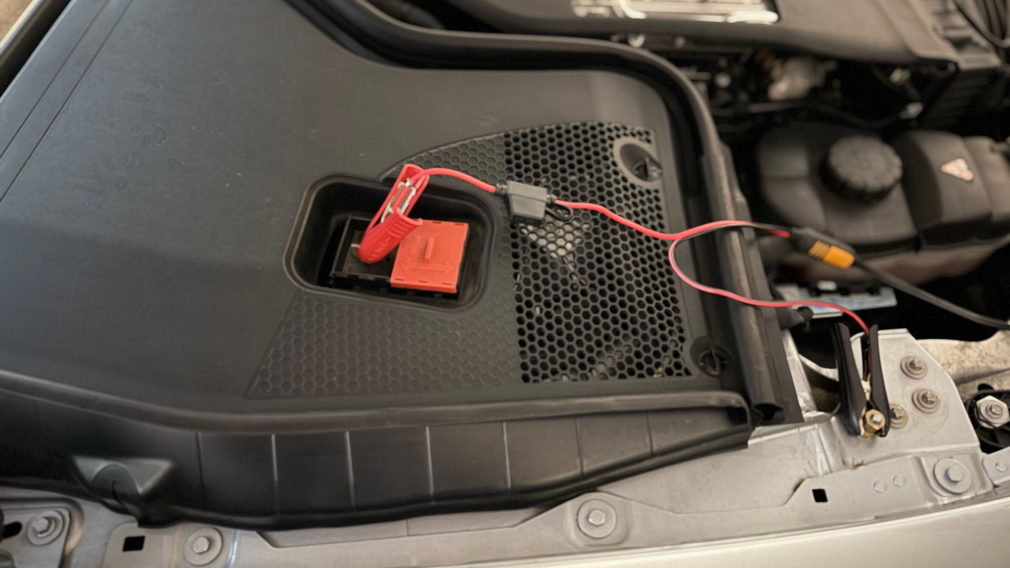

Quote: I picked up a Noco Genuis10 (10amp) to charge/maintain the battery in my S213. Coupled with a their Eyelet Terminal Connector, which I have sticking out at the top of the corner of the hood, means it's super quick & easy to connect when needed without popping the hood.
man, if someone messed with your car and simply popped the top of that connector on a rainy day - short between black and red... that would be a bad day.
Reply 1
Jul 18, 2025 | 12:24 PM
  #52
Quote: man, if someone messed with your car and simply popped the top of that connector on a rainy day - short between black and red... that would be a bad day.
Haha, fair point. It's very rare that the car's parked outside and you'd kinda have to be looking for the connector but good call to tuck it back under when the situation calls for it.

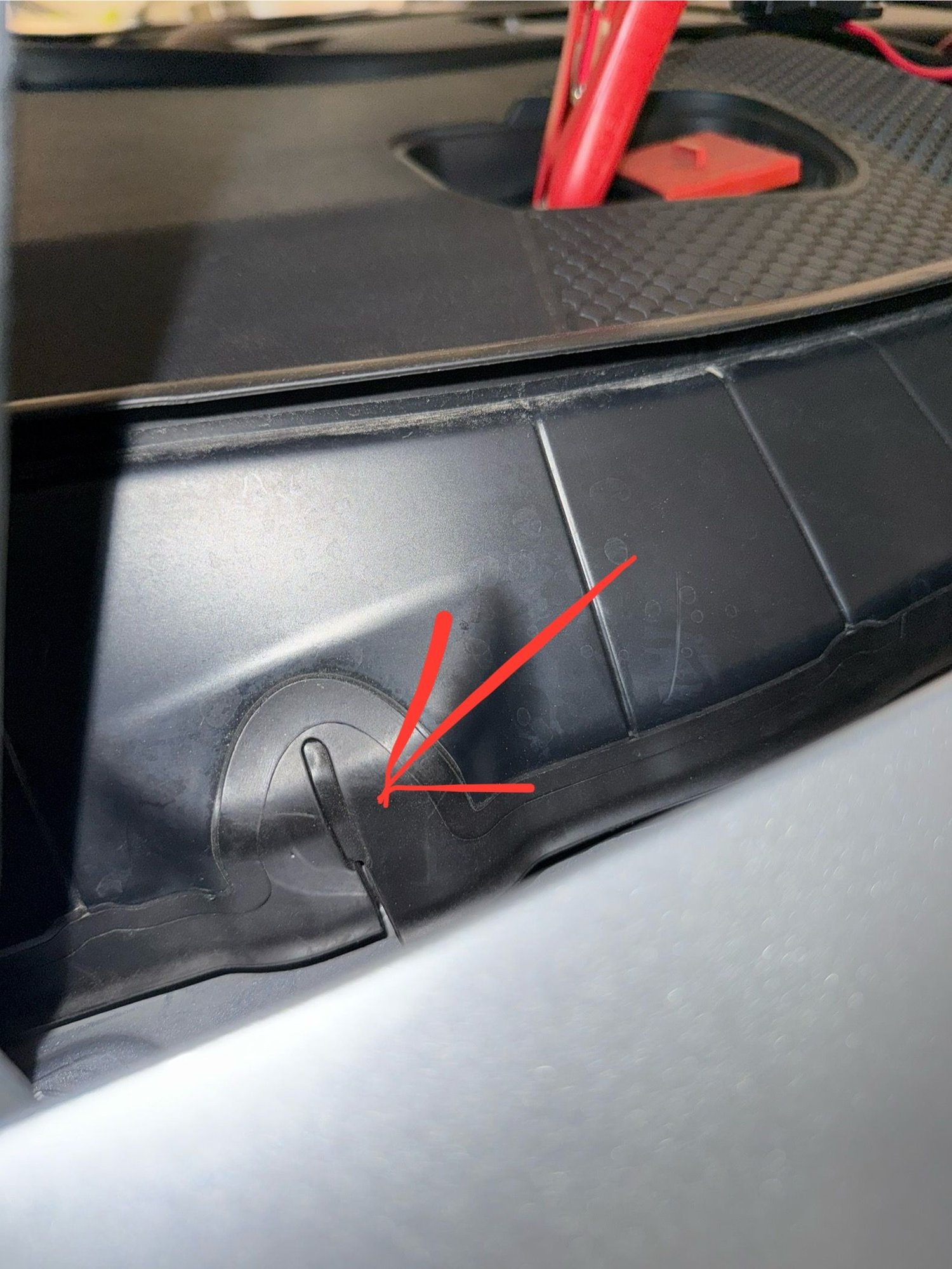

I chose not to use the quick connect even though there’s a provision for one (red arrow). I didn’t want the risk of the positive lead flopping around possibly rubbing and chafing itself or paint.

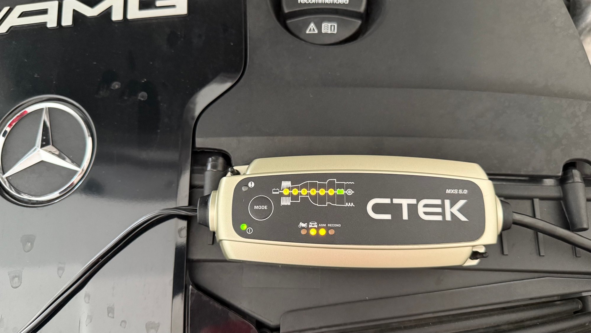

I use the 5A CTEK. You might be surprised to find the battery needs more than overnight to fully charge the first time you top it up. Maybe even 48 hours. This is a must have for these cars.
Thank you I picked up the 5 too and started leaving stop start on. Car wasn’t stopping!
After the first overnight of charging car would stop for 10-15 seconds.
After the second overnight of charging the CTEK finally indicated charged and stop start works perfect. The car can stay stopped for a whole traffic light, the entire time waiting at the drive through window, etc.
I still get a 1 second flash of “12V Battery see owners manual” that immediately goes away itself once in a while so will get it all checked out, pressing the dealer until I get no more 12V errors. The error has always come and gone and I’ve been ignoring it due to alert fatigue. Now it seems relevant.
So far no suspension malfunctions, no reboots! Not going to use CarPlay for another week or two before introducing it again.
Finally charged!
