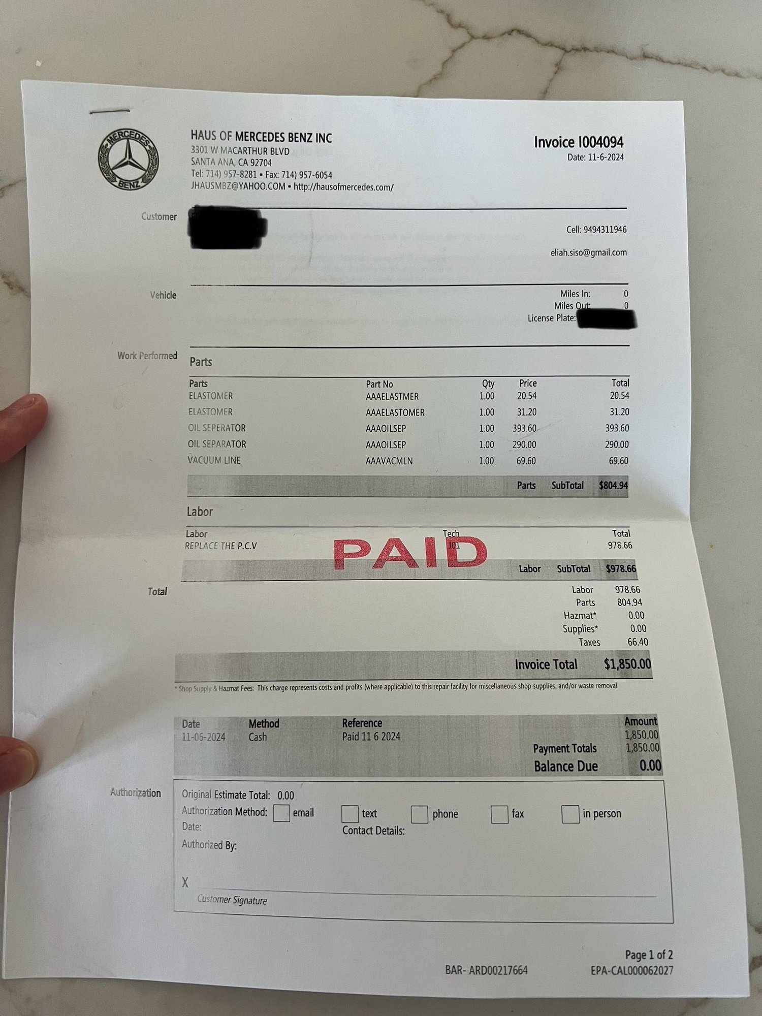

@EilamS3 From my knowledge am I correct that the PCV system is the same as the oil separators? Are the oil separators what you had replaced/fixed to solve the issue? Can you post an invoice showing part numbers of what was replaced when you had that work done? Thank you
yes it is the oil separators, I hope this invoice helps I will say I got a crazy deal so it might be more…
Thank you for your response. You definitely got a crazy deal, I just got a quote for approx $4900 from a MB dealer.
