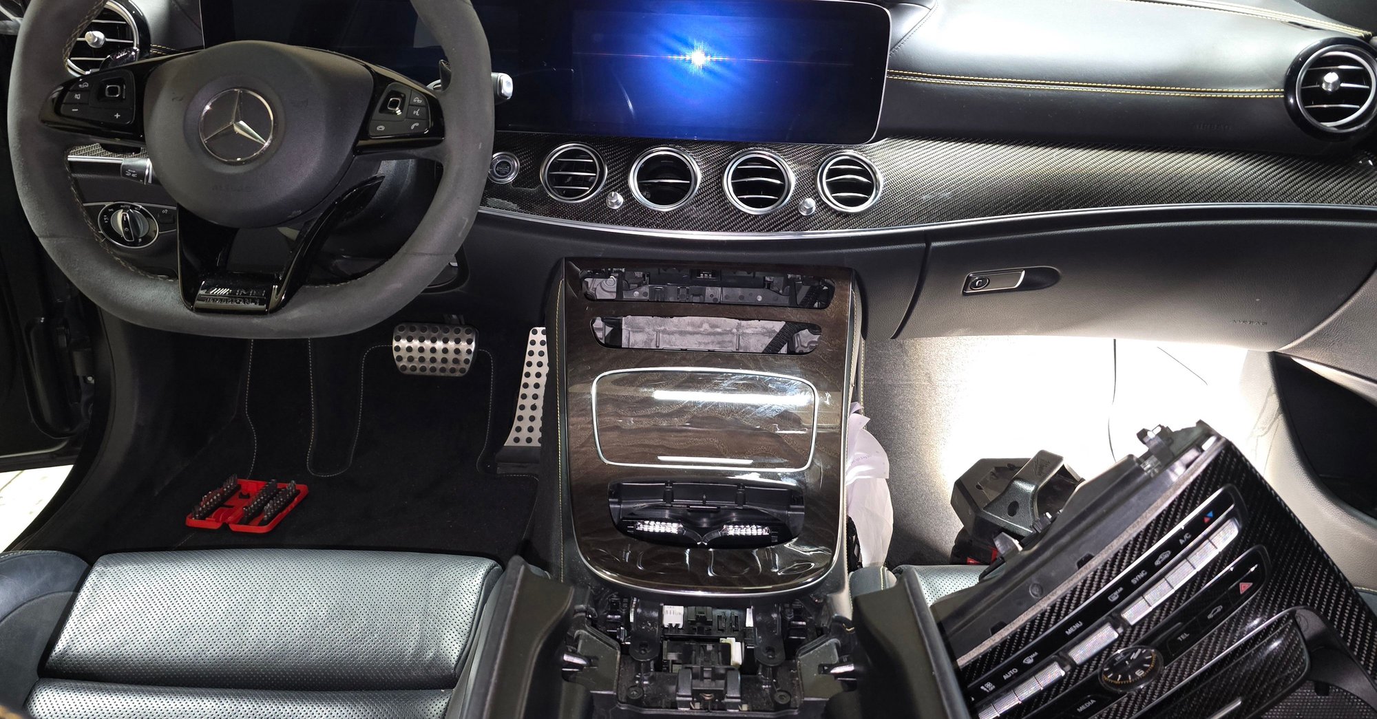

Patient: 2018 E63s Edition 1
So as everyone knows, the Edition 1 (at least in the USA) came with a carbon fiber trim pieces.
So me being the curious person I am, had a face lift center console trim.
So the good news, it is ALMOST a direct fit in the pre-FL 18 E63s.
The only slight modification needed is the vent brace beneath the console, specifically the area circled.
That part interferes with the phone holder/ash tray rear. It is longer by 1/4" / 6.35mm.
So the "modification" is to this bracket. A quick oscillator saw cut.
and the FL panel fits without issue.
Note: I did not put the electronics as I do not have them on hand.
Note 2: The C257/A238 console also fits.
Last edited by figuwx; Jul 30, 2025 at 04:51 PM. Reason: adding info for c257/CLS450

THank BUT
I was doing it to make sure it fits... I put the OE Carbon trim back as i do prefer it.
Kind of curious though, why, I mean do you lose the clock with the facelift? (I should had seen the pictures first)
Honestly, the clocks position is in a real awkward place and when I have the phone connected to the car, i get time there.
With that said. It would not be "difficult" to remove material to allow the clock to fit again.

Originally Posted by zukmeister
I don't think the clock portion will fit either, looks different to me
I'd love it if you could add clock to the facelift, man that would be fantastic
both the pre-fl and FL have the same spacing between the clock portion and the top climate control...
the BIG difference is that the FL center console does not have the rounded cut out for the clock which is a quick grinder/hole saw away from fixing.
