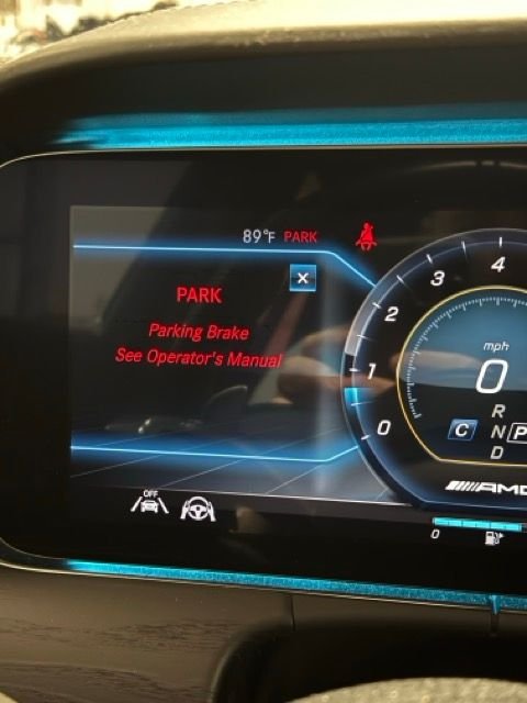

My car is stuck in the garage with the parking brake engaged, the red "PARK" light blinking on the dash and a "Parking Brake See Manual" message that when canceled out, will pop back up when I shift from D to R to P, etc.
I disconnected the battery and reconnected it, to see if that cleared the issue...it did not. The remote started the vehicle and peaked inside to the dash and saw the error + blinking "PARK" was still present.
Any other things to try here? Pic attached below (the PARK is flashing and not solid as you will see it in the still image).
