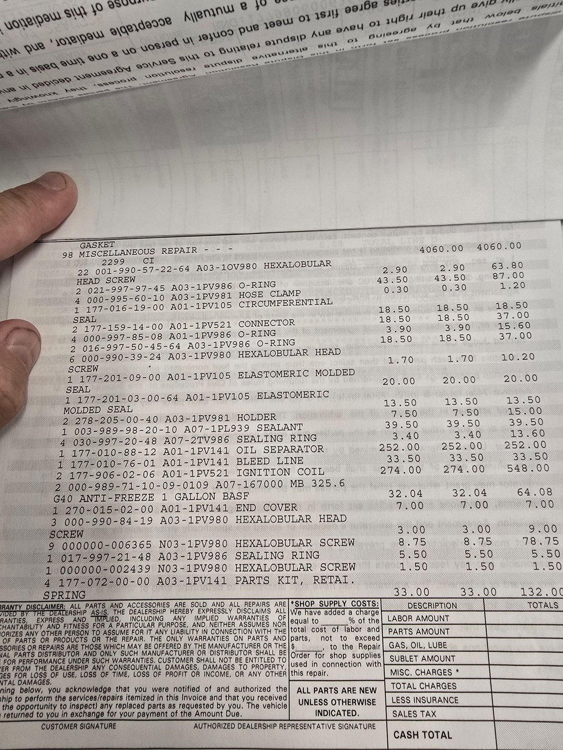

Okay. Here is the update. I have redacted the my personal information and my SA. Like I said, my local MB has always been amazing.
OVS were replaced. I bought one and my warranty covered the other. Service Flex A, Spark Plugs, Two Coils, a couple of connectors.
Warranty covered most of the valve cover R&R and other things.
