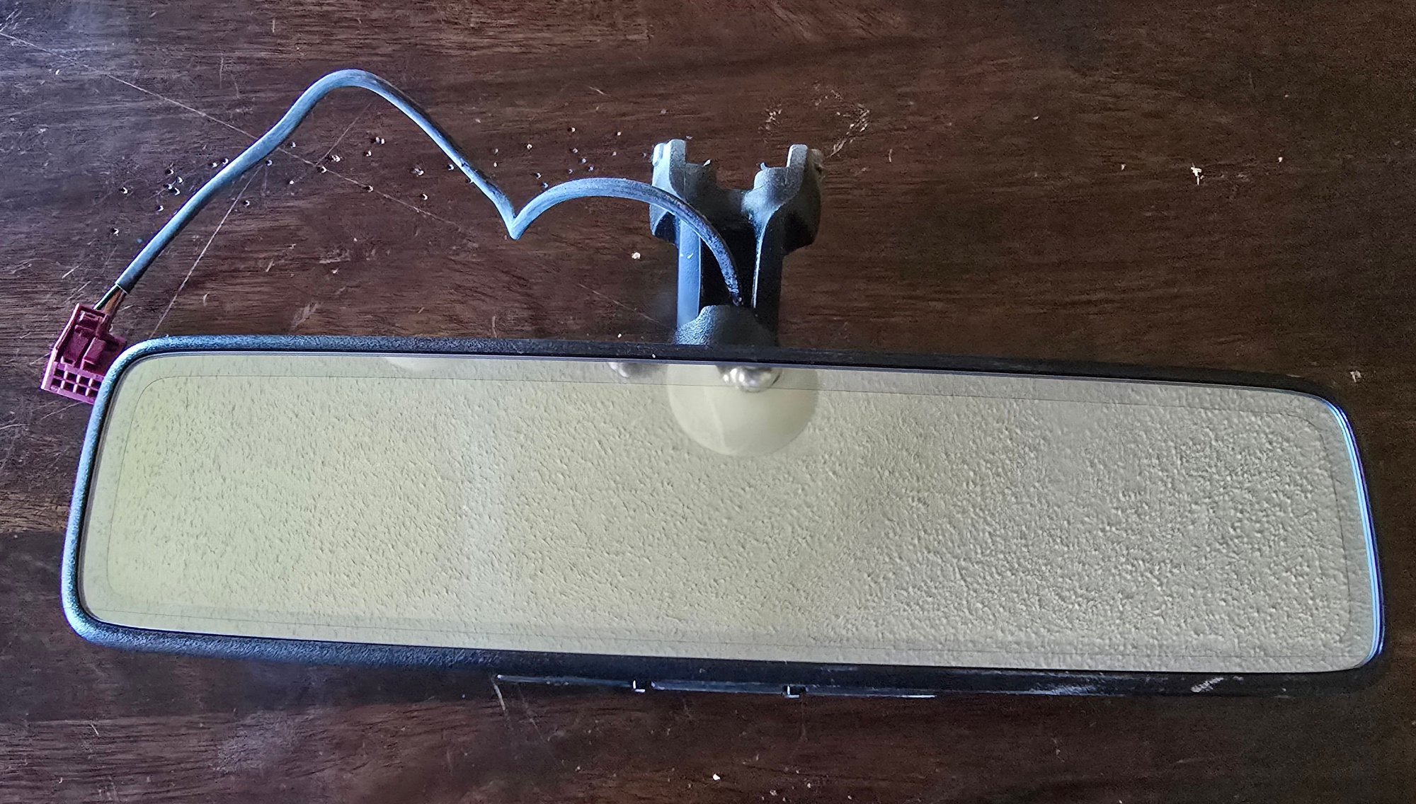

Tech: FL W213 rear view mirror
Patient: 2018 E63s Edition 1

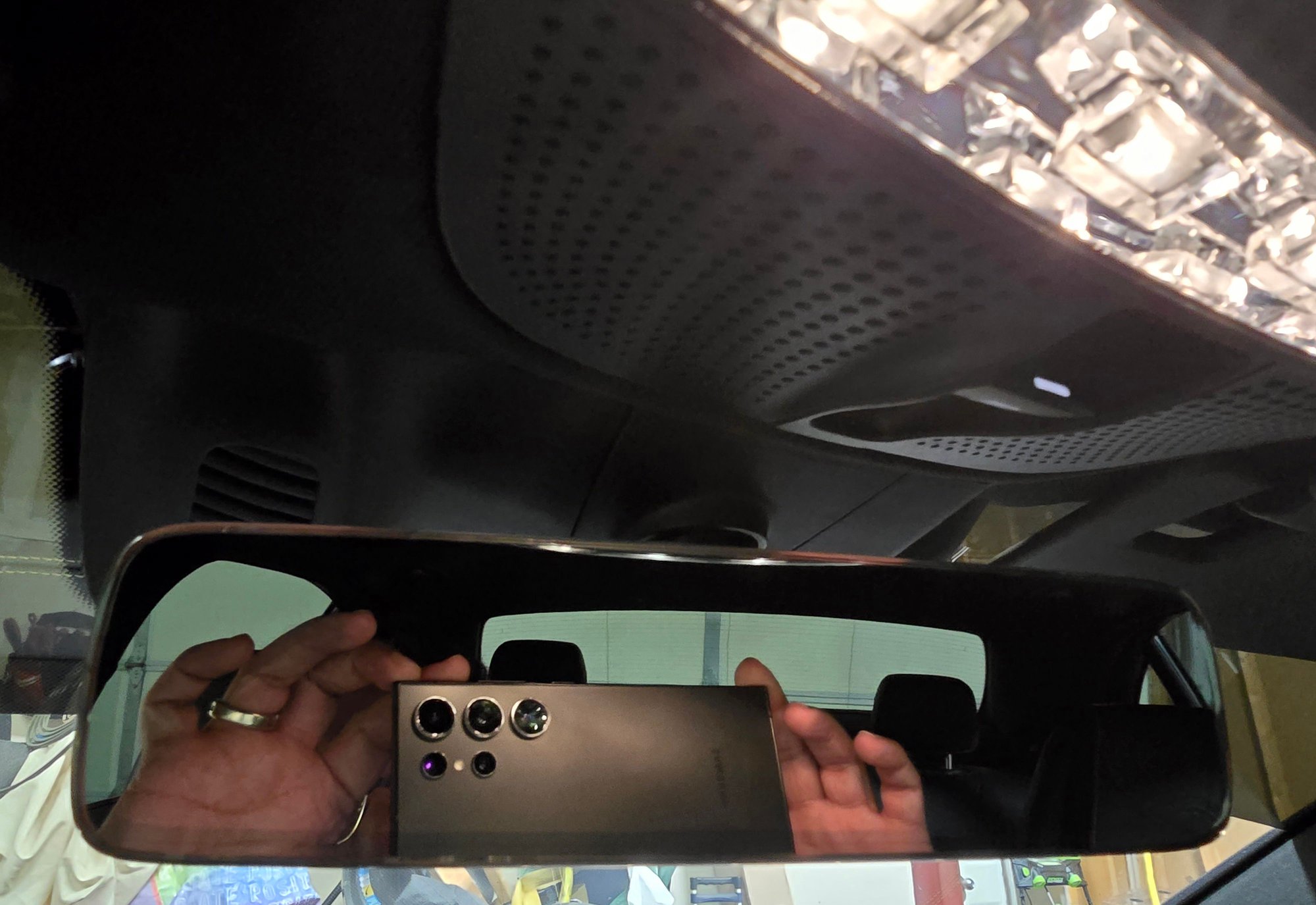

What: Rear view mirror
Why?: The rear view mirror was lose and vibrating a lot while driving (bonus: the newer FL mirror has more mirror, ie no thick borders.
Issue: once replaced, the mirrors garage door opener did not store the "garage key" after shutting the car down and turning it back on.
Fix: The Garage door opener (A67n2) must be initialized to the overhead panel.
Reason: The over head panel is tied to the EZS (Ignition module) and it essentially learns the new garage door opener.

2018 AMG E63s Ed1
Update: So long story very short.. it did not work.
The Garage Door Opener communicates with the Front SAM and there is a security key that is negotiated by both. This requires Xentry/DTS Monaco/Vediamo to get negotiated to allow GDO to work correctly.
