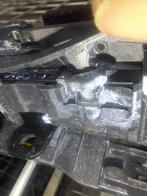

as I've been looking at the sunroof fairly close up trying to determine the situation and what could have failed, I've noticed a fair amount of plastic pieces that would have a fairly significant & very frequent heavy load on it, making me wonder why those aren't manufactured in aluminum or something else capable of withstanding a bit more load, weight, moving action . . . likely weight saving measures but its not like the car is a featherweight to begin with . . .
in addition to tensile strength of a particular material, I'm sure they had to consider that vast temperature changes that the sunroof goes through exposed to sun that exposed to the elements in winter, and had to consider expansion contraction principles when identifying the optimal material to make some of those parts.
Certainly, yes this could be a cost cutting measure, but what you're describing in the
W-213 AMG is just not a very commonly reported problem on this forum or the non AMG 213 forum
maybe we are just back to bad luck.

Latest update: got her back home and what they found was the left and right panoramic roof rails had a broken mechanical actuator and were binding, the motor needed replacement too due to excessive wear from binding so that was all replaced:
A 213-906-74-06 Gear Motor
A 213-780-38-00 Frame Segment
A 213-780-28-00 Sliding Sunroof Component
A 213-780-27-00 Sliding Sunroof Component
I inquired about Goodwill and was explained that given the cars age and mileage that is not really an option, however they were able to give me a small 'discount' bringing the total down a bit compared to the original quote . . . there's also a 2 year warranty on parts and labor since it has been performed by an official dealer which will reduce the worry a bit for the near future . . .
