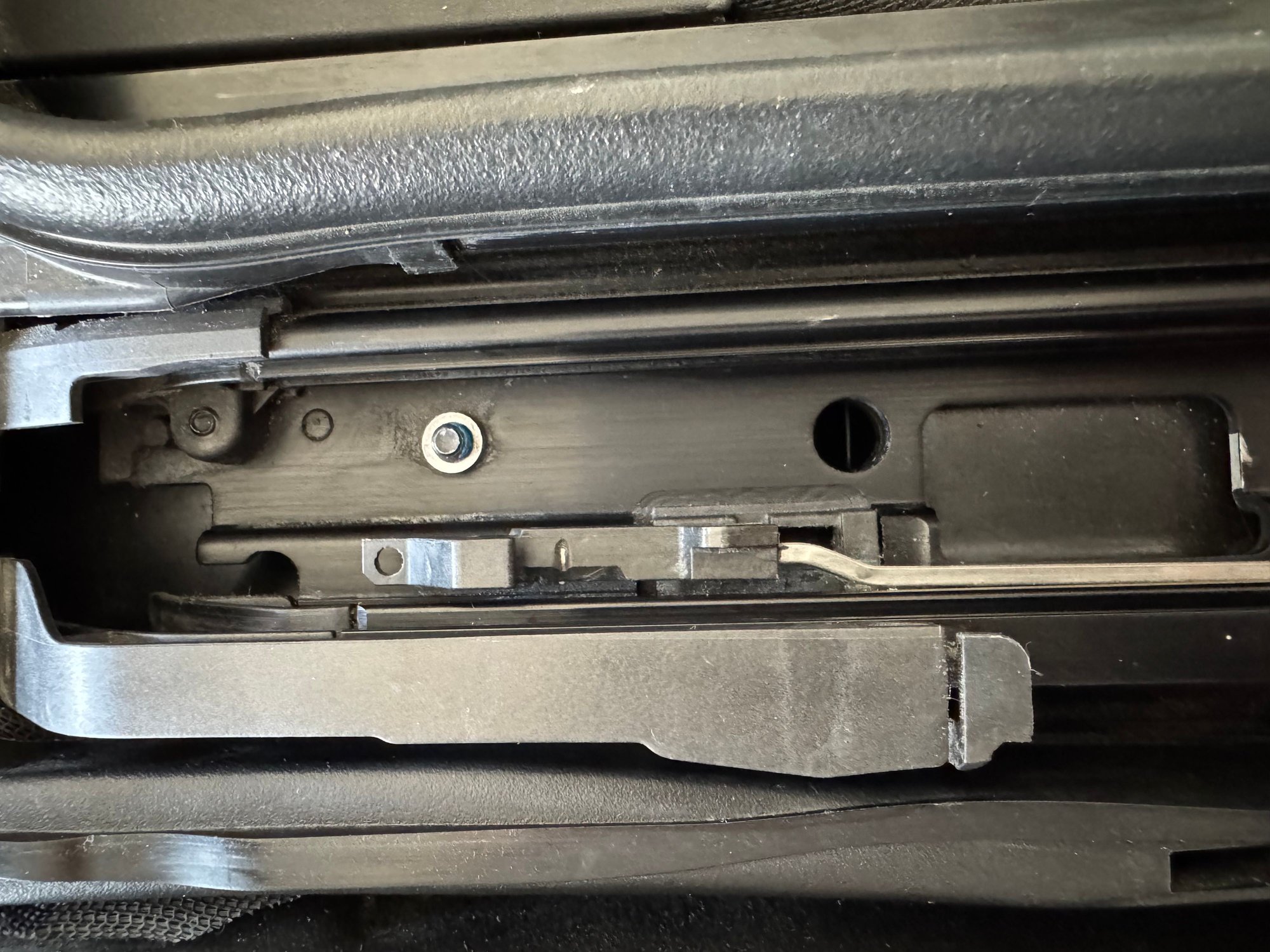

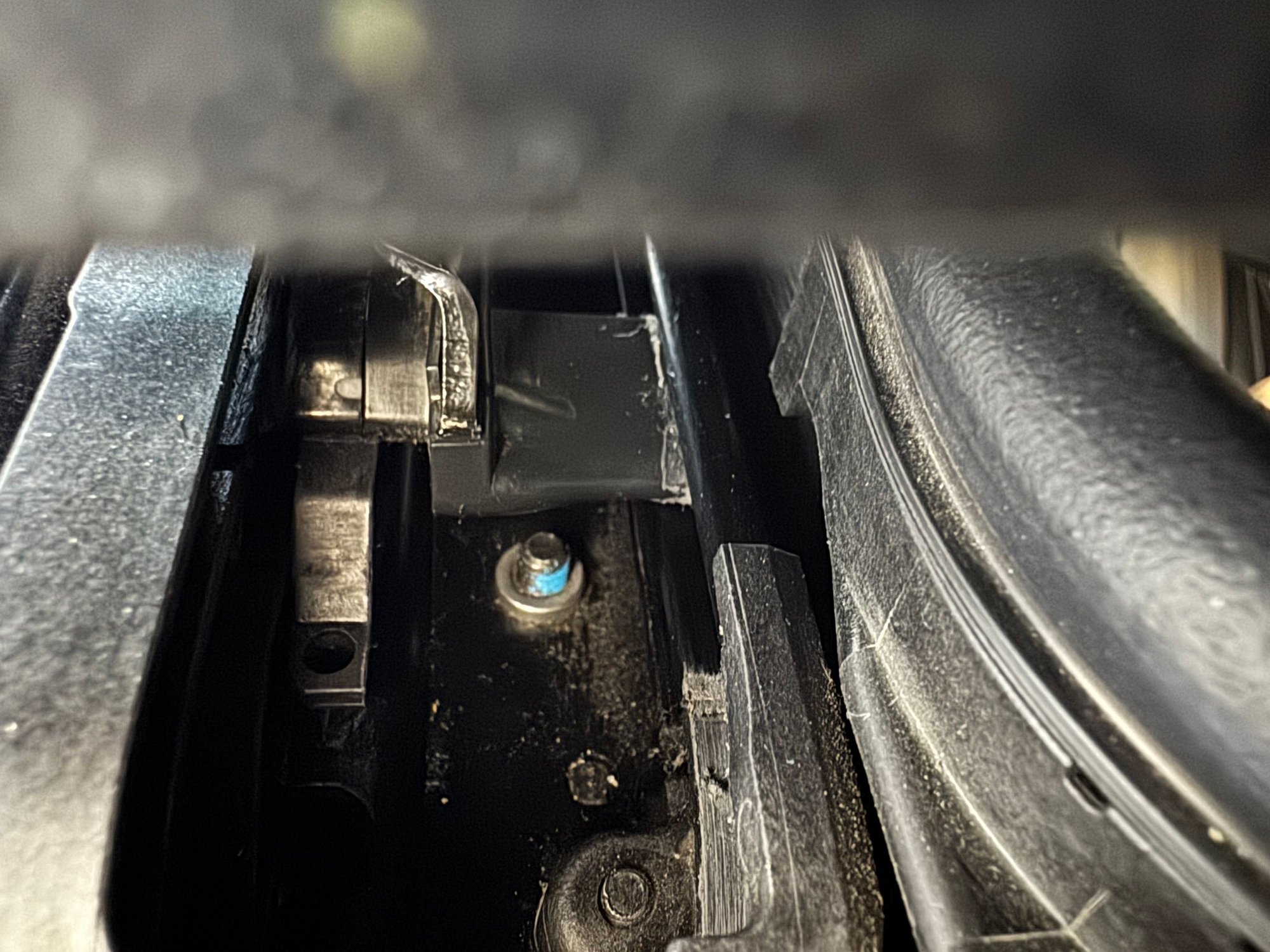

one thing I just noticed is on the drivers side, I closed it as far as I can go before activation and the driver side is 'hooked in' where the passenger side is not. I was able to operate the slider while watching and the moment it gets close to closing, the plastic hook goes up on drivers side and prevents it from closing all the way. I imagine that's the pinch safety mechanism working . . .
passenger side
passenger side
drivers side
drivers side

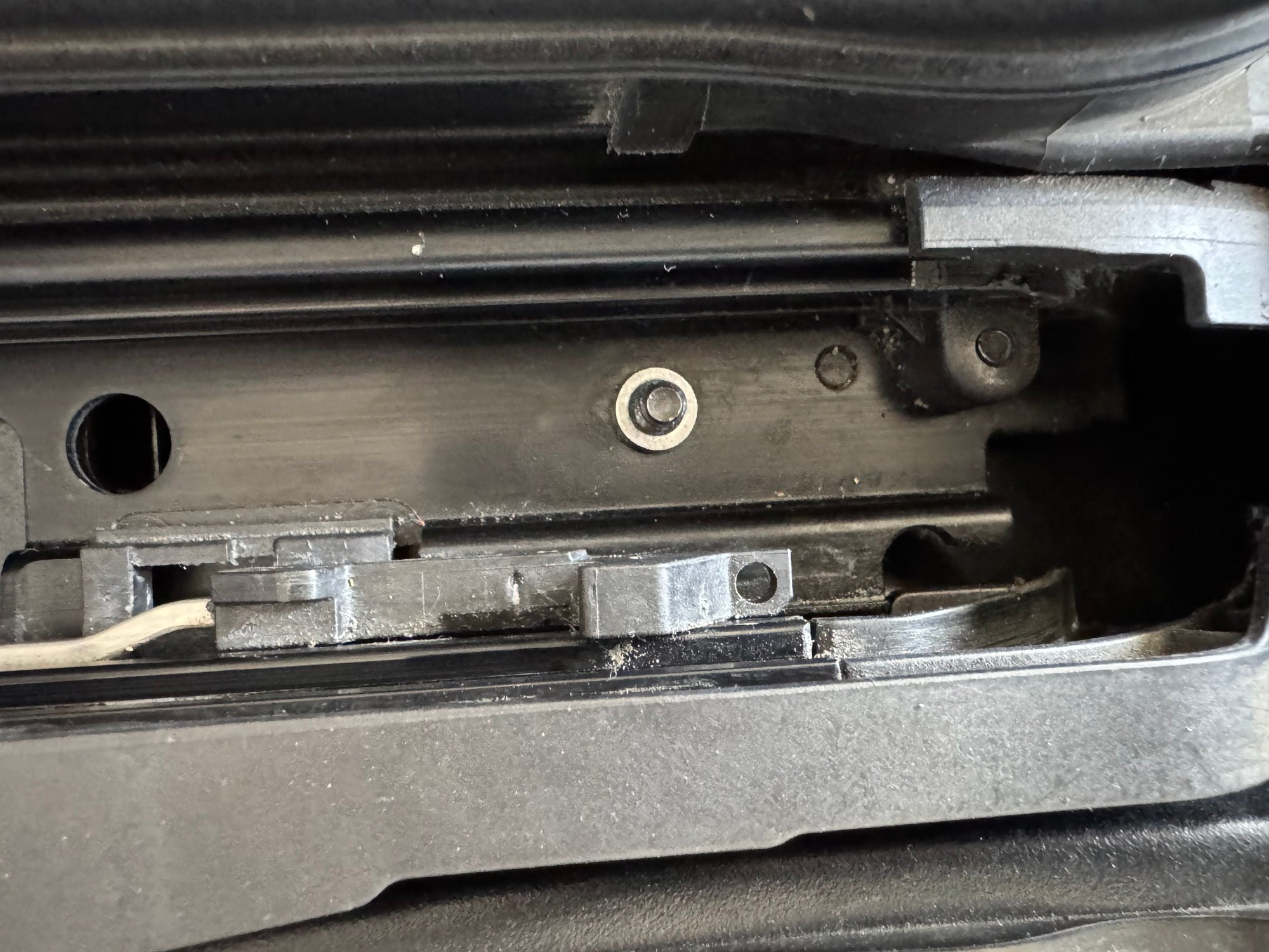

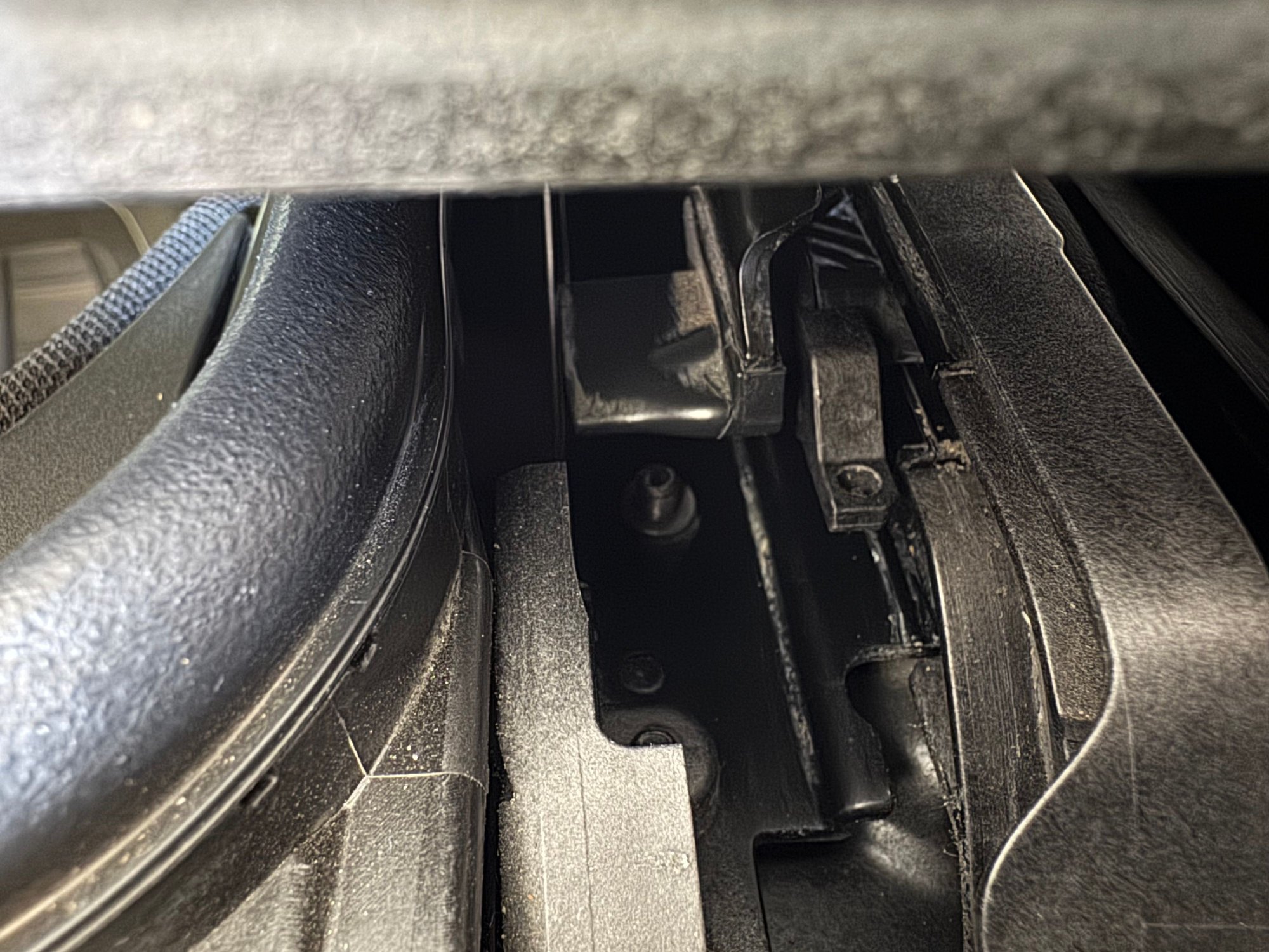

drivers side - pinch mechanism engaged
passenger side - no restriction

This I believe proofs that the pinch mechanism is indeed the culprit but I know not how to circumvent that, likely a dealer/computer issue . . . it just doesn't make any sense that the pinch mechanism is engaging as there is no restriction whatsoever. At least not visible . . .
maybe somebody with the same vehicle could look at the same spots close up and compare? One thing that I can't get over is the little lever that pops out when nearing closing which likely is connected to (or is) the actual pinch mechanism, where should that little lever be positioned when it comes out? Underneath the metal rod, above the metal rod or on the same level?

Can this hook be depressed so the thing closes - like last minute push on it downward before the sunroof full closes?
Old Oct 9, 2025 | 02:37 PM
sixfive's Avatar
Joined: Apr 2004
Posts: 293
Likes: 82
From: Idaho
'19 E63S
haven’t attempted that but I doubt I’m able to push it down because the small lever underneath which I assume is part of pinch mechanism keeps the hook from going down and not engage the roof
