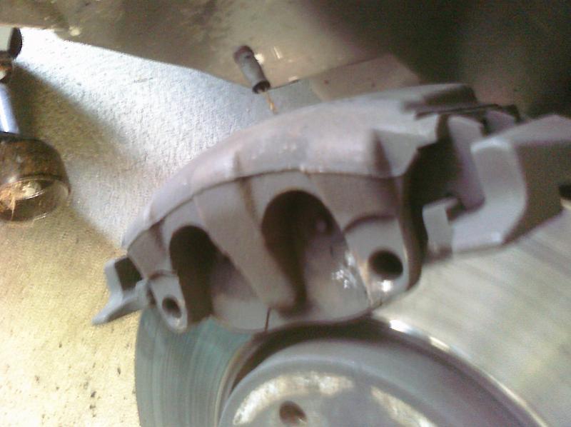

brakes - starting with the front drivers side wheel - (since I had that tire off for the air compressor) - I started to take off the caliper.
You need an 18 MM wrench and socket to take the GUY off. Tap the wrench once it is on - dont worry about hitting it abit.... get it loose and your on your way. There are two bolts on each caliper.....
I purchased on eBay a MB brake pad spreader - $13.99 - which worked wonders. I used the spreader to open the pads.....and POOF - it was off.
YES - buy those plastic strips that tie (sort of circle thingy) and attached to the top part of the wheel well - the caliper so it is easy to work on - and not have it dangle.

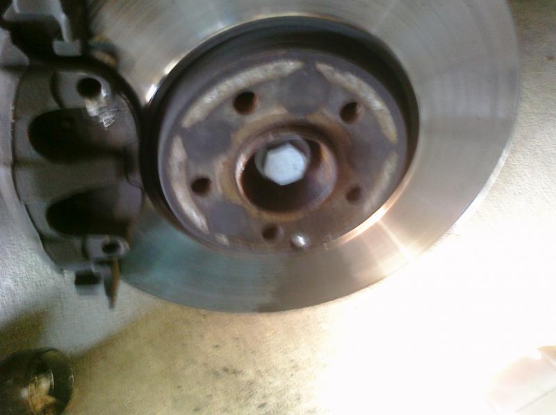

Then - onto the rotor. there is a small hex nut that is used as a guide for the lug nuts and holes on the rotor - hopefully you know what I mean. why that is there? I have no idea....becuase that little nut is a bugger to get off. On three of the rotors - I had to drill that little bas%$#d off - ??
part number 220-421-01-71 parts.com $4.00) for that nut FYI
Once I got them off - I used a hammer - to tap the rotor loose. This worked wonders - much easier than I thought.
I tired to take really good pictures but they did not come out that well - i will try to add pictures over the next couple of days...
Anyway - adding the rotors - again very easy. I purchased new rotors and pads on ebay - both front and back - total cost for the package was $390.00 - not bad considering they want $1,200 at the dealership.
Using the pad spreader - very easy to replace the pads and slide over the new rotor....re attach - then onto the next wheel.
Total time for the brakes was about 4 hours.....I was getting tired and no beer around.....
