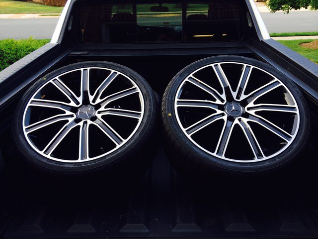

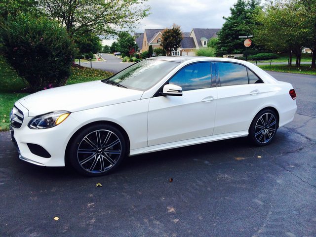

Attachment 446143
Attachment 446144

Which specs wheels are these - from post #1 or post #8? 245/285 tires? Looks like from post #1 based on specs since these are CLS accessories wheels.

post 1 and 245/285. Fitment is perfect in the rear.....front is a little outboard for my normal tastes but its not bad. 8.5ET42-45 would be ideal.
