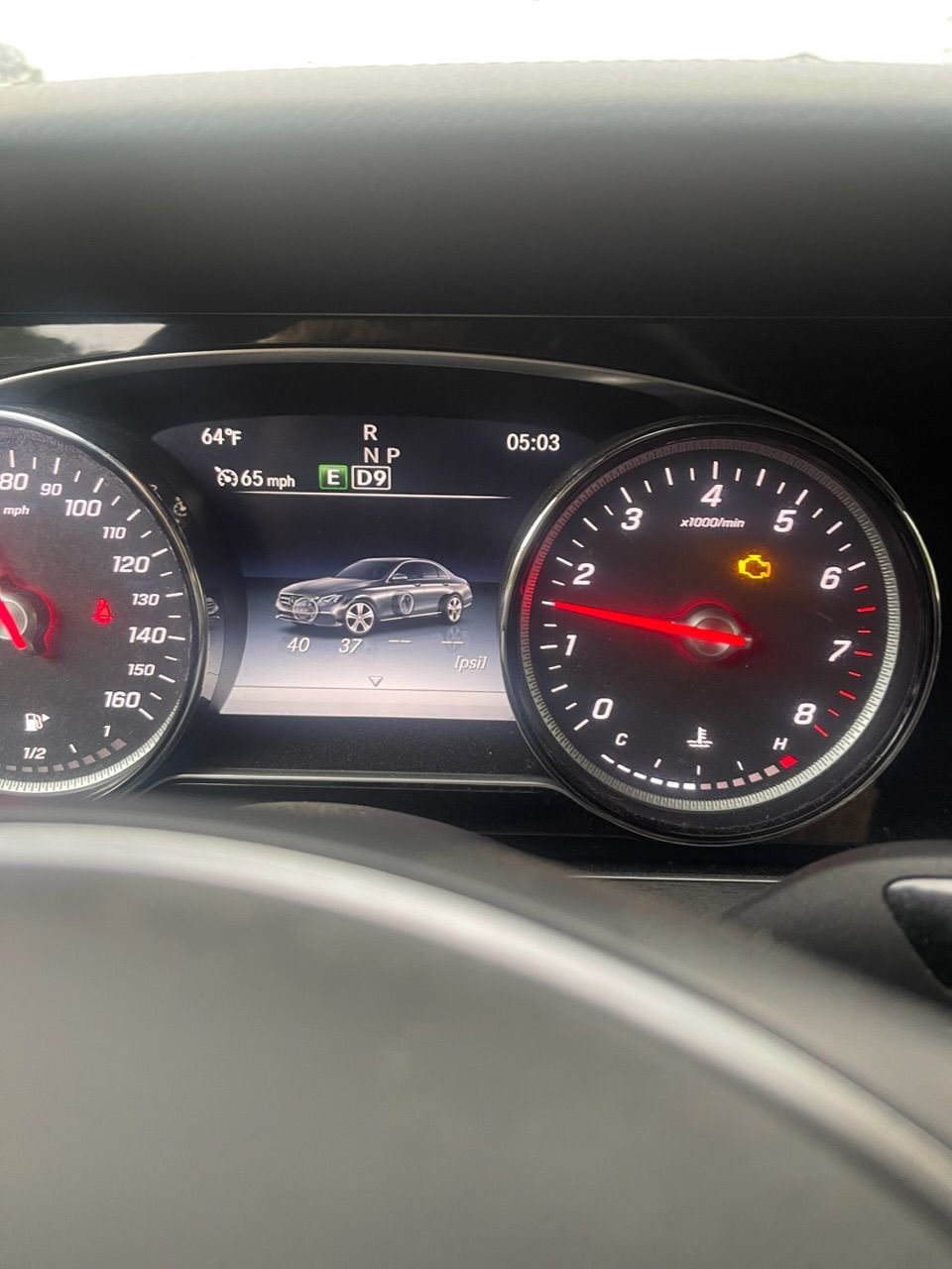

I got new Schrader ez-sensor tpms installed in a new set of wheels. I was doing the TPMS reset and after driving 10mins I got the above "tire pressure monitor inoperative- no wheel sensors" error message. Now no matter what I'm unable to do another reset..I've tried everything, am I missing something? Is this something only a dealer can reset now?
Anyone have this issue before and gotten it solved?

may need a TPS scanner tool to reprogram.

That was my only thought too..going to local tire shop today to see if they can remedy

Tire shop was unable to read sensors, they suggested I try MB dealer

well what I did was sit at the active screen for 20 mins while driving
two front sensors started reading the rear not reading

i ended up replacing the sensors with new ones. #ProblemResolved
