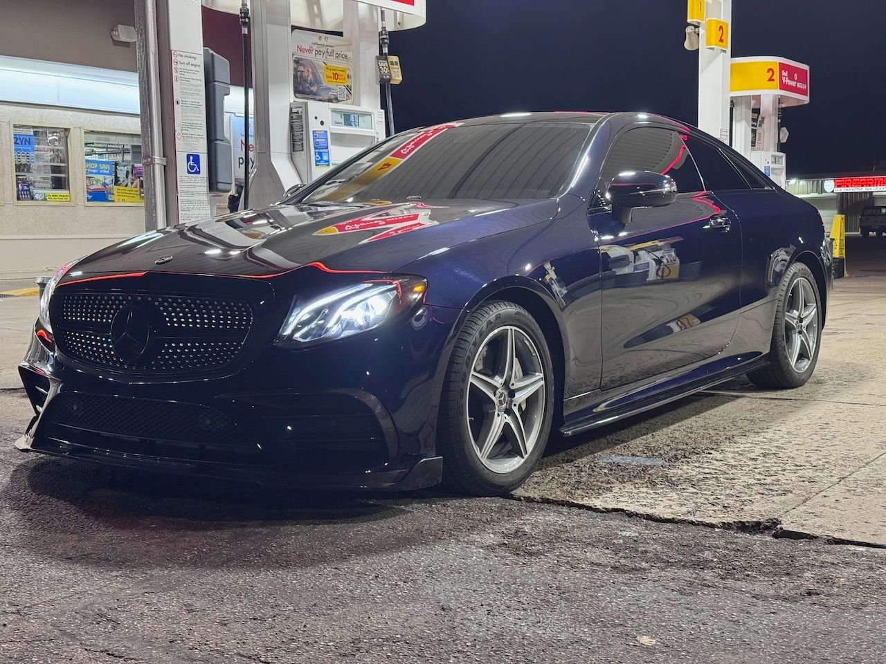

I’ll be doing the exact opposite. My 2019 E450 4MATIC Coupe came with 245/45-18 on all four corners. I just purchased (waiting to pickup) 245/35-20 for fronts and 275/30-20 for the rear. If you haven’t already bought your 18” wheels, I’d consider trading you, depending on where you’re located. I’m in Indianapolis. I’d put all-season tires on your MB Rims, and keep my aftermarket rims with performance tires.
Last edited by FELON181; Mar 27, 2025 at 09:07 PM. Reason: Adding pic of factory 18” wheels
