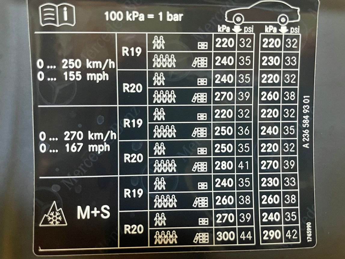

Someone sent this in another thread. Finally 35 front and 32 rear for me since it's only two of us.
Thanks!
