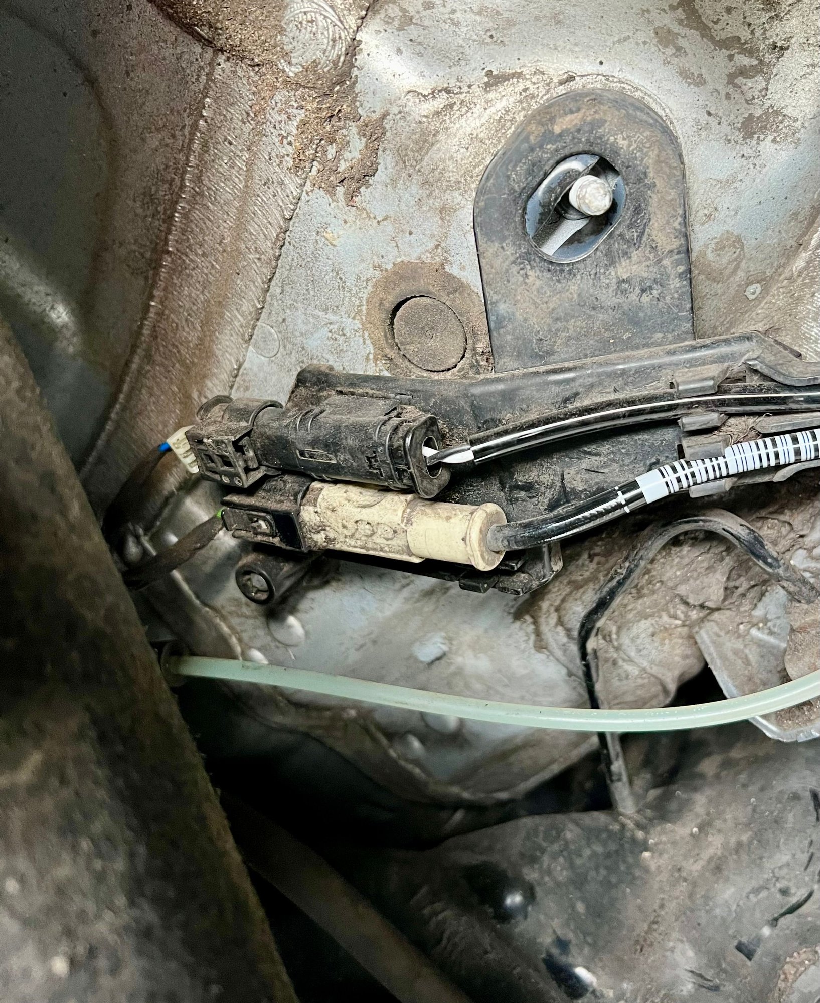

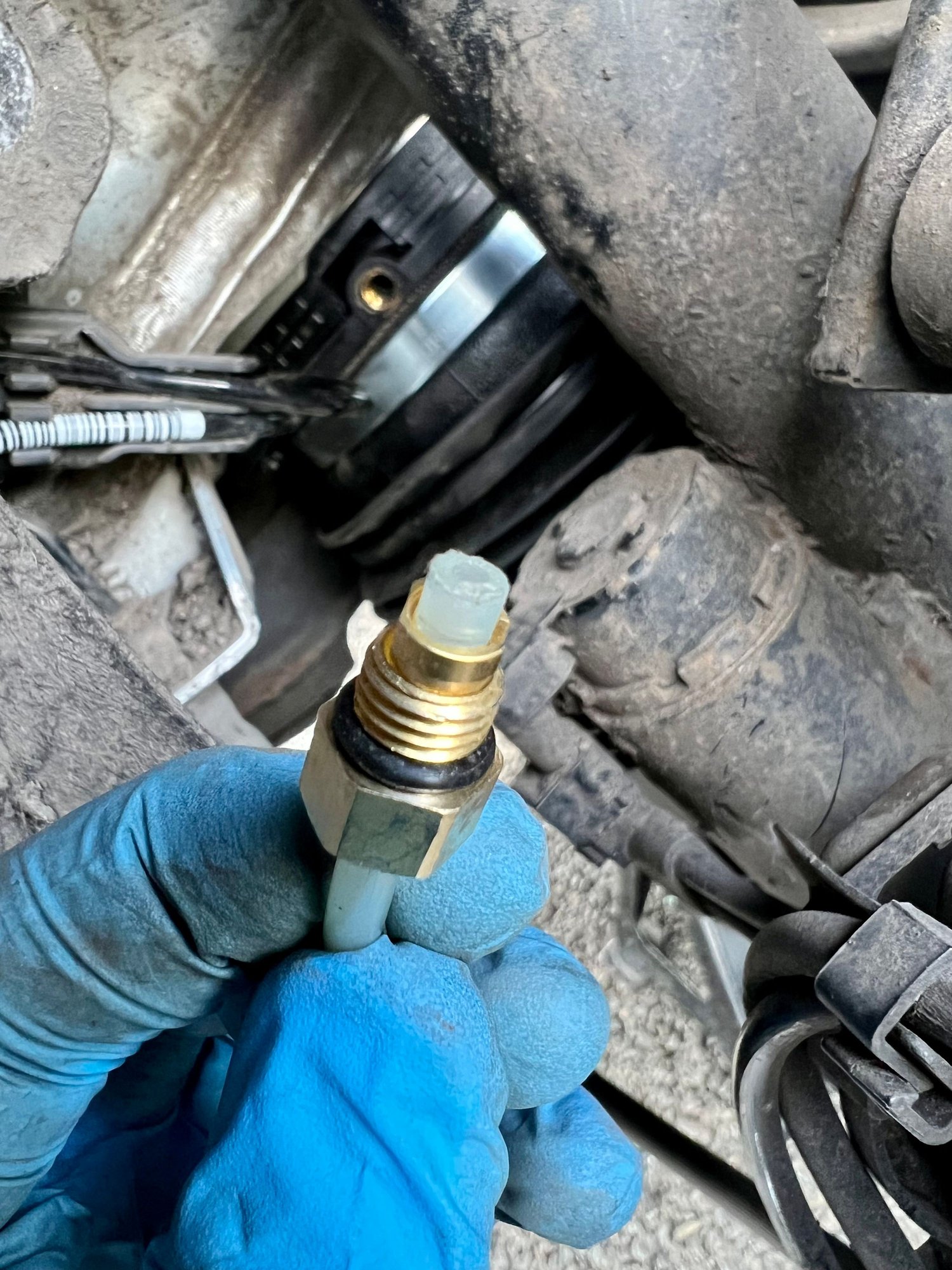

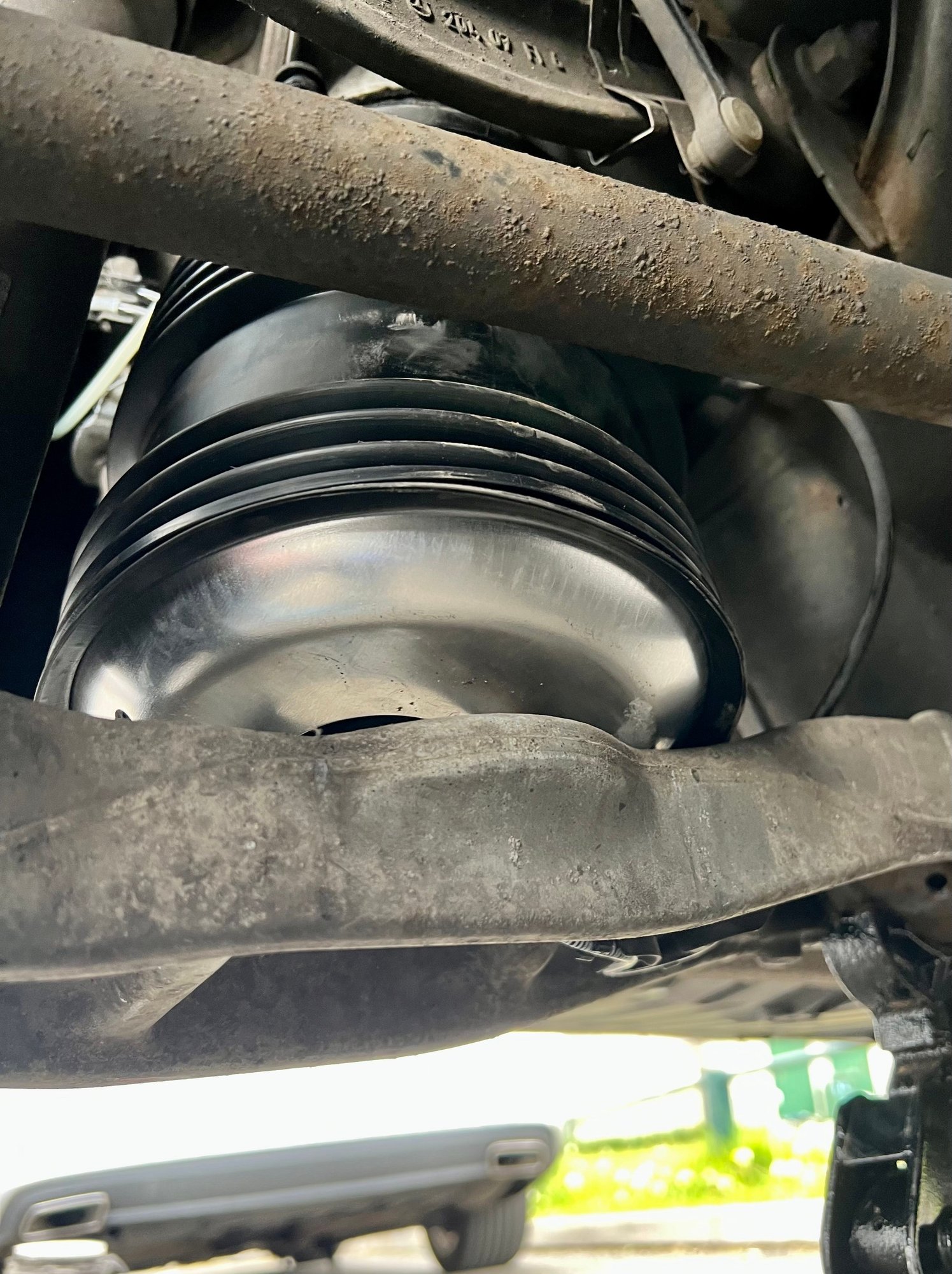

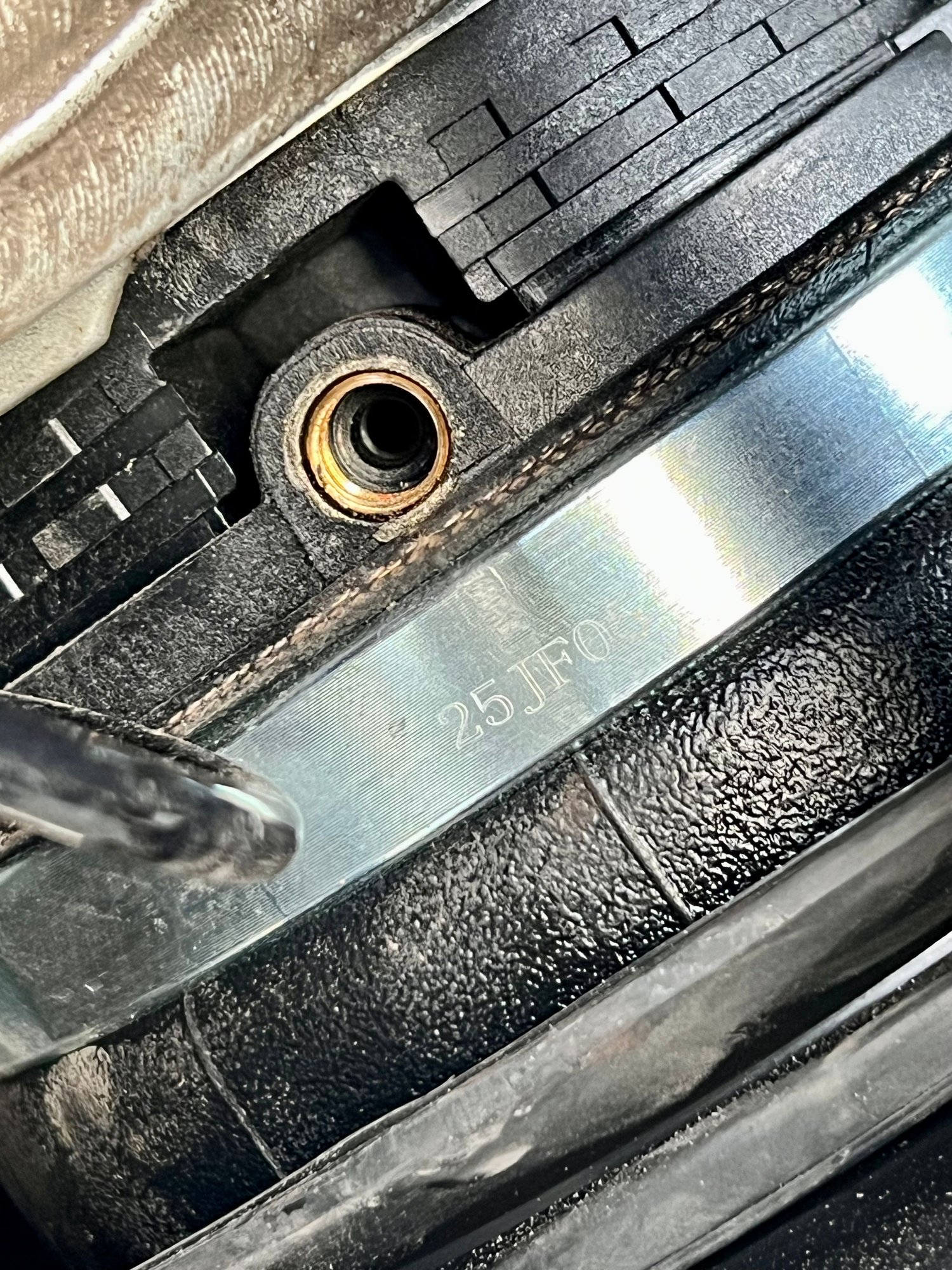

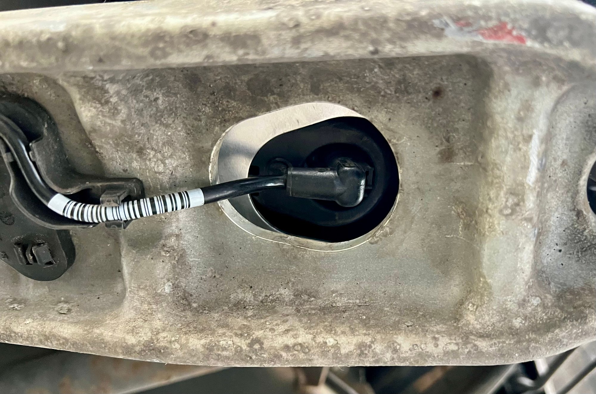

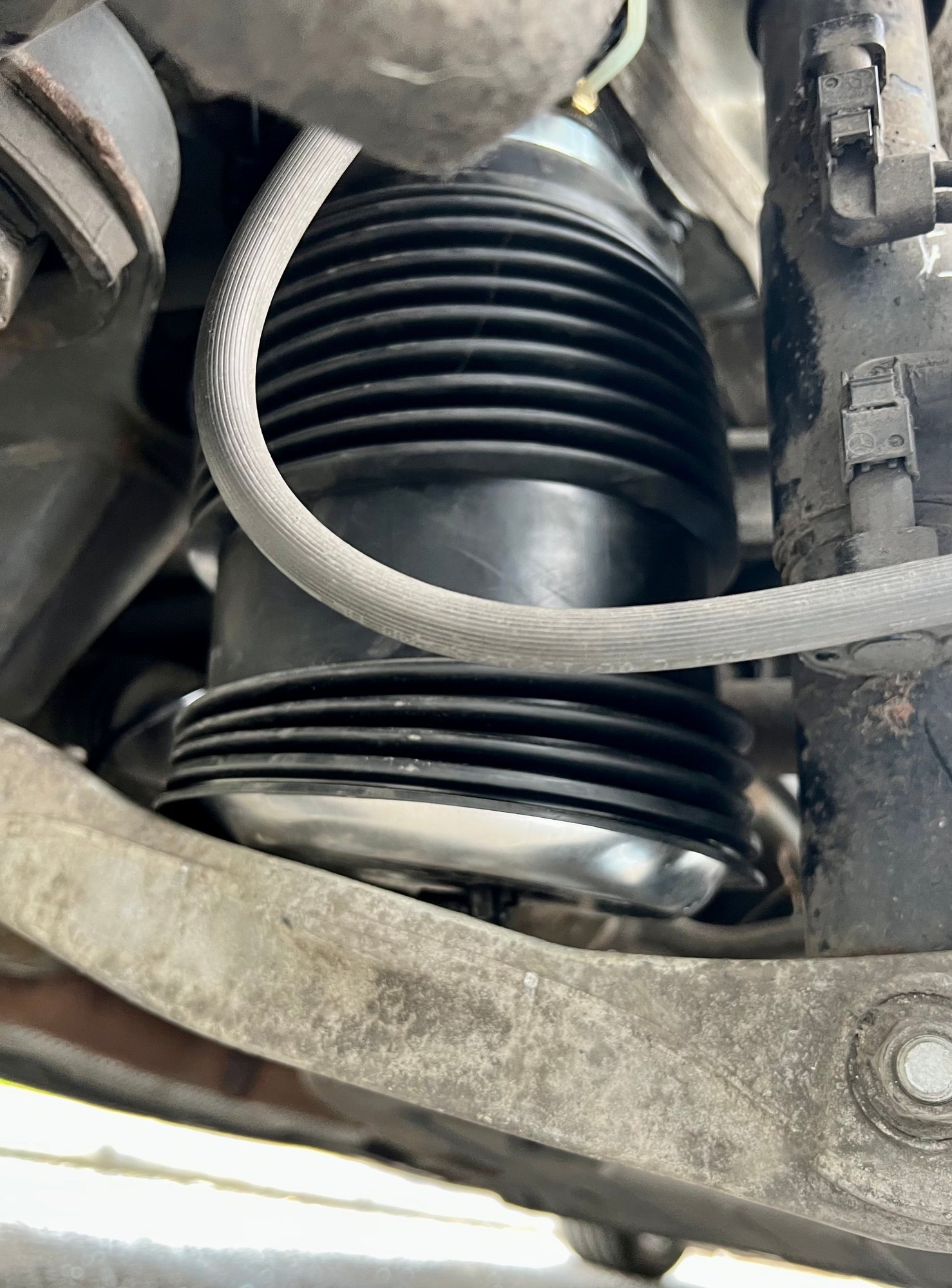

Hi All, My E350d rear driver's side suspension was losing air quite quickly intermittently but always holding up when running. I decided to replace the airbag. After replacing it the new one wouldn't fill, everything was positioned and connected correctly and the car displayed the 'vehicle rising' message that I had seen numerous times but it wasn't moving.
When I tried to fill it manually (Rear Right) with my iCarsoft 3.0 it went up to 27 bar I believe but still no movement, I tried this twice but afterwards the fuse for the compressor blew. I have ordered a couple of new fuses but wondering what the problem could be?
