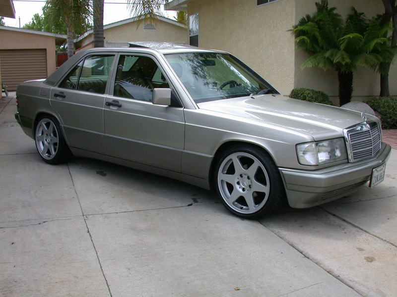

I found a 1990 MB 190e 2.6. I think I should have it this week. I think it's smoke silver. its the color of the two toned mercedes in the pic. Does any one know the top color and the lower trim color codes?
It has Parchment leather interior. The drivers door is separating. how easy is this to fix or where can I find a new door. The interior looks brand new.
I am planning a few mod. like painting the black bumper trim the same as the lower half of the car. and clears on the front markers. much like the car i posted below.
Also I want to change out the rims. to 17'' or 18'' mercedes rims. I do like the '98 clk rims on the solid color 190e . Its funny i think they look horrible alone but love them on the 190e. Am I crazy? are 18'' to big? I dont want to be too ghetto. I like all the rims on the pics below.
