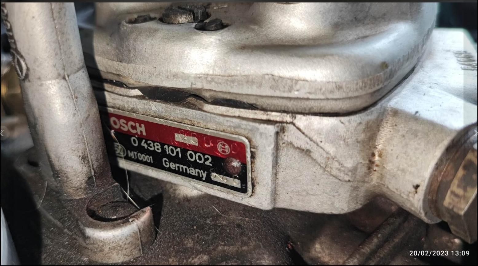

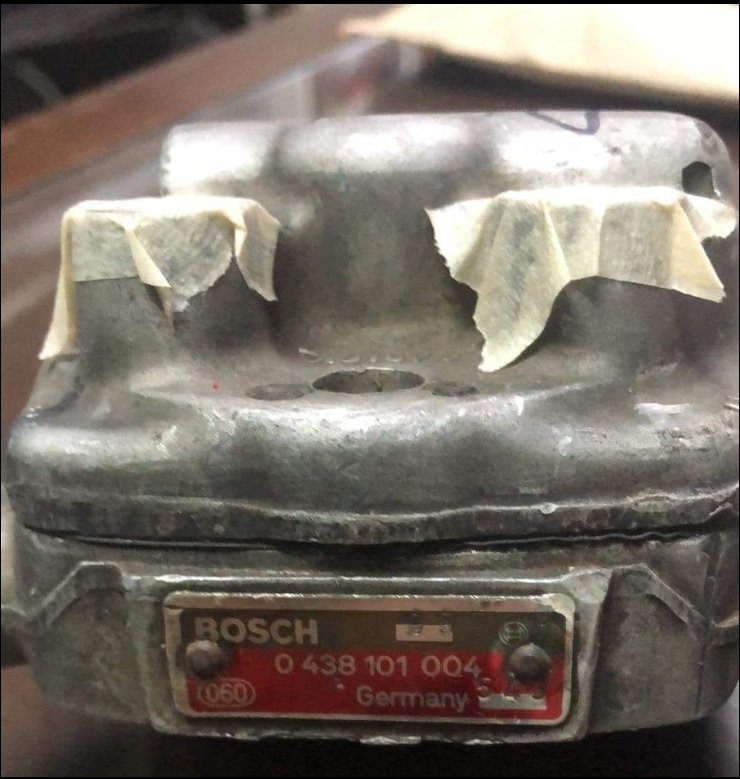

Is fuel distributor from 1986 W124 230E (0 438 101 004) compatible with 1985 W201 US version (0 438 101 002)?
Attached pictures from my car (0 438 101 002) and the one I saw online (0 438 101 004)
Thank you!
original installed part
will be used for replacement

I do not have a definitive answer for you and the fuel distributors should not be model dependent (as evident from the part number) as long as the engine displacement and #cylinders are the same.
However, they could be model year dependent. Most likely interchangeable but your first picture has an exposed adjustment screw that I have never seen as opposed to the tower opening that is most common and is most likely the way it is in the second picture.
I would want to make sure both use the same EHA port for lambda adjustment as the really early models could be different.

Thanks for the reply! I am not quite technical so apologies if I don't understand the "tower opening" you mentioned but I have attached the top-view pictures of what I have vs what I plan to replace it with - including the EHA valves (assuming it's the black thing connected in the fuel distributor itself). Let me know if it helped you in any way.
Have a nice day sir!
my own car - fuel distributor (0 438 101 002)
possible replacement option (0 438 101 004)

Photo's help a lot, the original photo was deceiving. From the outside they appear to be the same form factor. I suppose the 004 should work.
Not sure why all it's ports look to be sealed shut in a strange way.
I should ask, is this a known good FD? FD swaps are generally not done ***** nilly as they are a bit finicky and need adjustments etc.
Would it not be better to just have yours refurbished instead?
Or are you just trying to get a second FD that works in your car as a spare?
I ask because I have a spare but I have never swapped it in to see if it will work, as mine only has 50K miles in the car and is fine.

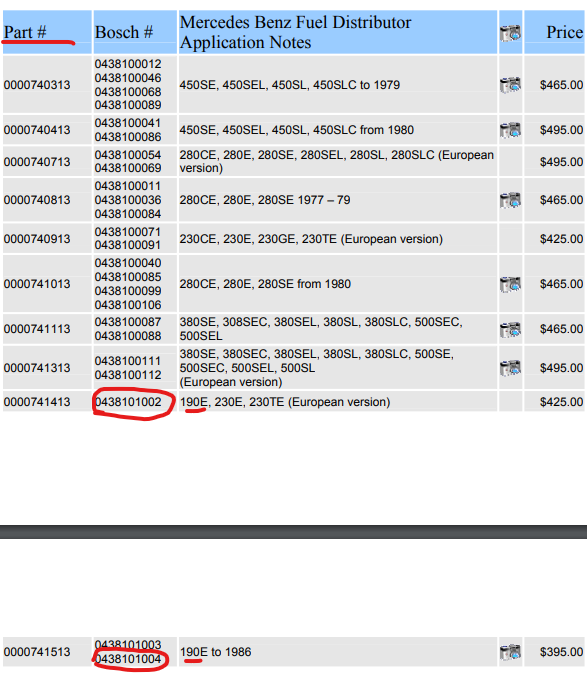

I also found this online, not sure why but they have a different price, but works in the same model.
fuel distributors from an online catalog
