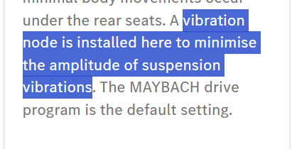

OP, you may consider having Maybach mode coded.

As for your choice to not try Maybach mode coding, I think I agree with you and I wouldn't do it now given your issues with the original baseline. In all cases, it's useless to some degree for the firmness of the drive. Without E-ABC, all it does is in the S is to adjust your car height (for a sedan it'd look goofy btw) by adjusting to higher level at lower speeds (just like you can do manually anyway at lower speeds). You S already adjusts the speed to -1 at higher speed even without Maybach mode. Maybach mode needs E-ABC to do real micro adjustments and anti-roll, wherein regular airmatic can't do micro-adjustments. In my GLS, as an SUV, elebest was able to unlock the actual suspension Maybach mode, cause the GLS airmatic has an extra module that the S doesn't have, that is shared with the Maybach, but it is still missing a lot of the E-ABC modules that Maybach cars utilize. Maybach cars also come with an additional node on top of the E-ABC components. For my GLS, the improvements were noticeable to me but not dramatic. When I compare it to newer GLS with E-ABC that I had driven, mine still sucks. However, when I compare it to newer models with the new software but no E-ABC, I like mine better, but I also liked it more even before the Maybach mode. Someone needs to figure out what's going on with these new software releases. I hate the new software so much that I can only like newer models with E-ABC. Luckily, my GLS didn't get the same newer software as facelift GLS, unlike your S which seems to have been updated to the newer software released around 2024. Once your suspension is actually fixed and back to normal, getting Maybach mode would be a nice add-on if you can take the look at low speeds for a sedan.
On top of the need for E-ABC to get all the benefits and the hardware needed, the actual Maybach vehicle comes with an additional node to better manage the suspension amplitude. WIthout it, the car is basically raised up and allows for a more floaty feeling, which can be better than a firm ride, but won't glide over road imperfections the same way as E-ABC and/or E-ABC in a Maybach.

As for what you were told above about Maybach mode in the W223, it is not correct, its more than just raising the suspension. It also controls damping such that side to side motions and rebound is considerably reduced, I'm amazed at the difference. I have been trying it out the last couple days and comparing it to Comfort mode and Comfort mode with the height raised and there is a distinct difference in the ride feel. It does raise up at low speeds which does look goofy, but the ride difference is there. Obviously its not eABC and won't behave like eABC...
It doesn't "ride softer" though, so I don't think it would solve your issue and I would get it sorted before I did any coding to make sure they don't try and blame that. Personally I think its a coincidence and is unrelated to your MBUX update...
