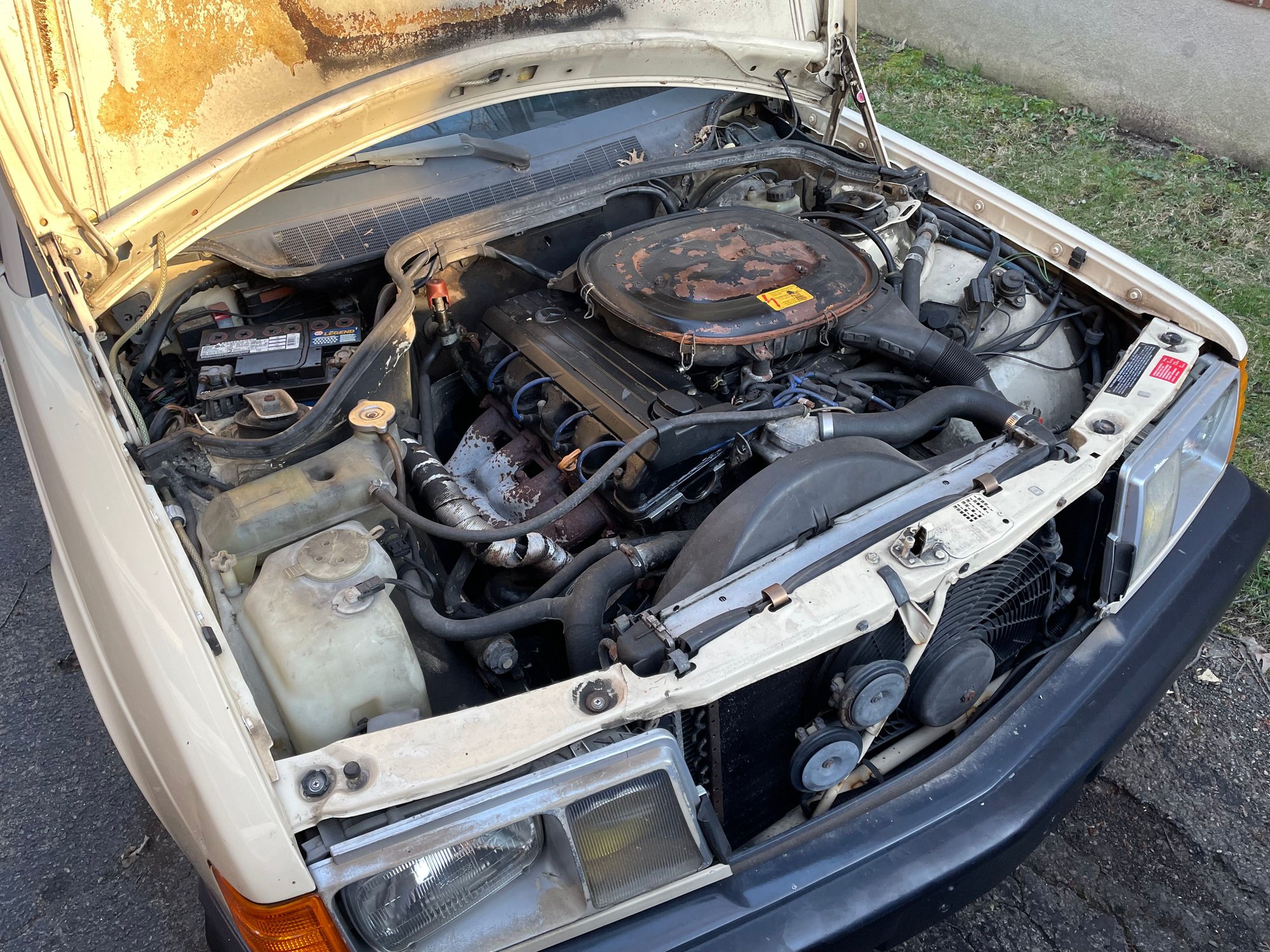

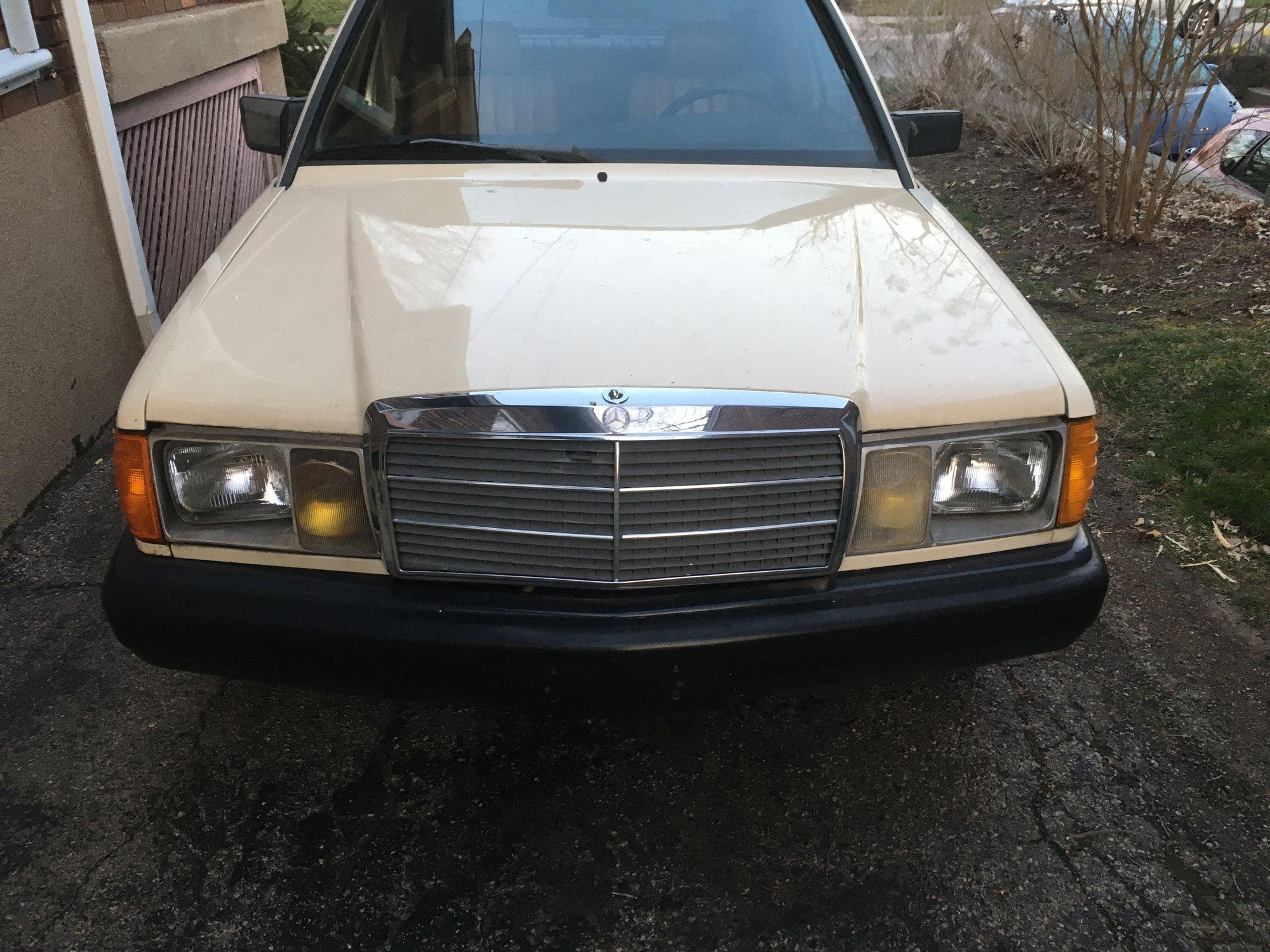

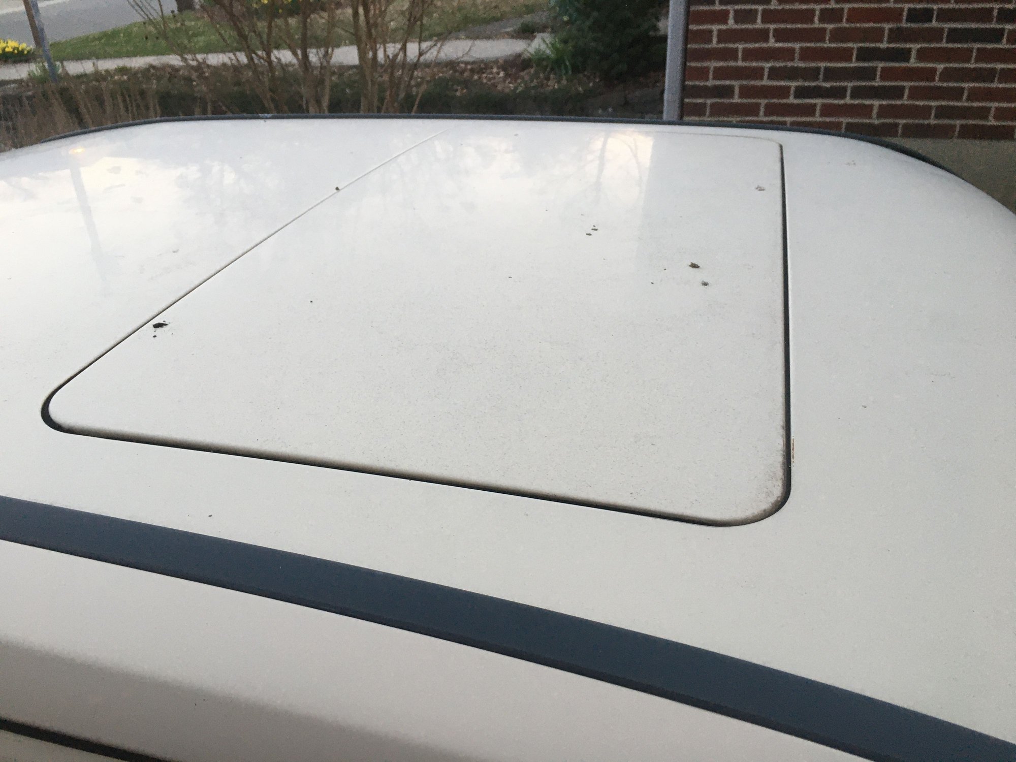

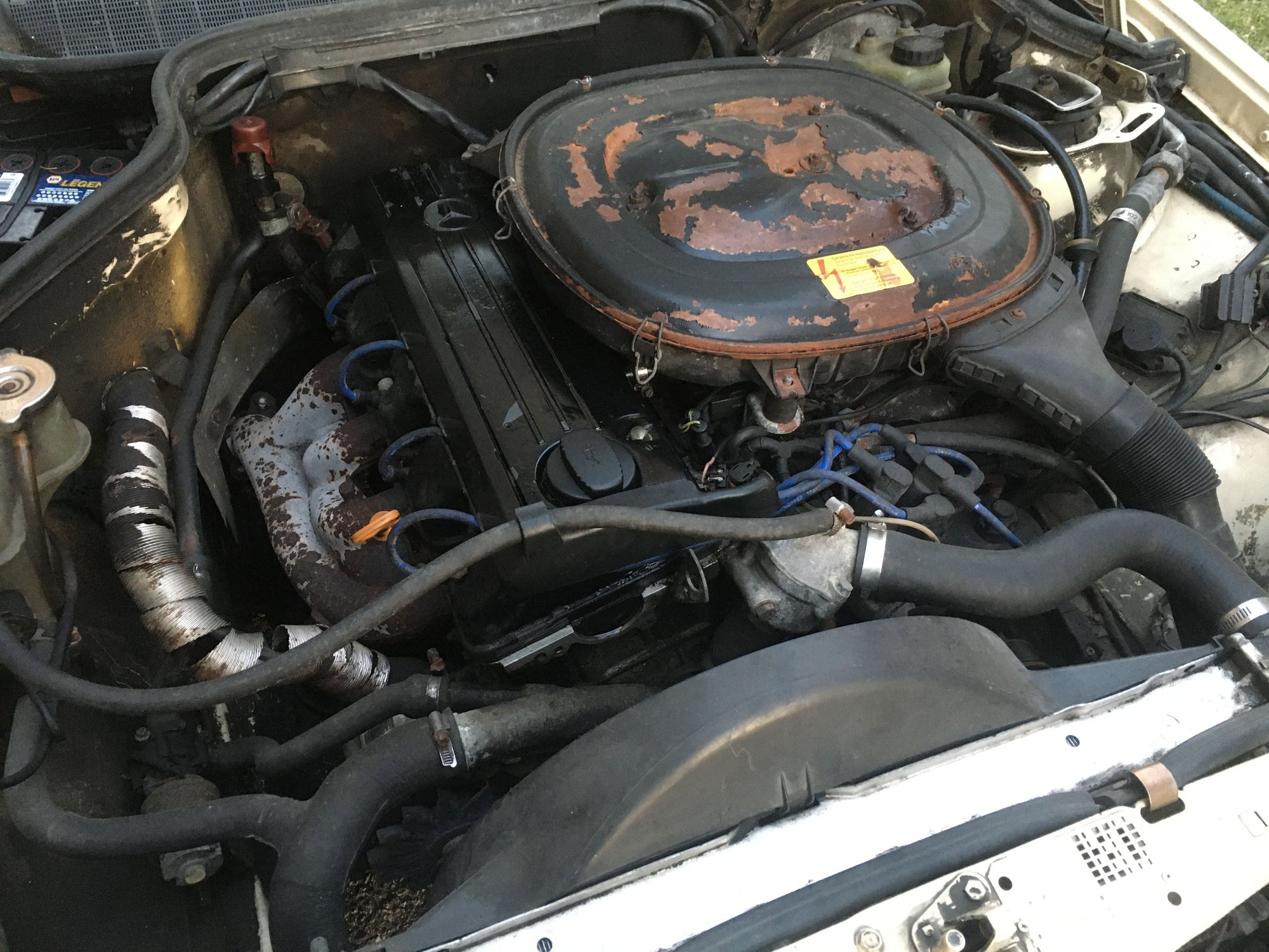

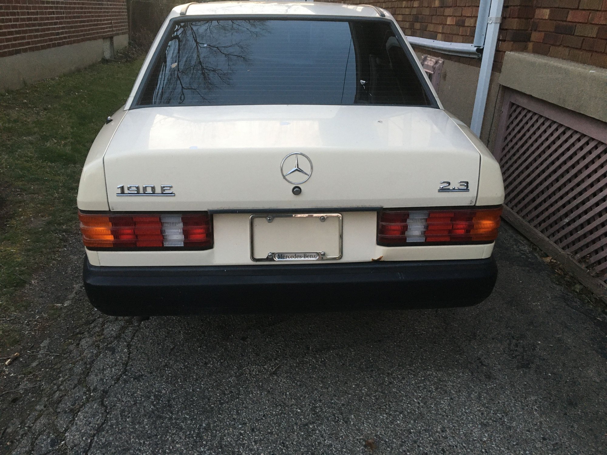

This particular car is in very good shape chassis wise and on the interior, paint is weak and there are a few rust spots from chips that were left untreated but nothing I'm actively worried about/scared to fix. I'm also going to be trying my hand at repairing said issues myself with the mentality of "it's already messed up" so I won't be scared to paint/sand/weld etc...
First step after it arrives at my shop will be pulling the entire interior out and really cleaning the car inside and out. I may pull the engine as well to clean the bay but it's running very well and I would rather not disturb the Jetronic system yet, I bought the car stupid cheap due to a transmission issue. I just so happen to know the cause of said issue so I'll be correcting that plus preemptively addressing the K1/2 seals and spring and getting both the governor and modulator cleaned, adjusted, and all setup correctly.
Currently the trans has all gears at the correct speeds for both up/downshifts and responds to kick down and manual gear requests but engages over-harsh. This implies that the modulator is out of adjustment or that the vac accumulator has weak seal/line issue and is allowing leakage resulting too harsh of a pressure curve. The important part is the gears are all there and aren't slipping or engaging at incorrect times/flaring. It just a matter of adjusting it so feels seamless again, I'm not too worried plus it came with a spare 722.4 in the trunk so I have literally everything needed.
Almost every secondary system works, the only issues are the drivers window motor appears to have no power (might be as simple as the switch, might be as bad as needing a new motor) and the vacuum powered central locking either doesn't work or I am a dumbass and it doesn't have it. Still not sure on that but I'll know when I have the door panels off.
Here are pictures of the car at the old owners house, I'll be retrieving it Wednesday

Welcome to the forum and congratulations on the purchase.
I would start with dressing the hood with the hood pad before too long.
This is an analog car (mostly) but there is really very little adjustment needed or desired for emissions/idle. Just keep that in mind.
It is best to measure things before taking any action, and generally the action is to replace malfunctioning part after proper diagnosis.
An sometimes the diagnosis can get tricky.
The exception to this is probably the modulator you mentioned for the auto transmission.

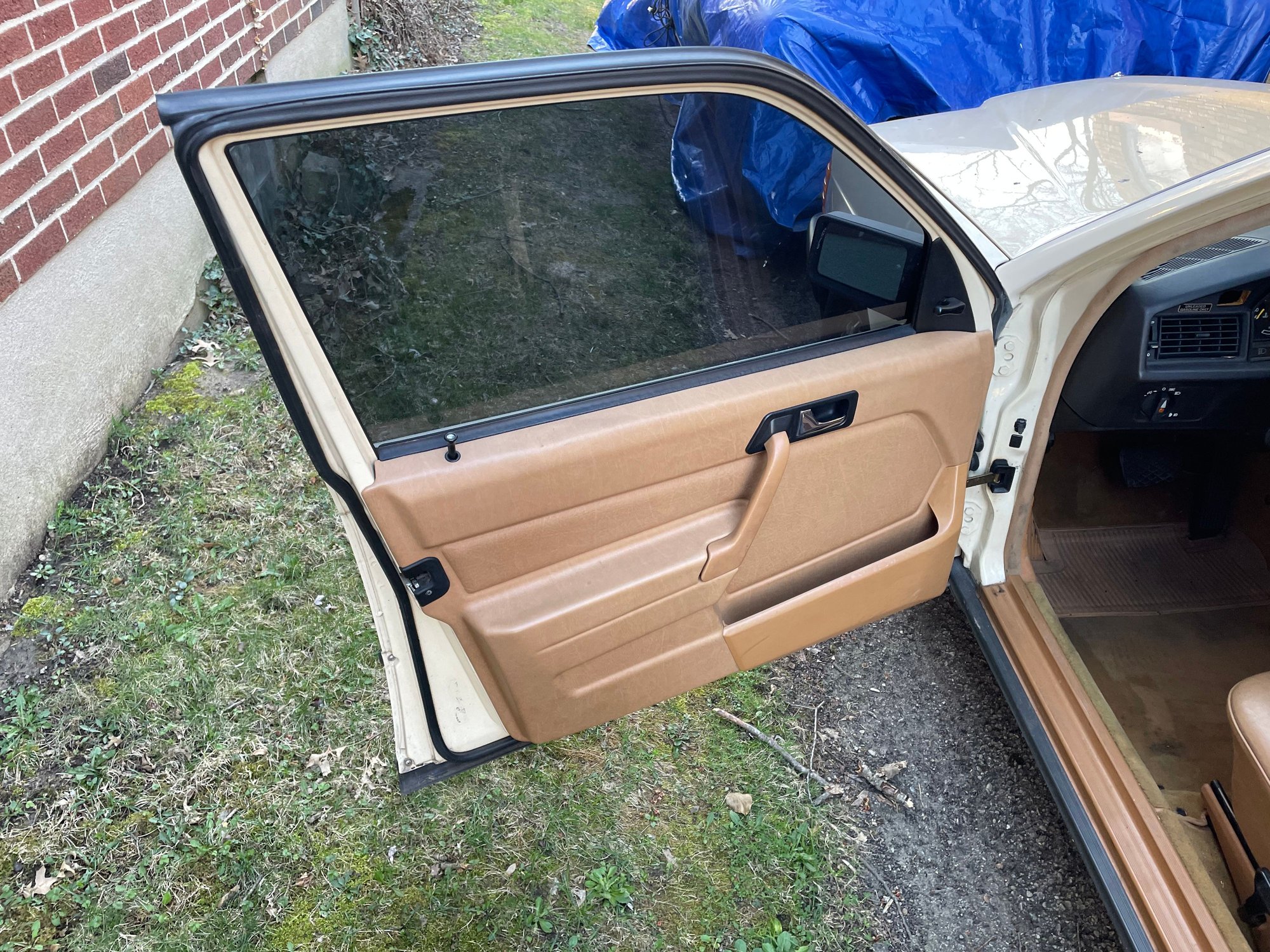

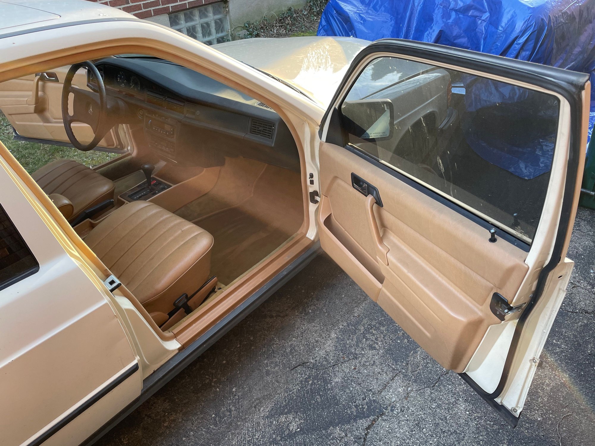

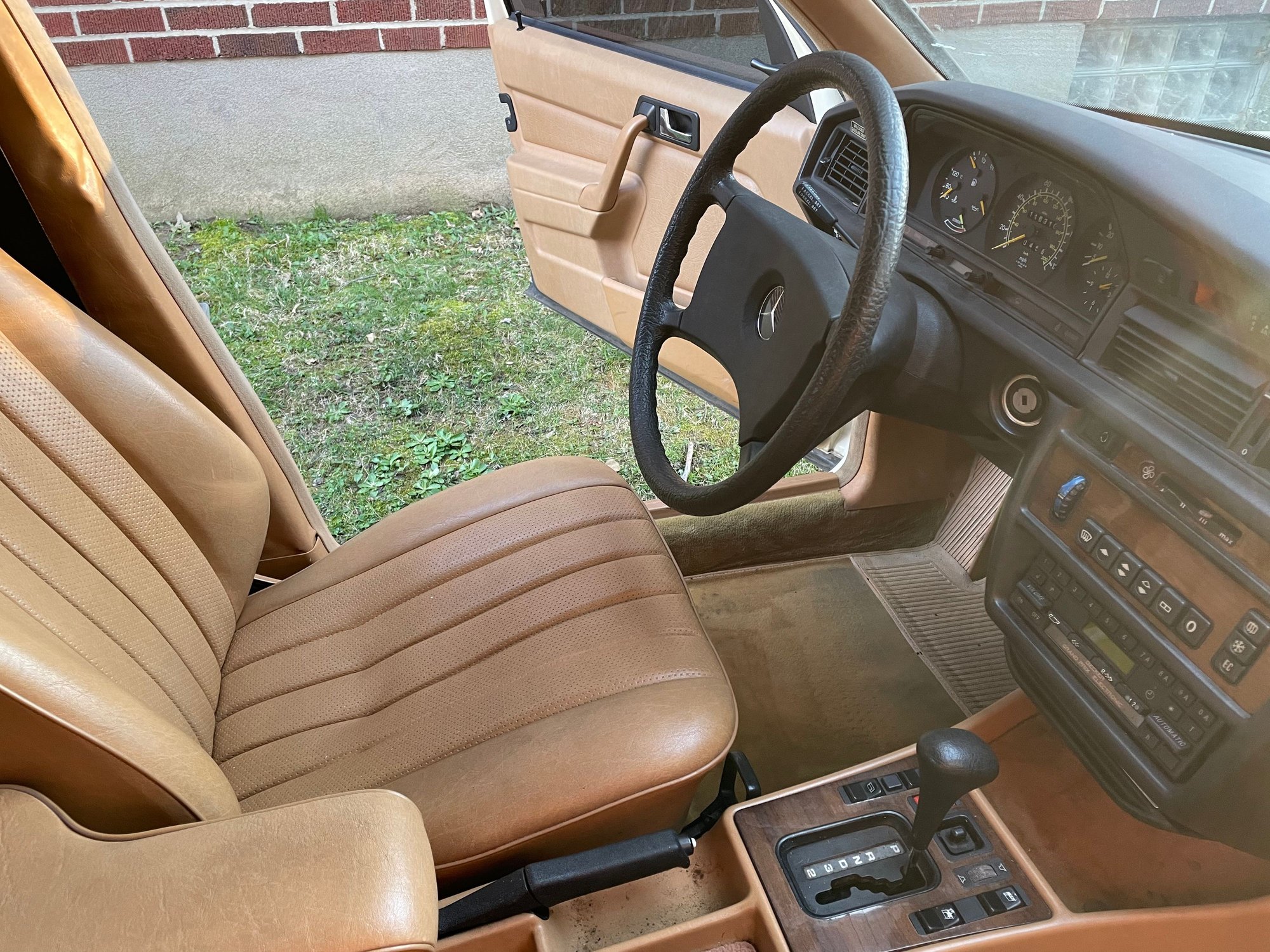

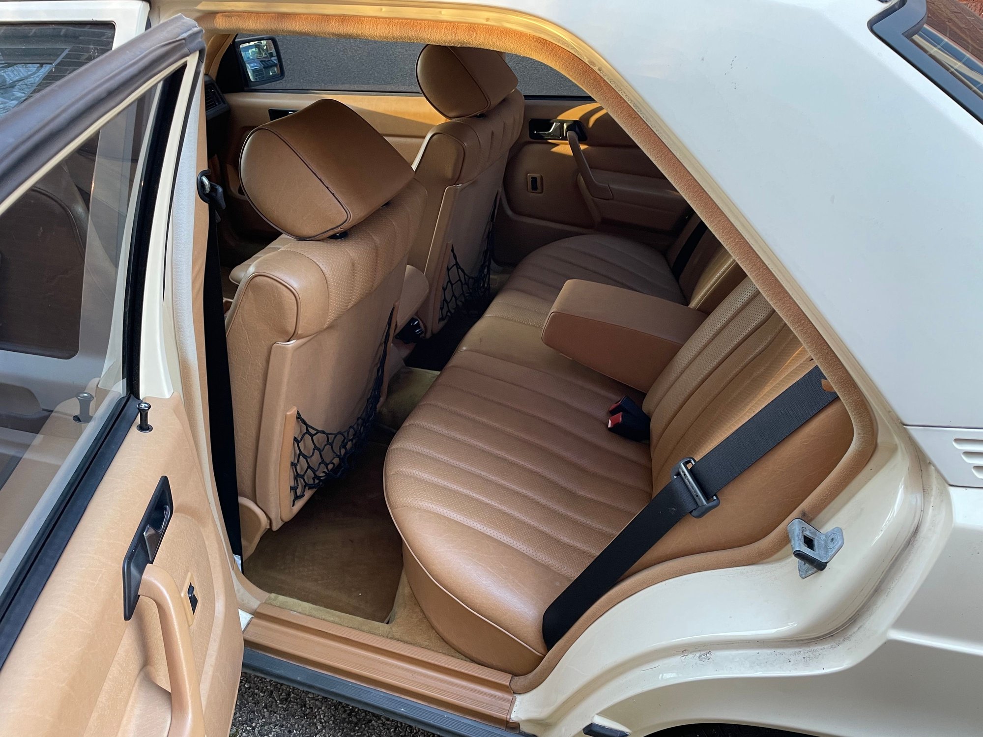

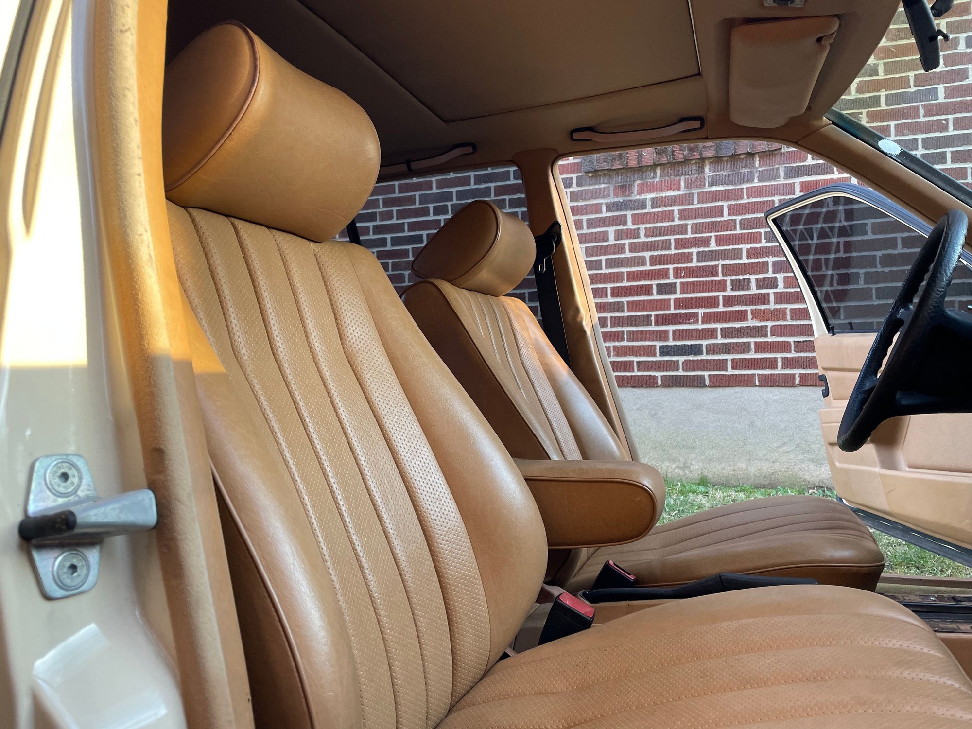

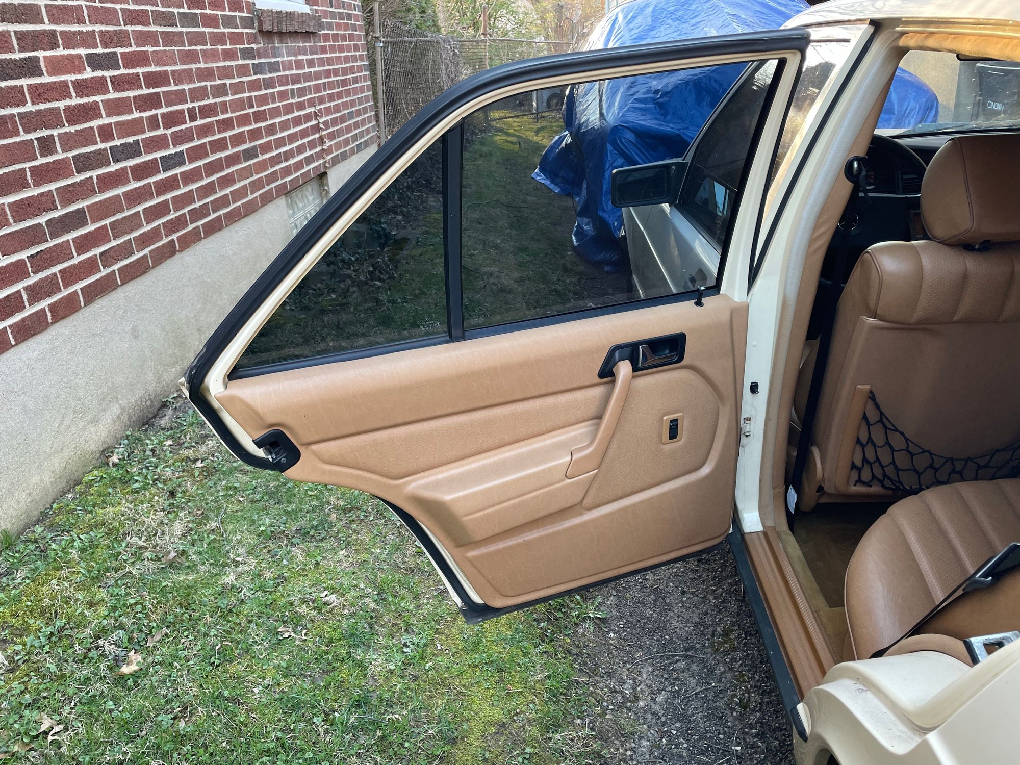

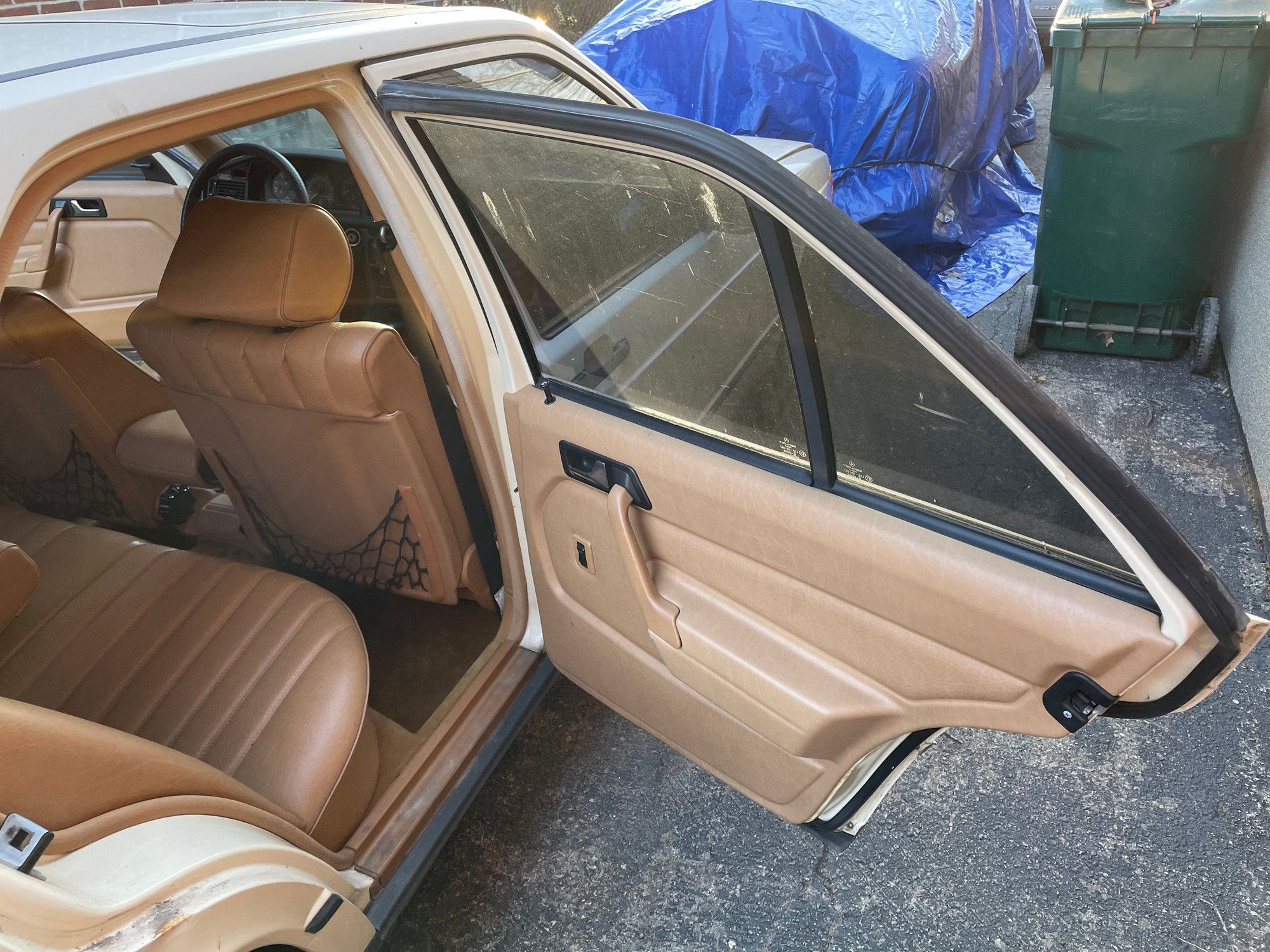

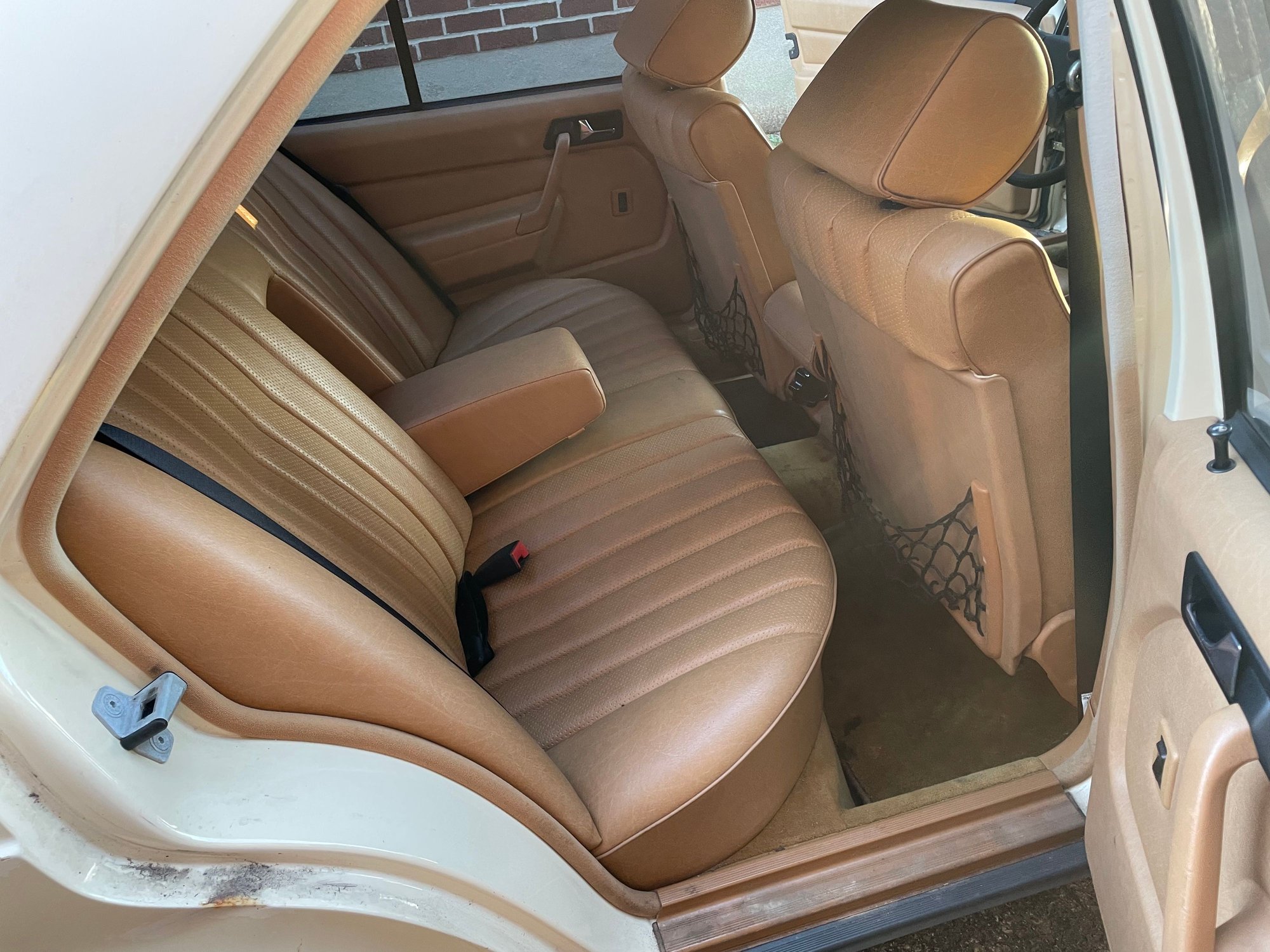

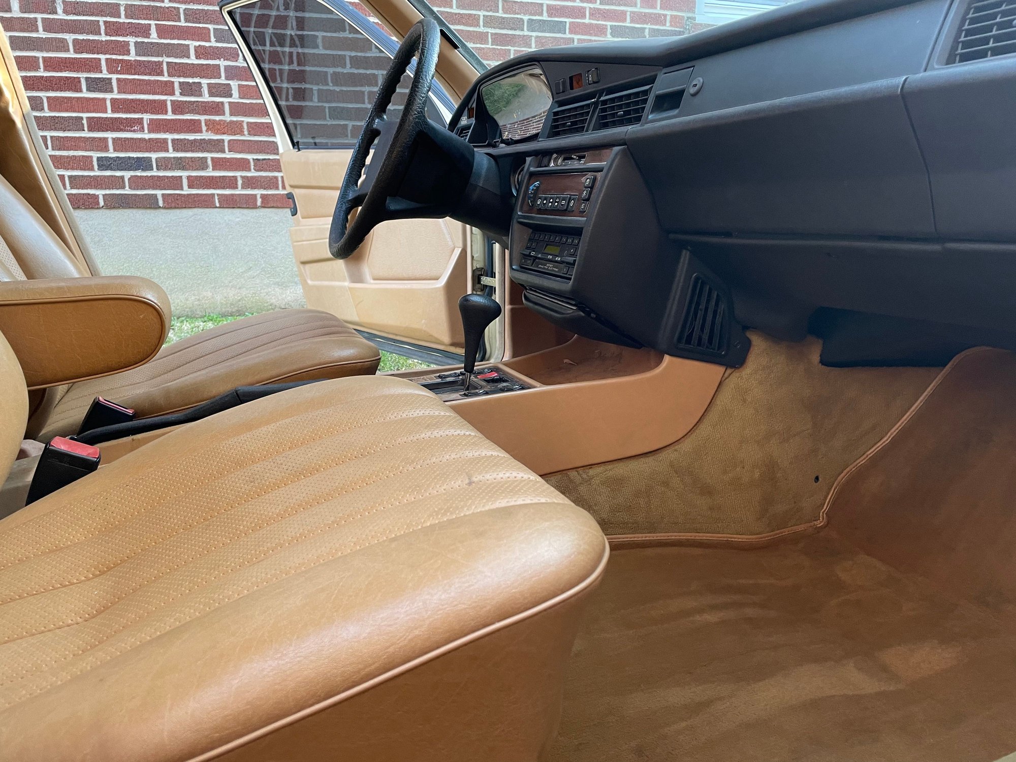

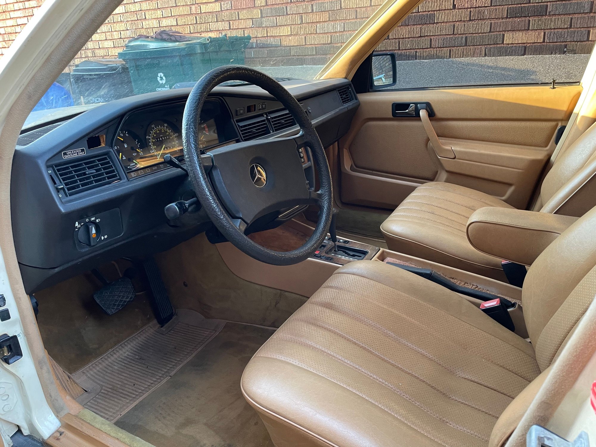

The dome light and sunroof switches are still there just pushed though the dash, I'll be seeing about printing sleeves for them to sit properly
Here are interior pictures, I'm very pleased it has the original radio/interior. Condition is not bad but I'm hoping once I pull everything out and clean it up it will be better.
Only things that aren't working appear to be easy fixes, the HVAC controls may be swapped over to euro type pending discovery of the source of the problem with these. I suspect the main vac line is leaking or one of control lines is dead since it doesn't switch zones.

The interior indeed looks in fine shape and a nice color combo. I have the same interior, it lasts well except the palomino plastics. I'll repeat 190EFan's commentary on chip marks. DR colorchip is your friend. After 30 years of usage I repaired nearly 200 chips/nicks/eggshell chips etc with that. Works great and if you give them the year and color code the match is perfect.
They even know the difference between a '89 Signal red and a '90 Signal red. Slightly different tone.

For a 38 year old car, I think it's in remarkably good shape. What's the mileage? I strongly advise you to heed Dolucassi's advise on making any kind of adjustment's for emissions or to the idle. MB pretty much designed these to be non-adjustable. Be sure to measure any values before you even think of doing an kind of adjustments. Adjustments of any kind might well get you into all kinds of trouble and keep the car from running properly. Keep us posted on your progress.
