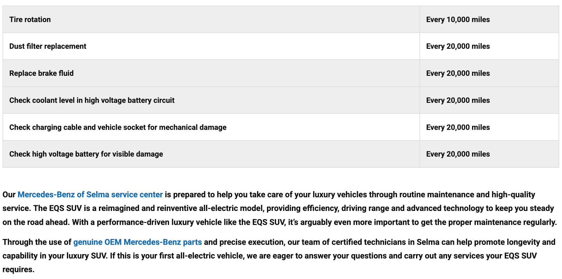

Many dealers have a similar page, but this is the first one that came up in Google. Of course, they left out the "2 years or 20,000 miles, whichever comes first" part.
https://www.mbofselma.com/mercedes-b...ice-intervals/

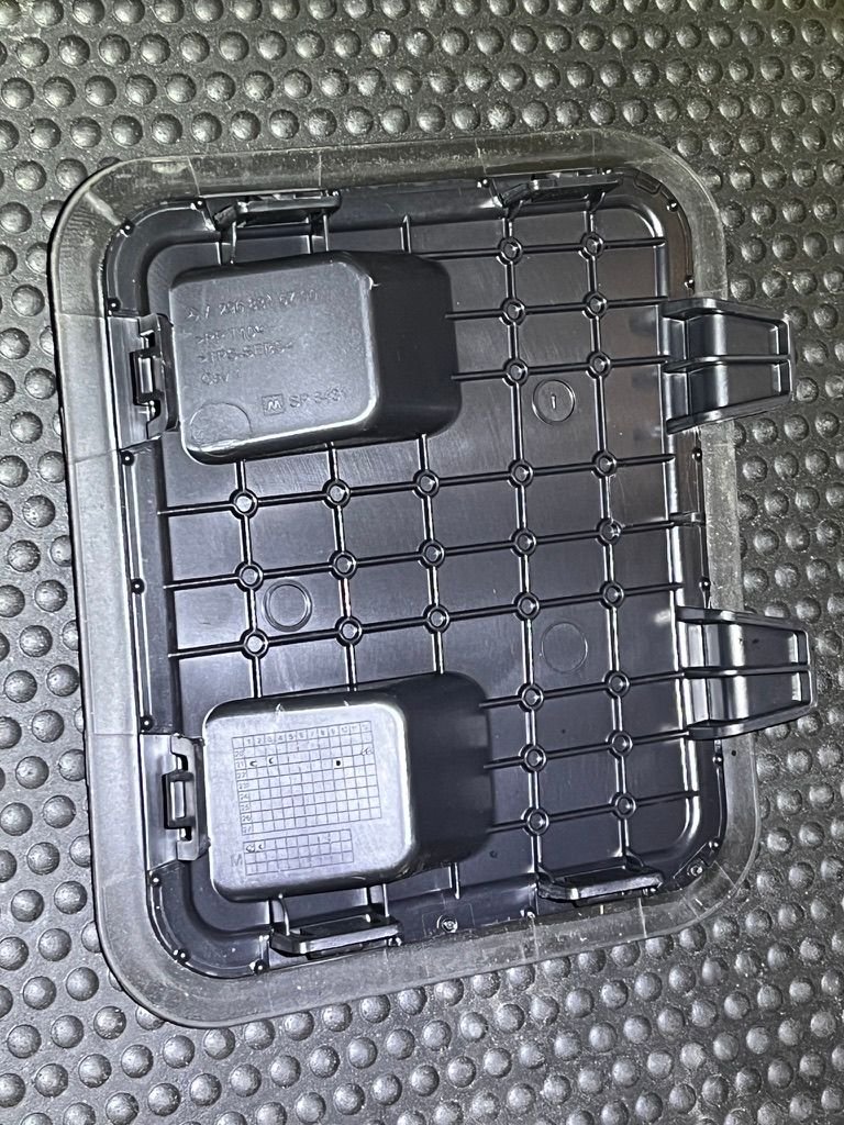

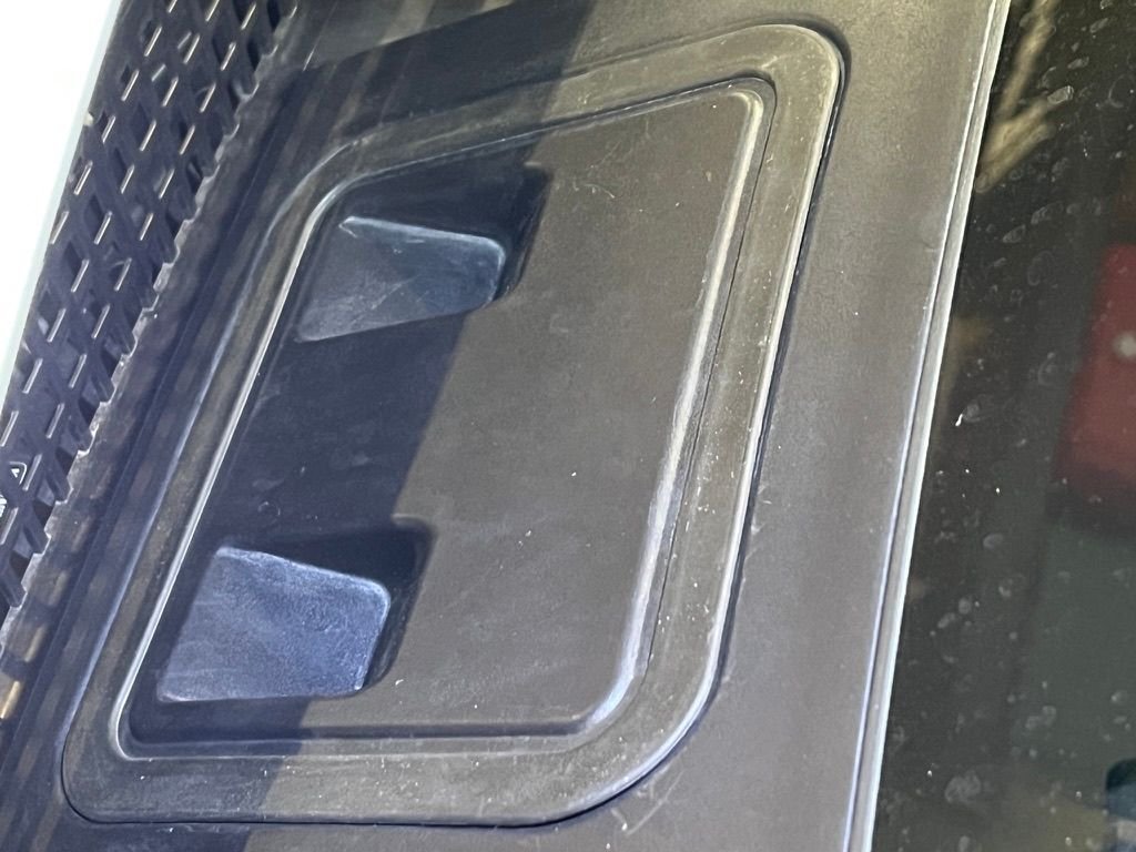

@LAZARU5 , I asked this on a different thread, but I think it fell down the thread list...how do you get up the hatch to get at the brake fluid? It feels like prying will result in a broken tab, but I see no other way in without removing a lot of cladding.
Old Oct 6, 2025 | 08:55 AM
LAZARU5's Avatar
Joined: May 2005
Posts: 1,440
Likes: 541
From: Philadelphia, PA (USA)
2025 E53 Hybrid
It's not necessary to remove any cladding around the cowl or windshield. Lift the lower edge first then shift the cover forward to disengage the tabs along the top edge. It's probably easier to do this with the hood open.
Top side of EQS SUV brake fluid reservoir cover.
Bottom side of cover showing tabs on rear edge.
