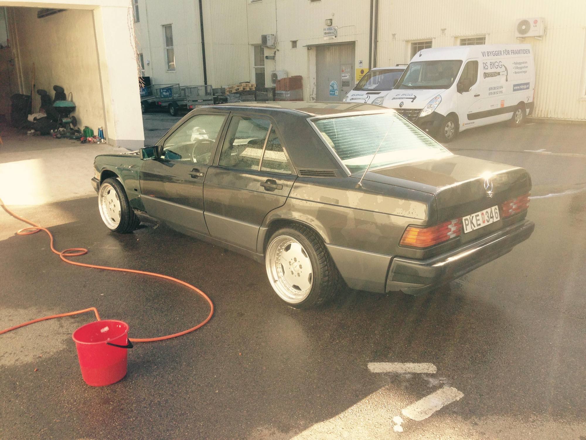

At the moment I only have a bad picture from previous owner
Engine not in the car at the moment and is in pieces
But yes its a m103 3,2 amg engine with all amg goodies 😉
Car has been sitting in a garage for the last 10years or so
Amg aero wheels werent included thou
Front left fender needs respray since its changed (old one had rust)
No engine/trans in the car in this picture

Good question Dolucassi. I probably read about it but that was likely years ago and I don't remember what the answer might be. M-g, I think the picture is pretty good. Given the age of your car, I would also advise you to renew all of the rubber as in hoses, bushings and the main poly-v belt because rubber cracks, deteriorates and doesn't last forever. I would further advise that you change all of the fluids, oil, coolant, transmission, power steering, and differential. Be sure to only use MB coolant for the cooling system. Non-MB coolants can damage the plastic interior of your car's radiator. Radiators are now NLA so preservation is a must. There is a company in Germany, Kienle that can now refurbish vintage MB radiators if you need to do that. Don't hesitate to ask if you have any more questions. I'm looking forward to following your progress. This is a rare version of 190 so its restoration is important.

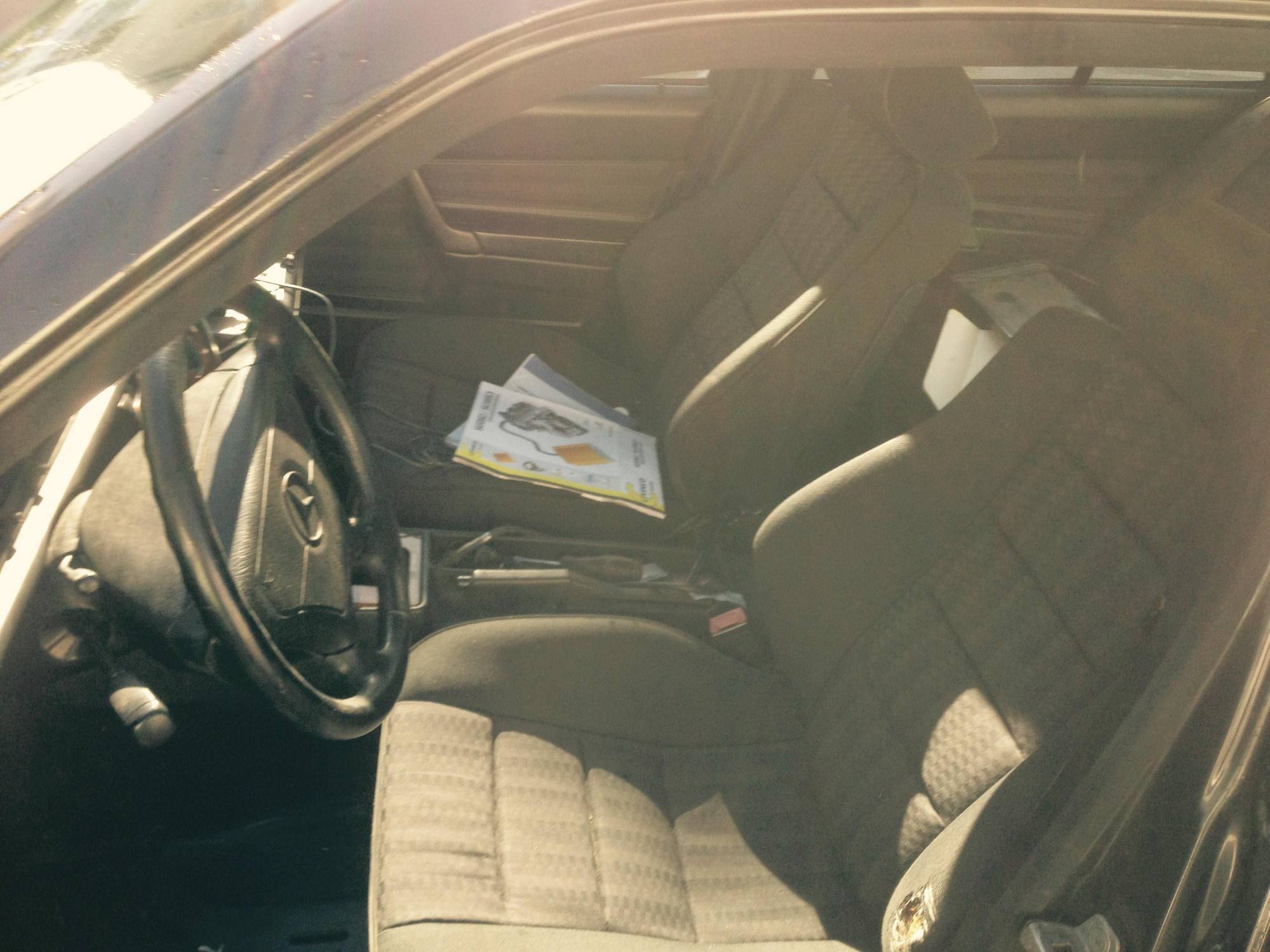

The car is in quite good condition paintwise,just some cleaning and polishing and paint the left front fender.
Interior is quite nice also,drivers seat have some wear on the bolster that needs to be fixed.
Not sure if its possible to get new fabric like the original
but ill look into it
Only have this picture of the interior
