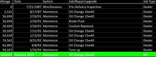

This is a quick shot of my log and cars early life, it was shipped to NJ then sent to a FL MB dealer that used 10w40 and looks like they increased the weight to 15w40 when it came to Ohio at 59k miles
when I took ownership I initially put the Mobil 1 10w40 but I recall why I switched to heavier now…because I saw it in the old booklet. I think that weight mostly comes as a diesel oil but that’s where I got the idea anyways

Quote: This is a quick shot of my log and cars early life, it was shipped to NJ then sent to a FL MB dealer that used 10w40 and looks like they increased the weight to 15w40 when it came to Ohio at 59k miles
